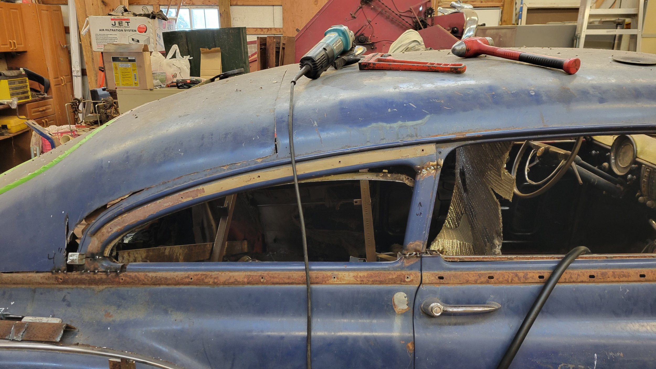

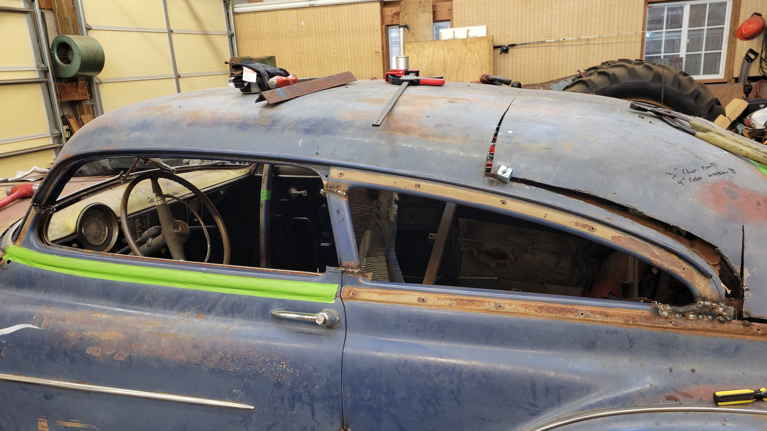

    well, harvest is over, so Im done with farming for a bit. So now the 49 is finally getting the attention she deserves. I have started welding the pillars back in the car, and have started patching the roof. I picked up an English Wheel from Northern Tool and started forming the patch panels to fill in where I cut the roof back in July. There is a ton of work left to do, including fixing a mistake in the roof at the top, which I have a plan on how to fix by shrinking the steel in that area. I'm hoping to be able to get a lot of the work on the roof done in the coming weeks. In the mean time, here are some pictures for your enjoyment.
