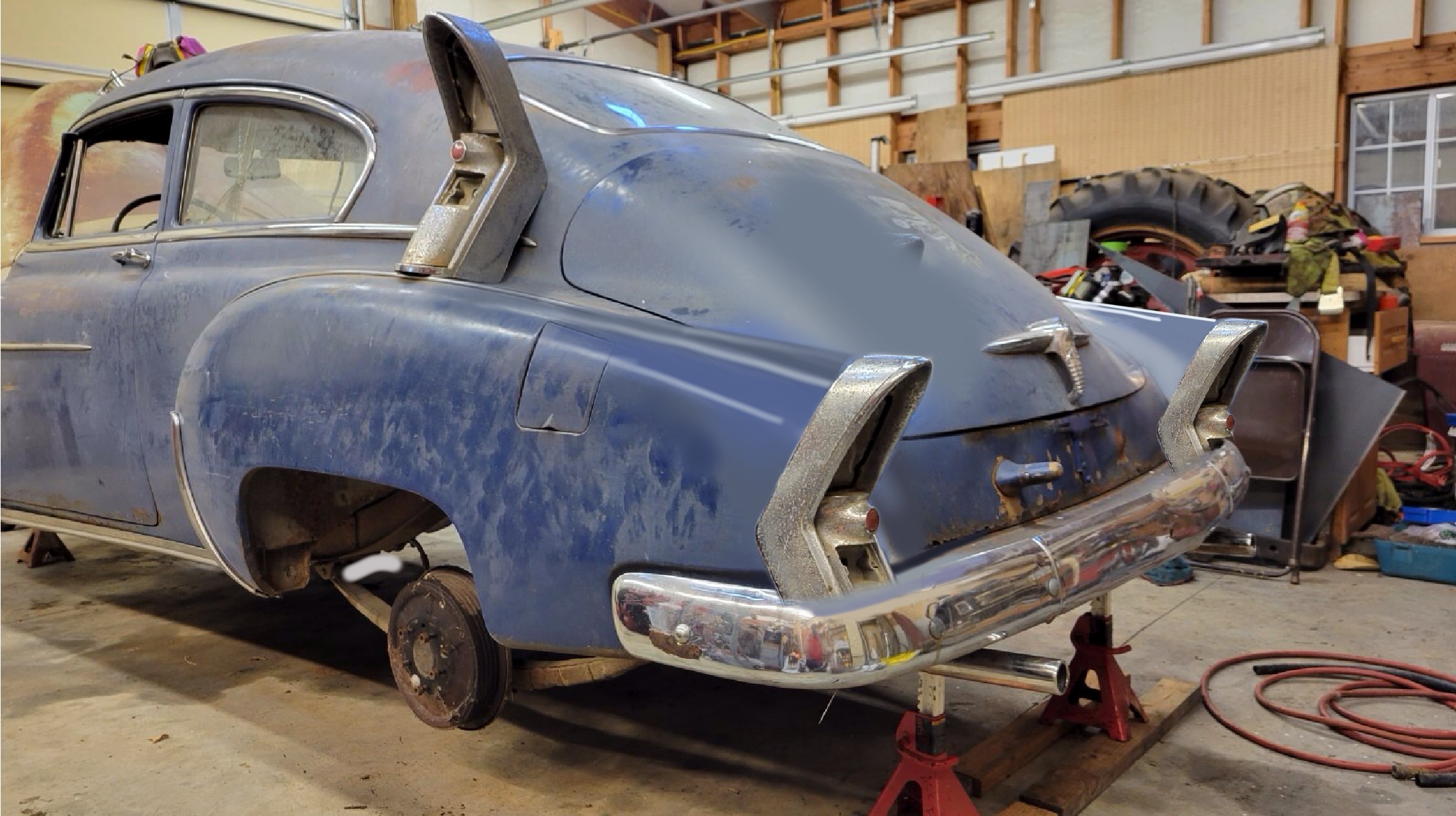

    I think the '56 Buick taillights would add too much m*** to the rearend of your Fleetline and destroy the streamlined look...choose a smaller taillight...

    WOW, what a project, great work so far!! Those taillights look so tall sitting on the back of you vehicle, but each to their own. I wonder how you are going to blend them in so they don't look like a stick on. Keep up the good work.

    I had considered them when I first started this adventure. While I like the look, I like the buick lights too. I suppose if the buick fins don't work, I could always go the packard route.

    I have a 51 Fleetline I'm getting ready to start a build thread on, and I love what you're doing. As for the taillights, it's your car and you need to make it yours. I think your vision has potential and I can't wait to see it. I'm taking notes, keep going

    There’s a lot of ways you could use those tail lights even though yeah they are big. Either way I’m Excited to see your back on it!

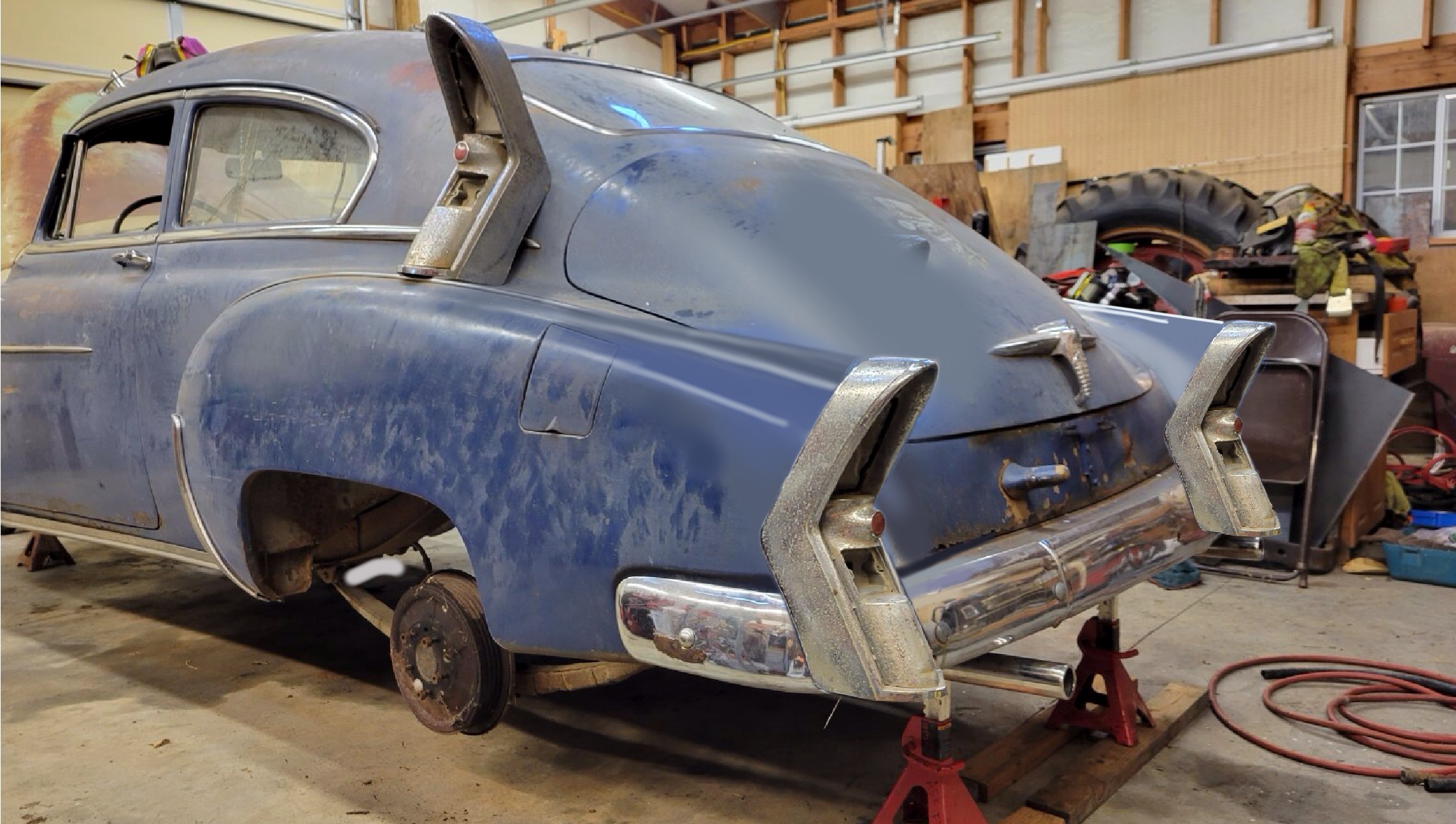

    I like the mock up with the bottoms trimmed off

    Thank you Tim! That's what I have pictured in my mind, hopefully I can make it turn out looking good! I think with the chop and those tail fins, she's going to look fast sitting still.

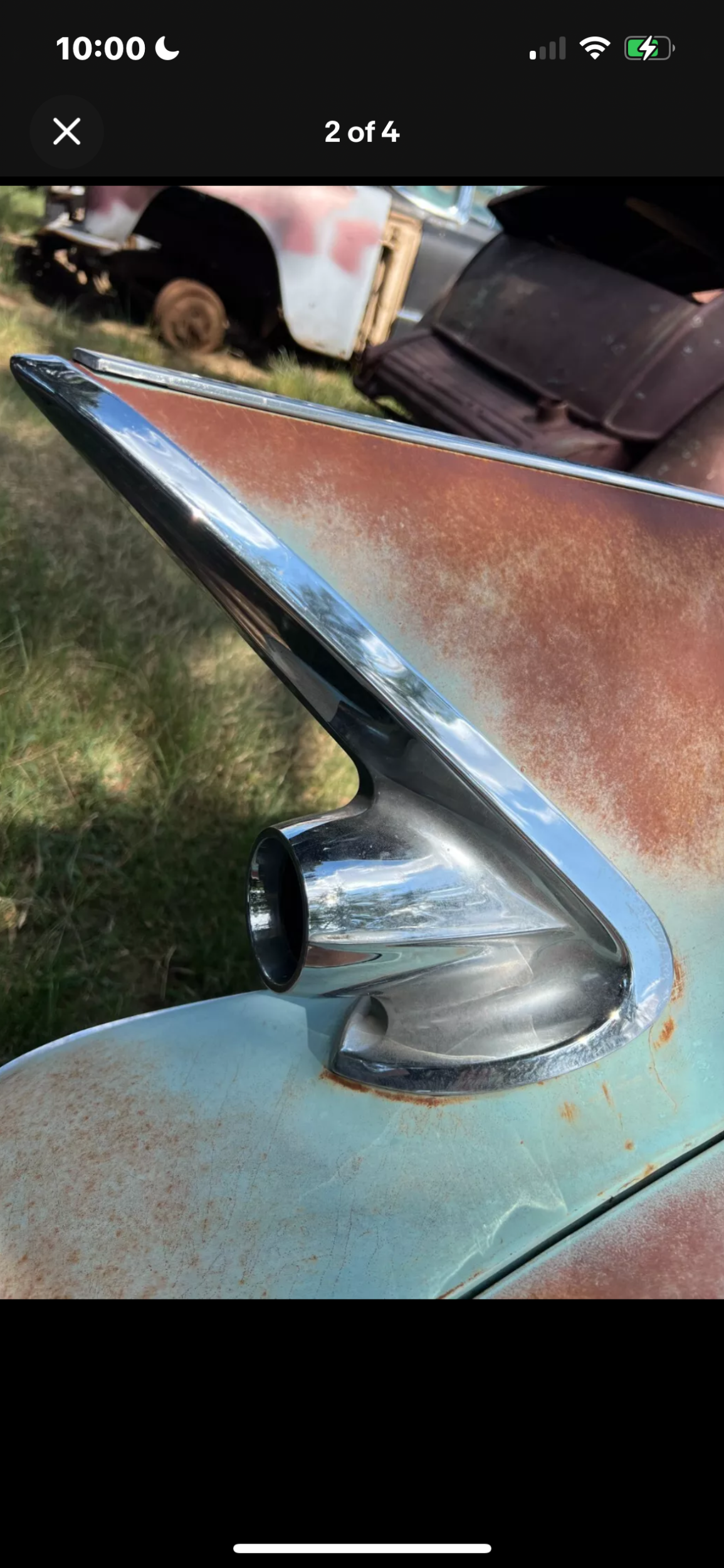

  10. Just came across this on FB. Looks fairly natural to me FB_IMG_1736550960731.jpg

    They are natural on 53 and 54. The trunk lid helps with proportions.

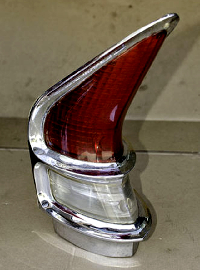

  22. Packard tails but id imagine a similar finished look. On a 51 that was built between 1959 and 1963. Figured it'd be relevant FB_IMG_1769490290205.jpg

    ^ that’s got a real Cadillac styling vibe going!

    I definitely saw what others were saying about the taillights being too high in that first "set them on there and look" picture. I also thought dropping them down behind the bumper or cutting off the bottom portion would fit way better. Of course im late to the party as usual it seems you got there on your own with via Tim with the rendering and now this mockup I can really see it taking shape.
