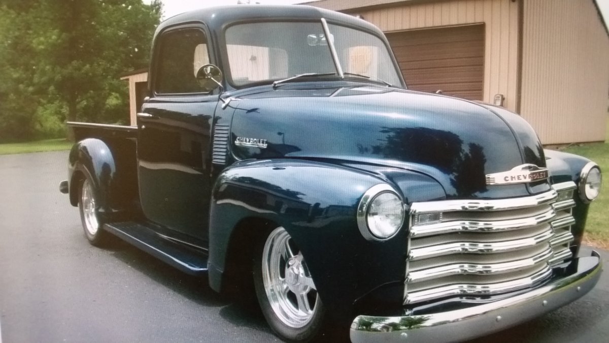

    Nothing wrong with an S10 frame other than not being traditional for the hardcore guys. I prefer a stock frame but suspension mods cost about $2500 or better.
    Standard longbed is 118" and works well using a Code 504 bracket kit. About $1250.
    I've done several of these on $300 S10 frames making my own brackets but the kit makes it easy. I'm not affiliated in any way with the company. Just happy somebody did the engineering.
