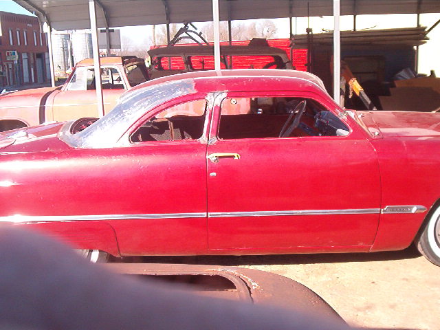

    Hope you dont mind me postin' pics of your shoebox coupe as it is "lowering itself" down here in Missouri!:D
    Here are a few hilites and an update as of today.....
    I have it cut/welded /ground down/ as per your instruction-3" frt and 4" rear-
    THEN I relieved the top skin and raised the front of rear glass back... UP 1-1/2" to improve the radius /Flow of roof skin into deck and Tulip panels.....
    I see a lot of these cars overchopped and I constantnly hear how ya :) cant chop a 40 50 coupe..But anyways-here it is for the folks to take a peek ... they'll tell us if we FUCKED IT UP!:rolleyes:
    I generally try to share a little tech here on the HAMB although it seems lately all we hear about is where to meet the buddies to head to GOODGUYs in a billet starved caravan....:D
    I thought there may be a few who care -who can glean something from our pics of your chop....

    if the back window follows the body line and doesnt bubble out like i think it might, that will be the best coupe chop ive ever seen that wasnt hardtopped

    Wow.
    I love that chop.
    I usually prefer the coupes to be hardtopped, but I will DEFINITELY make an exception for that one. The slightly tilted b-pillars give it a very "period" appearance. The hard work on the back glass really paid off. Great work...

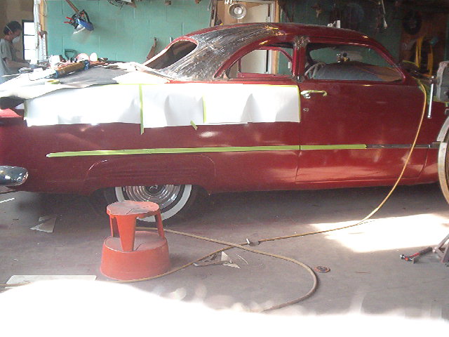

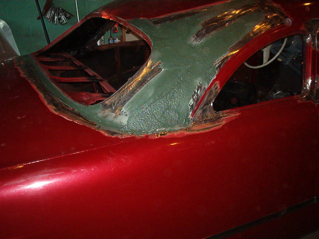

  8. My pics didnt upload in the right order!Ha... here are a couple more..... and a skim of stranded glass to finish the cuts/welds off....Im getting closer AL....:D

    That is the way Henry should have built the car!

    I'm speechless! Thanks Kenny for the post and for the chop! Here's a before pic. Everything you hear 'bout Kenny is true. Good fella, nice work, good prices![​IMG]

    I know what you mean....there is always a line that if crossed- the pendulum swings the other way....
    I think if overchopped or if the rear glass is leaned too steep resulting in conflicting angles- it ruins any chop...It is supposed to IMPROVE it's looks,right?
    I catch myself at this imaginary"line" on my own stuff [sometimes], but on a customers car you must do what the job is- and abide by the ideas and tastes of him [the owner and you combined]:) ...with AL he was on the right page here -all I had to do was perform the task.
    I will say this- if you notice -I did not add any length to the roof skin....not below the glass NOR above....[A coupe 49 or 50 cant benefit from that.]
    It actually stays connected ...all the total length/width ABOVE the rear glass/and is not even cut apart in the middle.
    It also is -not- "notched" at the top or bottom of the windshield posts either.....this is just a matter of planning and execution as opposed to rushing in with a saw and regrettin' it later.....
    [dont ask how I know that]:D

    I always use the stranded filler as a skim over the welds....it will save you if you have a thin area -say when grinding the welds flush.....It can stand vibration and is waterproof as well...it is not thick....I typically use a quart of filler total on a top like this....[before sanding....
    I see a lot of :D all-metal finishers here on the HAMB....most do not chop any rounded tops....Ha!
