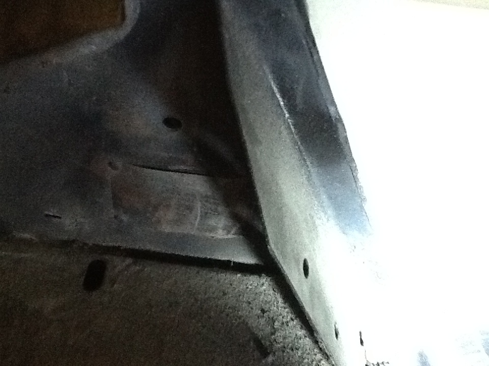

    Also I looked in the doors and on passenger side of firewall/cowl. Nothing there. I can see where a plate was but not there anymore... I am lost on what to do and also still confused. I have some people telling me there is no VIN plate and that is a serial number plate only (9 digits). The VIN number on my title is not the same as the serial number on the chassis/driver side firewall (which is stamped straight into the firewall). From what I was told is that the VIN is on the original engine only and then the rest of the numbers are the serial numbers which are different than the VIN shown on my title.
    Is this true and can anyone confirm that their plate number is different than the VIN number on the title?
    Sorry for all of the questions here, I am just trying to get this squared away ASAP!

    I would be willing to bet that your title contains the body serial number that was removed from the firewall when the car was painted.
    You can "fix' this anyway you like, but I would just replace the damn tag.
