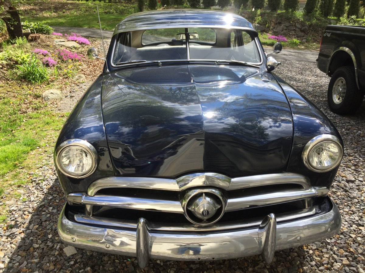

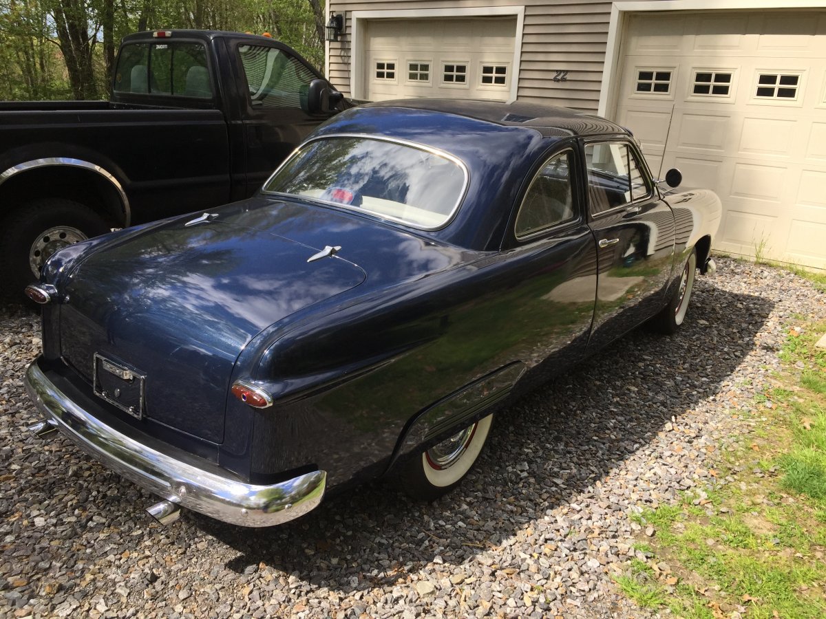

    New ride.

    Great looking car -- have fun and be safe
    LSJUNIPER likes this.
  7. Great looking car. I like the understated visor ... a lot.

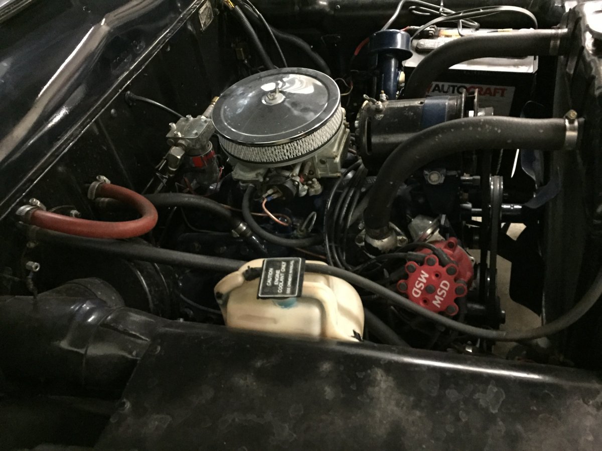

    11111111111111111111111111111111.jpg 4E27C620-BFDC-45F0-95E0-C523BB2DD639.jpeg DBA13A2B-D1BA-4337-B2CB-378DF19352F8.jpeg View attachment 5062421 D127E6BF-05F1-421D-931F-1716F54CCBE1.jpeg It has Mercury heads but I don’t think it’s a Merc motor. Holly carb , electric fuel pump, MSD distributor. One day I will put some Stromberg carbs on it, for now I’m going to enjoy it.

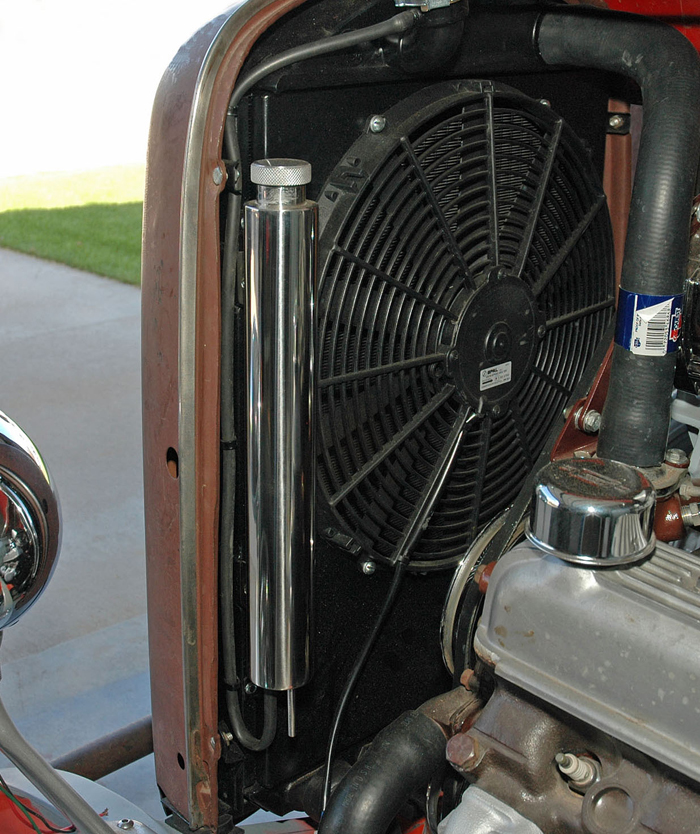

    The only thing I would do is ditch the puke bucket for a puke can. It'll really clean up that engine bay, cheap. This ain't my car, but this is the same puke can I got.

    Thanks, I was thinking of ditching it for a better one... You answered that question. Where can I find that "puke can"?

    All over. There's one at Speedway for like $40, but I can't speak to the quality. Just Google it and you'll find plenty of options. I can photograph mine tonight after work if you want to see how it is under the hood....

    In order to determine if its a mercury, you nee to remove the oil pan to inspect the counter weight or if a cyl head is off , measure the stroke . Nice no matter .

    You said "Holley carb". Both Ford's and Merc's had Holley's. The important thing is whether it has a 3 bolt carb (Ford) or a 4 bolt carb (Merc). If it has both Mercury heads and a Mercury carb, there is a little better chance that the engine is a Mercury. Most people know that putting Mercury heads on a Ford is a bad idea, since you lose compression because of the larger combustion chamber volume.

    Thank you sir. I am going to do the same. What length is it?

    I believe it's 15 inches, give or take, they make 15,16,17, and a bunch of smaller ones starting at 9 I think?

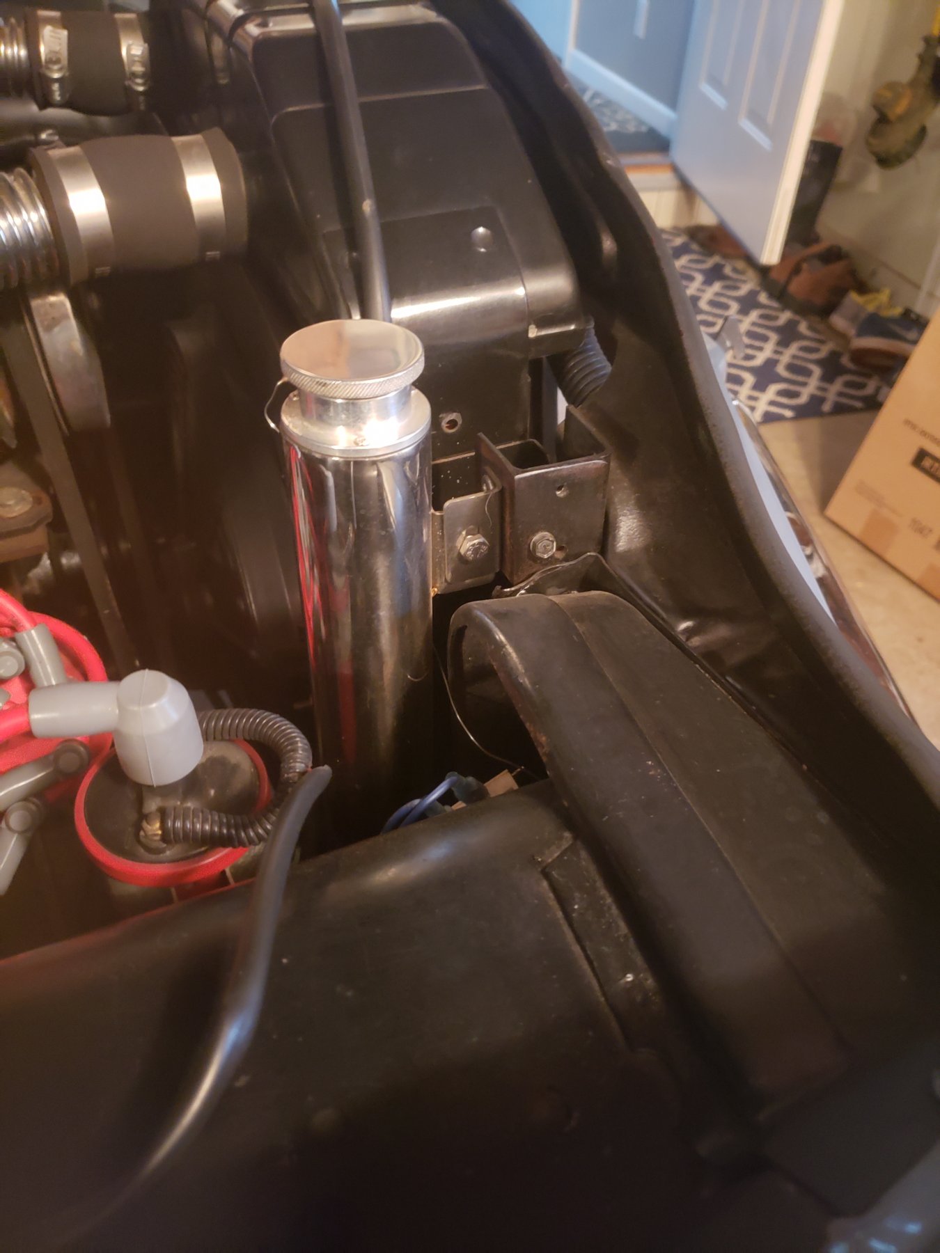

    New over flow / puke tank is in. Got to run the line and I’m going to remove the brackets I made for it and paint them.

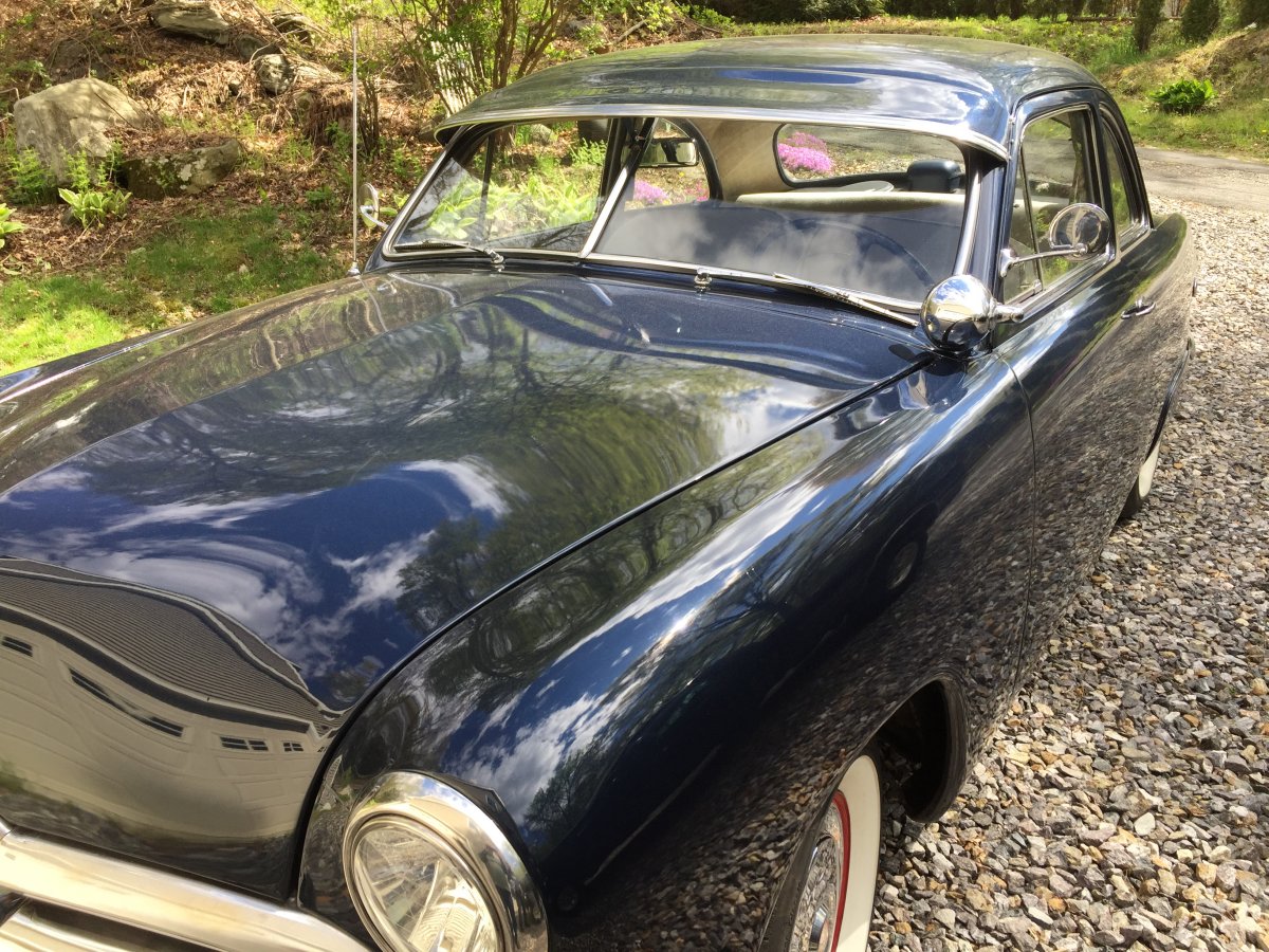

    Got caught in a rain storm a few weekends ago and just this past weekend got a chance to clean and wax the shoebox.
    One thing about WAX.jpg that is you find every flaw there is in the car and there are definitely some flaws. But that's what makes it a driver. Here's a pic of my grand kid, one and a half years old, to young to start helping gramps with the cl***ic?
