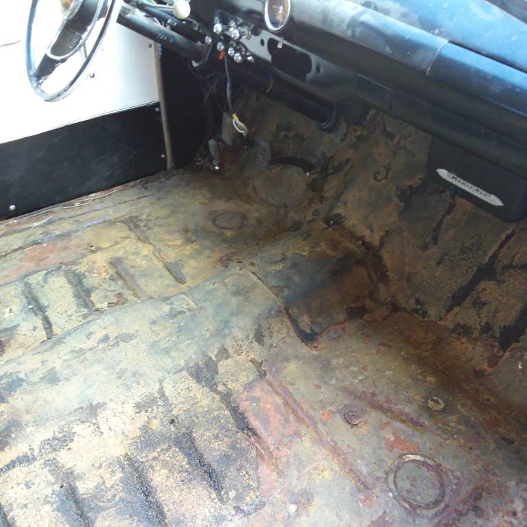

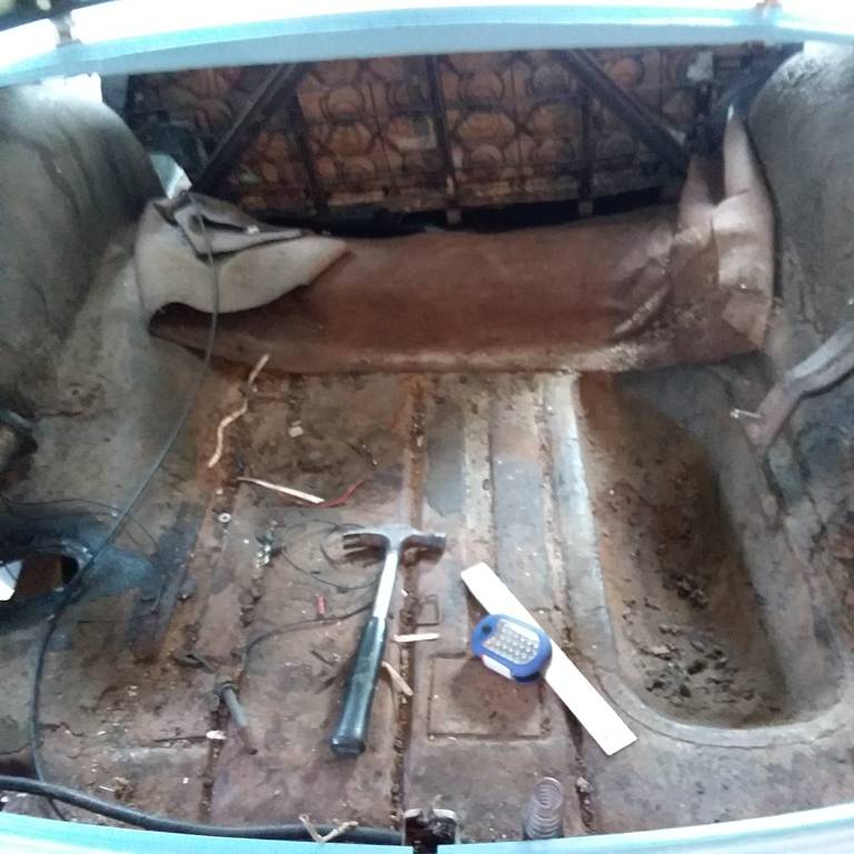

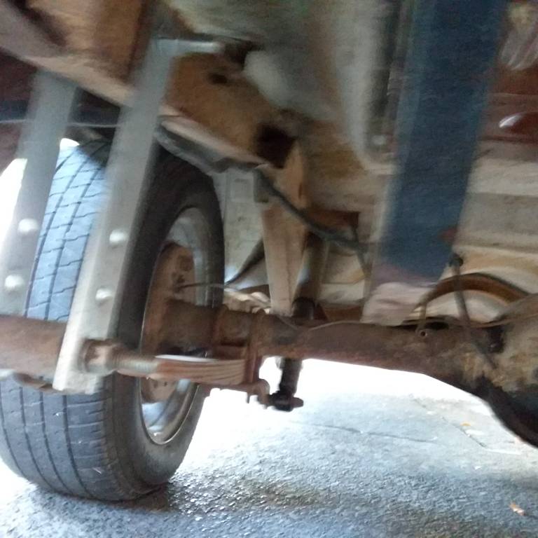

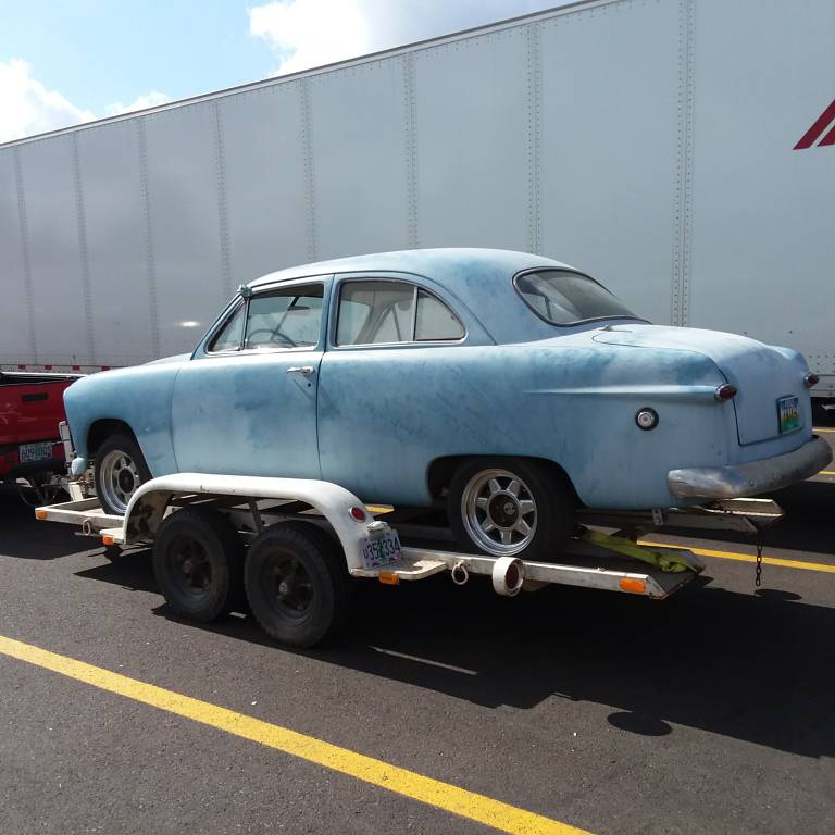

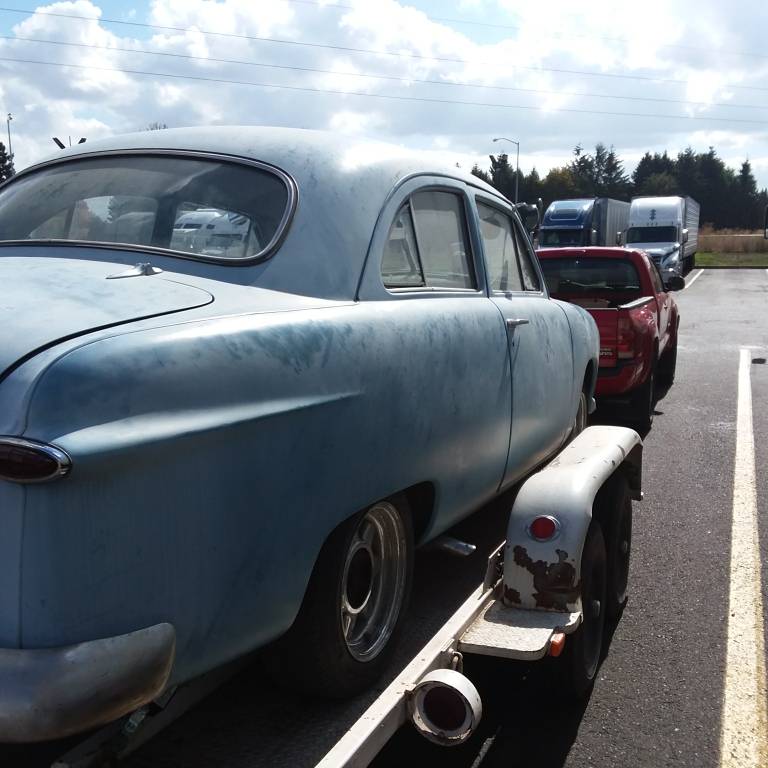

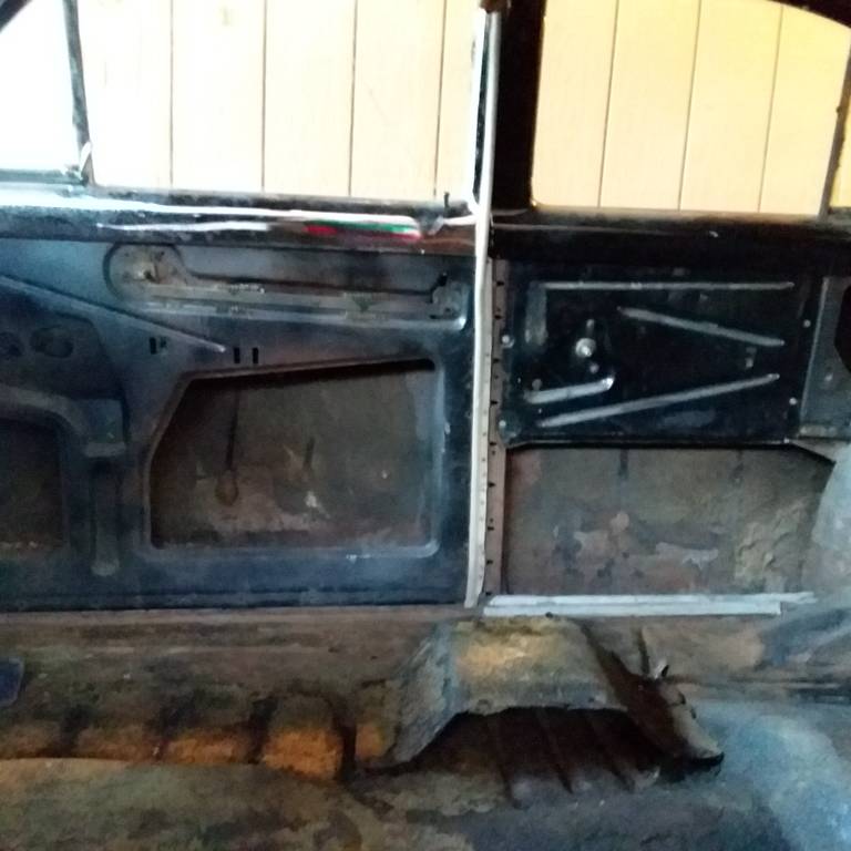

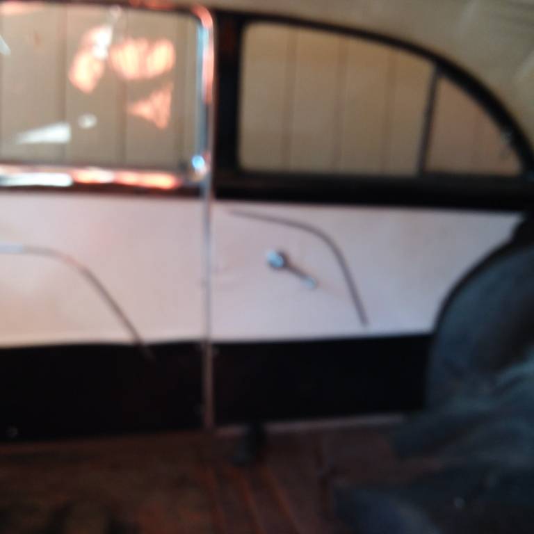

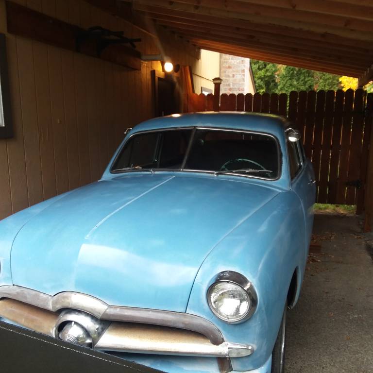

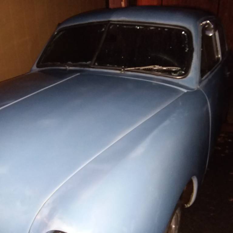

    Just started this project. Found a 49 Ford custom in the middle of nowhere Oregon. 20181004_111258.jpeg 20181004_121152.jpeg 20181004_121229.jpeg 20181006_160900.jpeg

    parabola
    from OR

    Just used polishing compound to protect the paint. Needs another three or four hours of work.

    That looks like a very solid shoebox, congrats!
    BTW, it's a sedan, not a coupe :)

    Surprised that no one pointed that fact out before post #13. Good looking car and metal appears to be in good shape. What is wrong with the engine in it now that you want to swap it out?

    Congratulations on your find it looks real solid but what you have is a sedan and not a coupe. The coupes have a short rear side gl*** like my car. HRP
