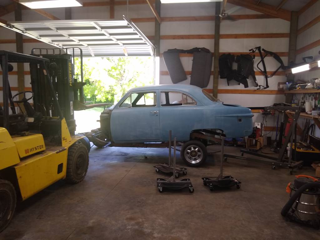

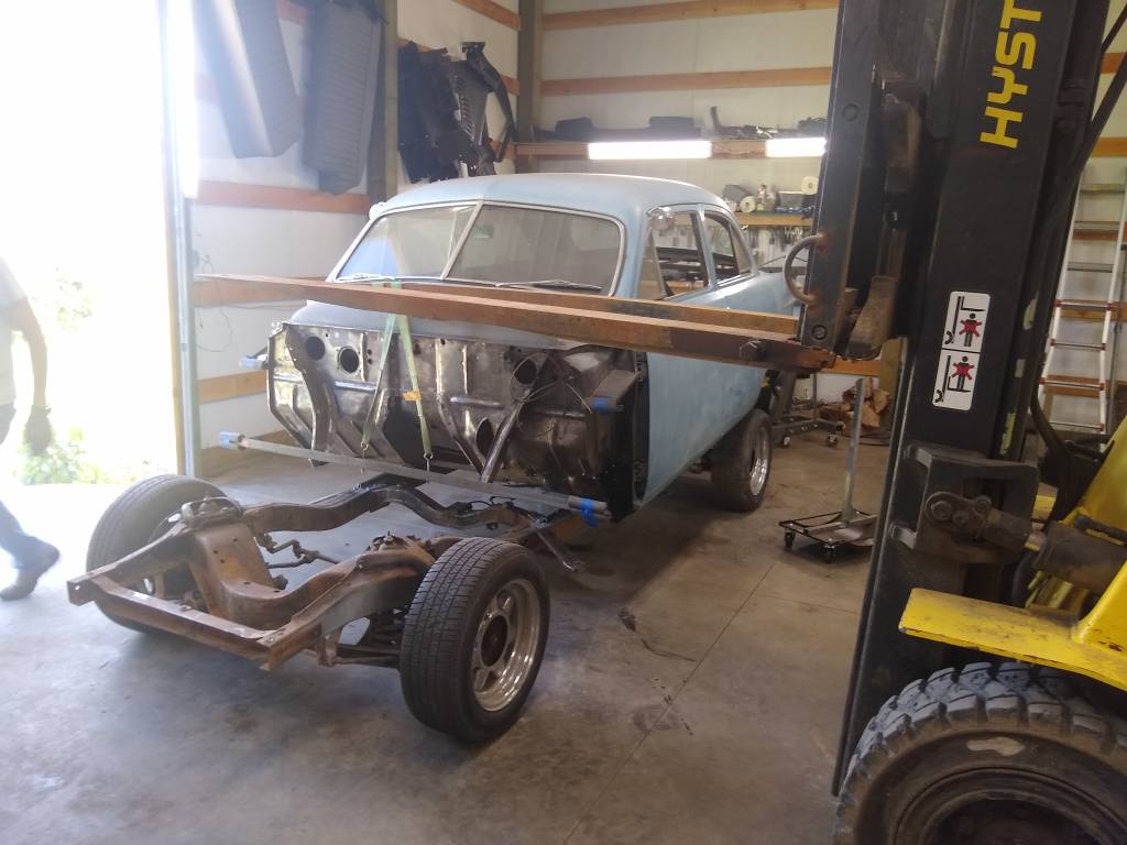

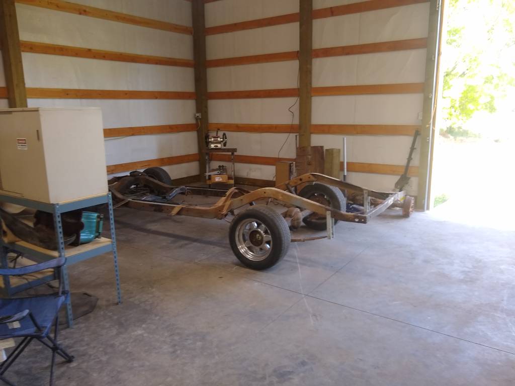

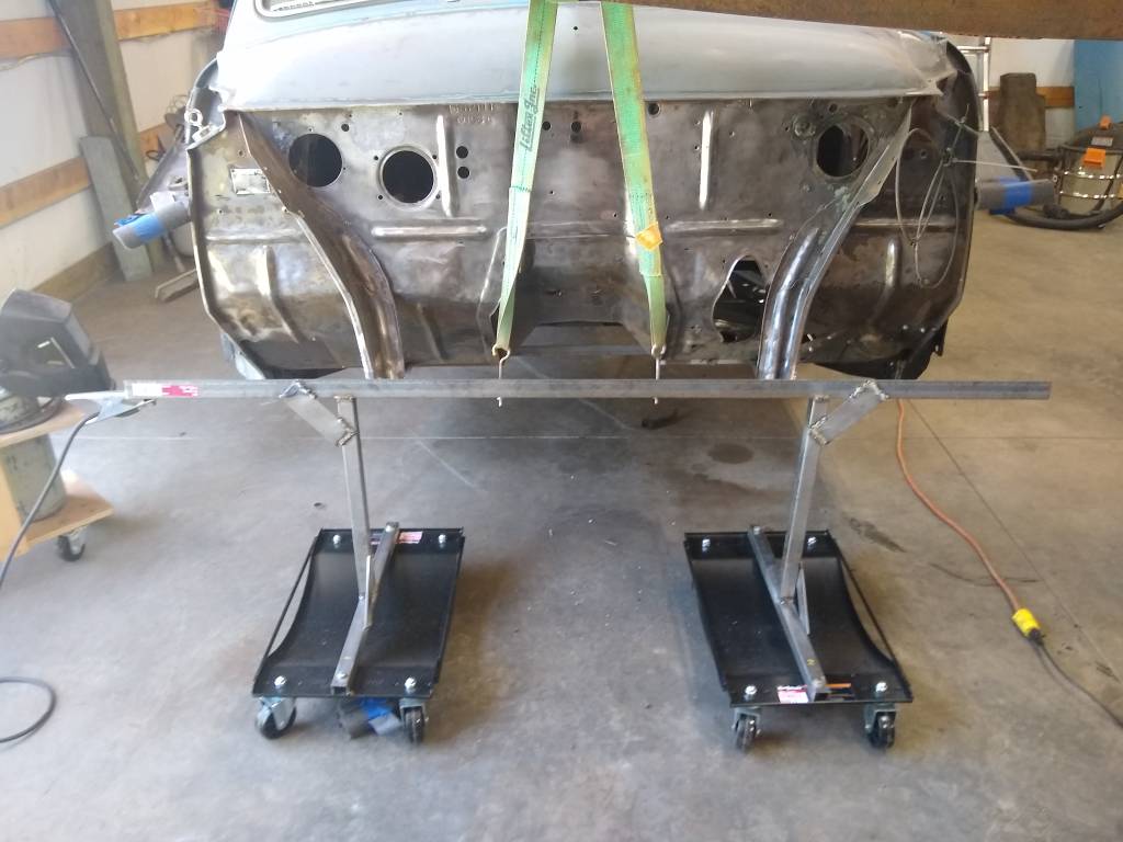

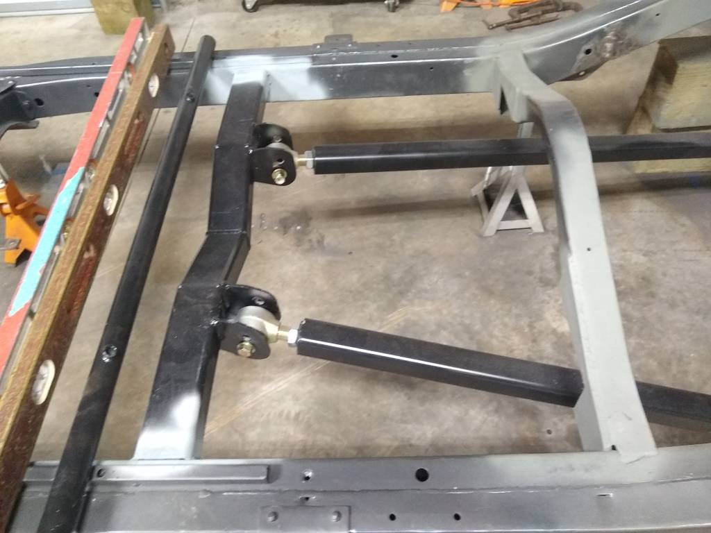

    Pulled the body off. Credit to the YouTuber Puddin's Fab Shop for the idea. IMG_20210531_111319874.jpeg IMG_20210531_111334422.jpeg IMG_20210531_114635212.jpeg IMG_20210531_124905825.jpeg IMG_20210531_124908186.jpeg

    Amazingly clean, love your new shop!
    My previous '54 Ford Coupe ended up being a body-off project, (didn't plan to go that far!)
    'Extra car' deal, got it in a parts trade...Bare ch***is got 454 BBC w/Muncie M21, fast job. no body in the way.
    Calif. car had NO rust in floors, factory paint underneath.
    Easy work in very busy fabrication/specialty shop...(Porsche/BMW and street roadster fab)

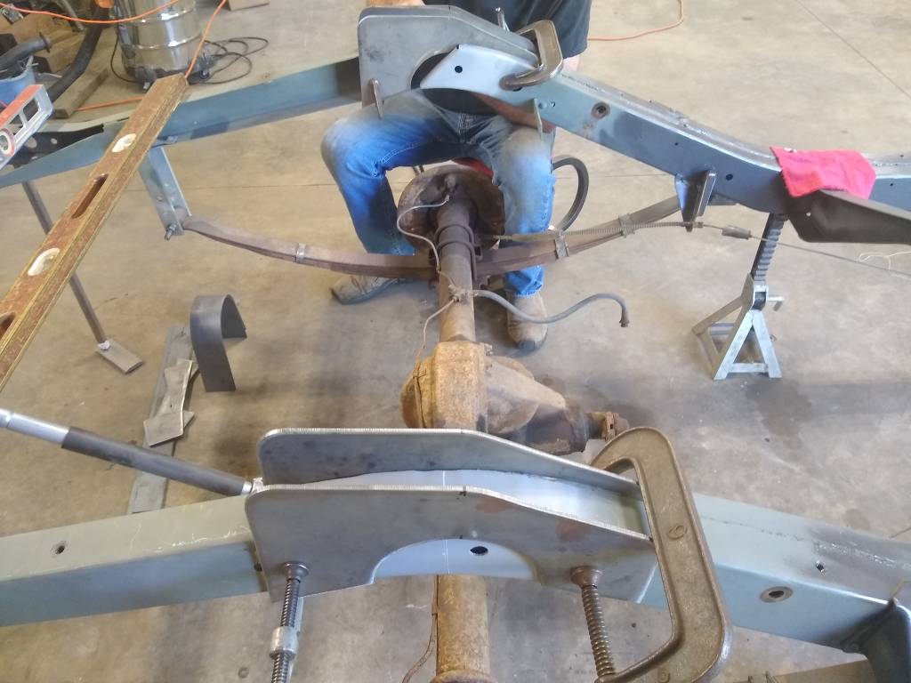

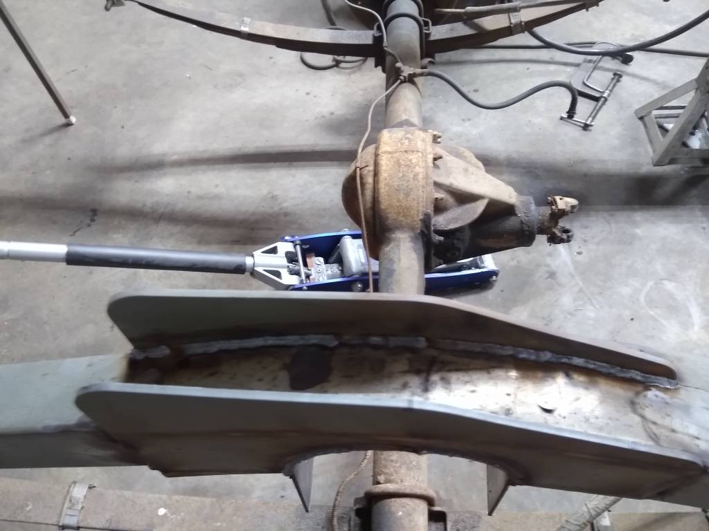

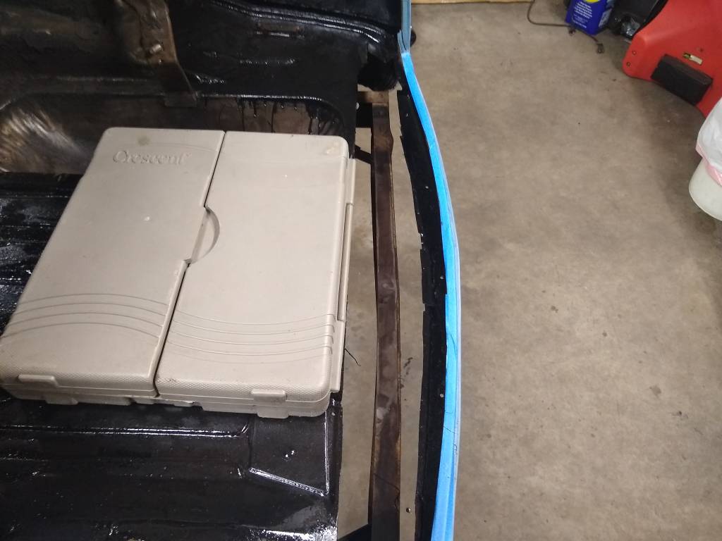

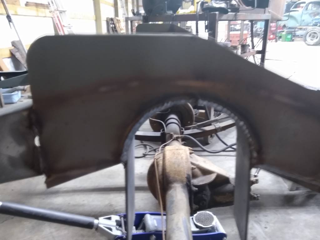

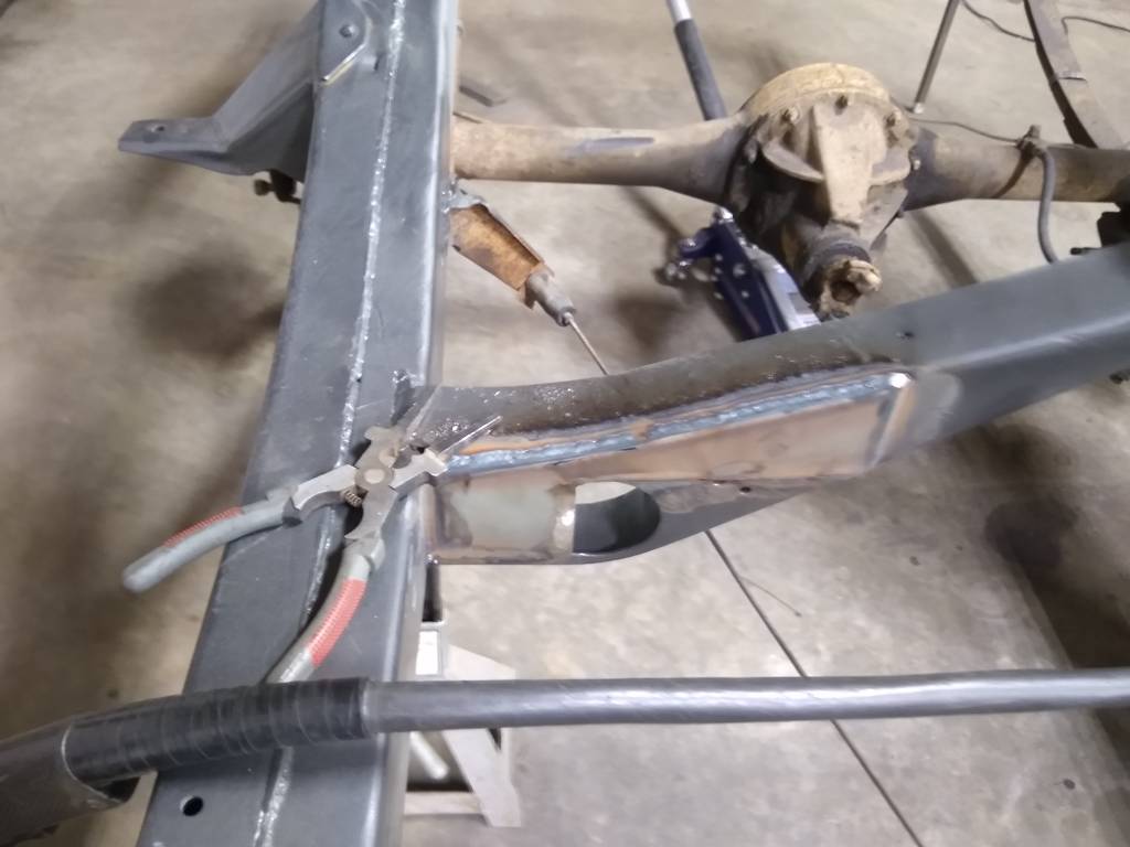

    Little bit of welding. IMG_20210619_122512743.jpeg IMG_20210622_193012034.jpeg IMG_20210622_193016591.jpeg IMG_20210622_193040755.jpeg IMG_20210622_193022757.jpeg

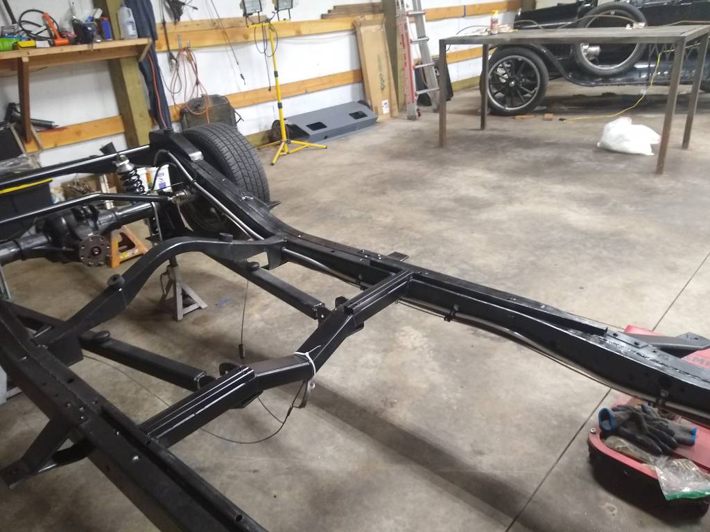

    Who built the front stub for it? Thanks Frank

    I bought a kit from Jimenez Brothers in Riverside California. Front clip, two link, and all of the parts.

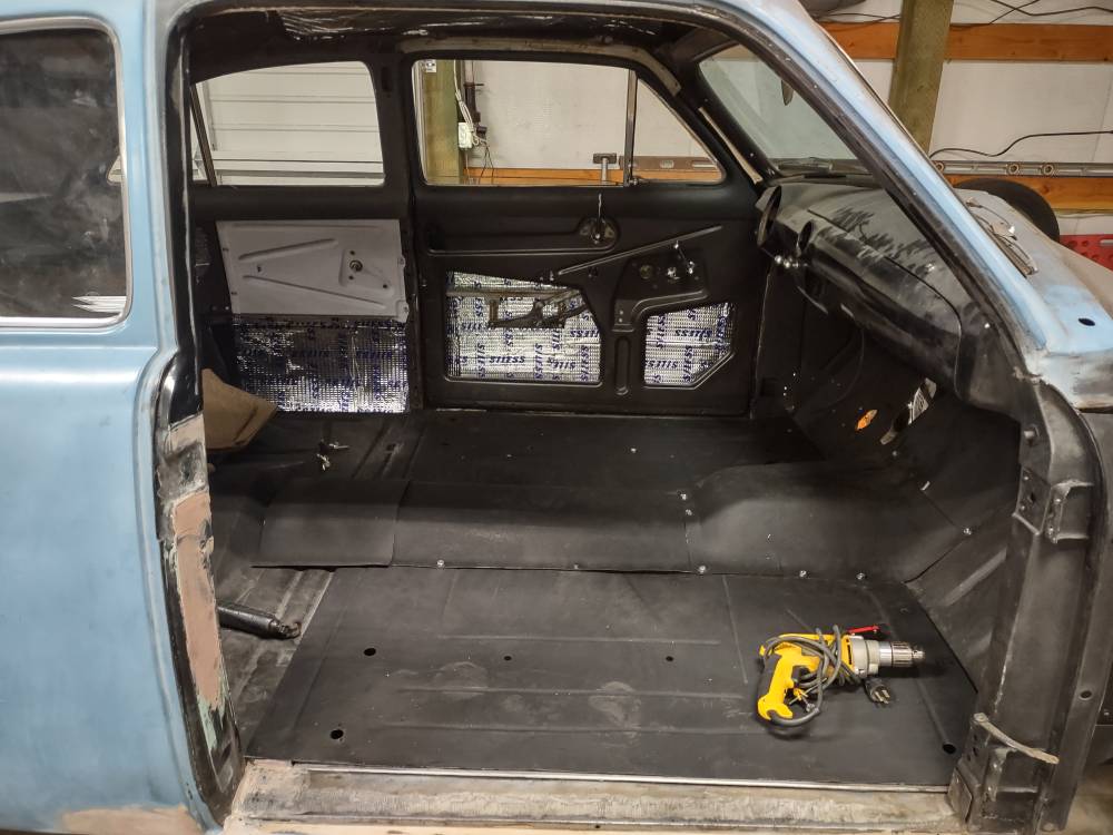

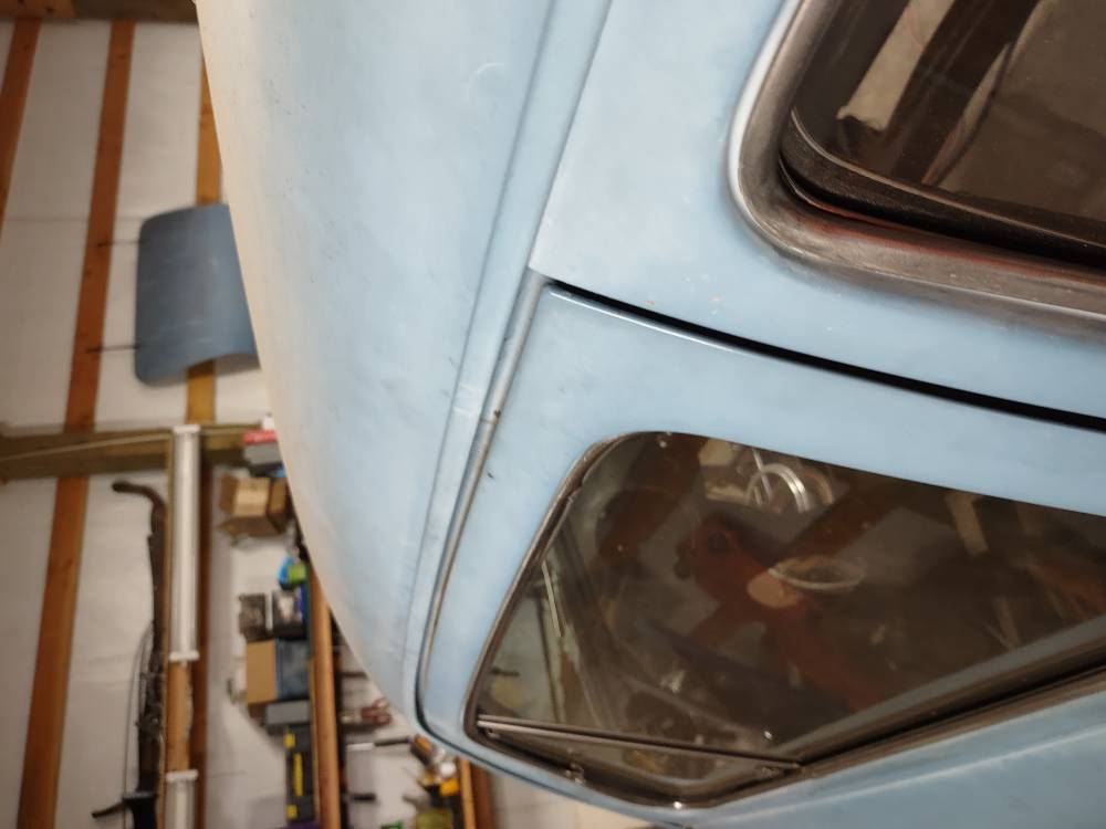

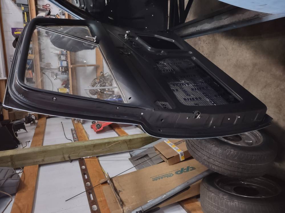

    Any ideas on how adjust doors forward? IMG_20220504_194453780_HDR.jpeg IMG_20220504_194443352.jpeg IMG_20220504_194511966.jpeg IMG_20220504_194517616.jpeg

    Installed new window felt, door gaskets, and Bear Claw door latches. It's a giant improvement, but gaps could be significantly better.

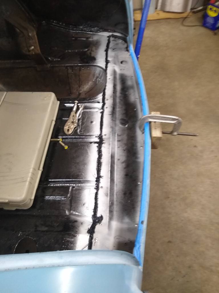

    Test fitted new panels. Pretty stoked with the results. IMG_20220522_150844160_HDR.jpeg

  28. flatford8
    Joined: Dec 12, 2012
    Posts: 177
    flatford8
    from Lyman,ME.
    I put spacers behind the inside hinge screws….. probably not the best way and I haven’t got back to that in awhile. I’ve been patching floors and the trunk….. Mark

  29. parabola
    Joined: Mar 31, 2010
    Posts: 256
    parabola
    from OR
    I tried the washer method. It helps but seems like there has to be a way.
  30. parabola
    Posts: 256
    parabola
    from OR
    I tried using a bottle jack and a 4x4 braced on the rear fender. It seems to help. I plan to move the metal 6 to 8 times over a couple of months
