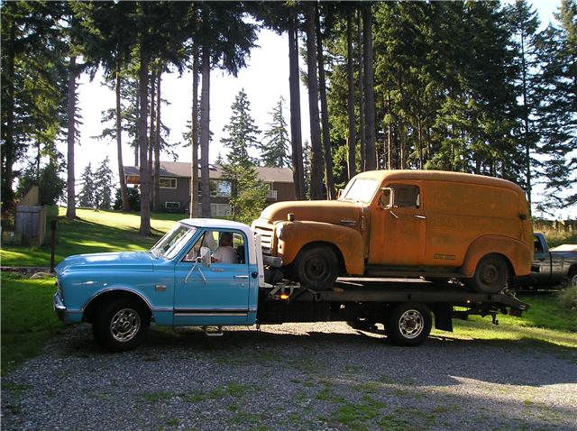

    Just drug this home, I want to keep it as traditional as possible.
    However I would like to upgrade the brakes because I do want to drive it and it needs to be safe. I know I can add disc on the stock front axle.
    Wondering if there are other options ?
    Also will rear wheel cylinders from something newer work ?
    Plan on leaving it six powered as now it has a 54 235 in it.
    Any reason to go 12V ?
    Thanks for any and all input, good bad or ugly !

    Very clean example .... I'm jealous!
    The hauler ain't too shabby either!:D

    that's quite the setup you have there. that must have been something to see tooling down the road.
  15. NONHOG
    Joined: Dec 3, 2008
    Posts: 180
    NONHOG
    Sad thing is he is going to sell the 67. Actually that will keep me from dragging more projects home. LOL

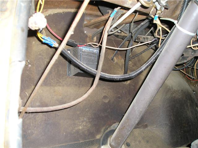

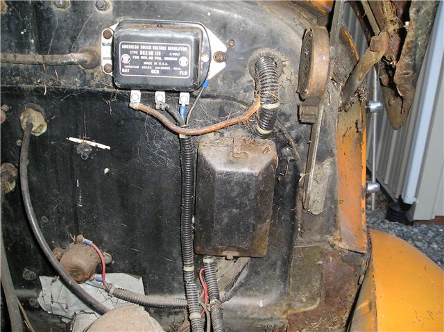

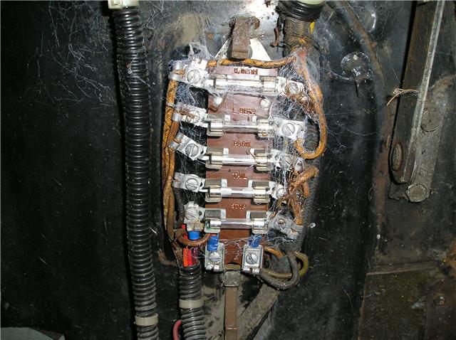

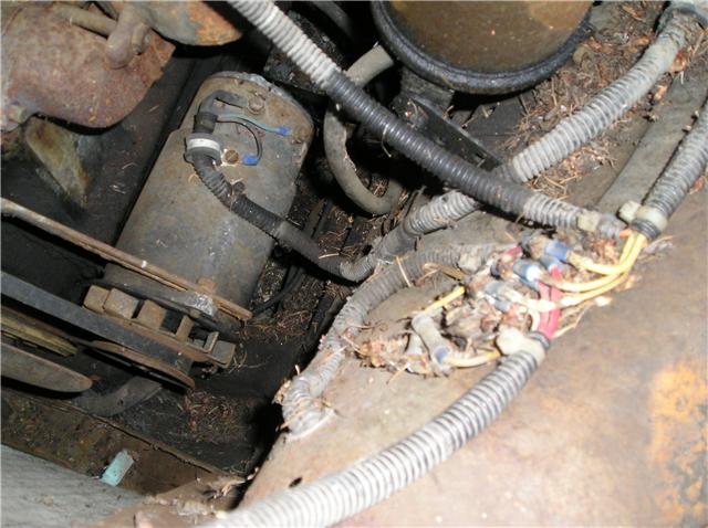

    Thanks for the reply's As for the brakes I went with a 9" Ford rear, had new drums the 49's looked pretty thin but worse is the price of wheel cylinders I can buy new cylinders less than kits for the 49 rear. Plus the 9"
    has 3.50 gears which will help if (when) I swap to a T-5.
    Took some pics of the "new" harness and other than the cobwebs it looks good (we will see how well it works). box.jpg

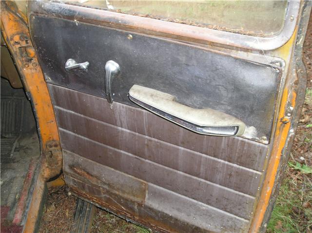

    Ford
    Falcon delux or Sprint
    Fairlane
    or galxie
    depending on how big it is
    Paul Jug
