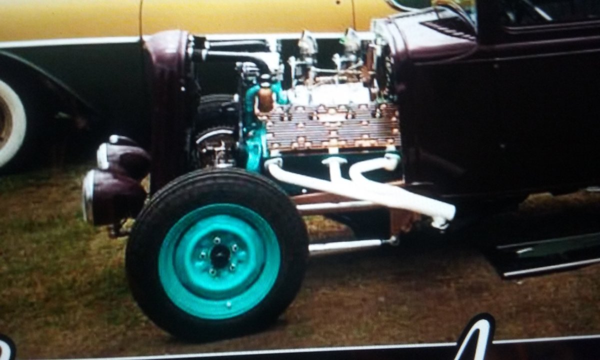

    This picture is one of the best in showing the difference in size between the 337 and standard 8BA or 59A flatheads.
  8. j3harleys
    Joined: May 12, 2010
    Posts: 912
    j3harleys
    Jet96, john worden and Texas Webb like this.
