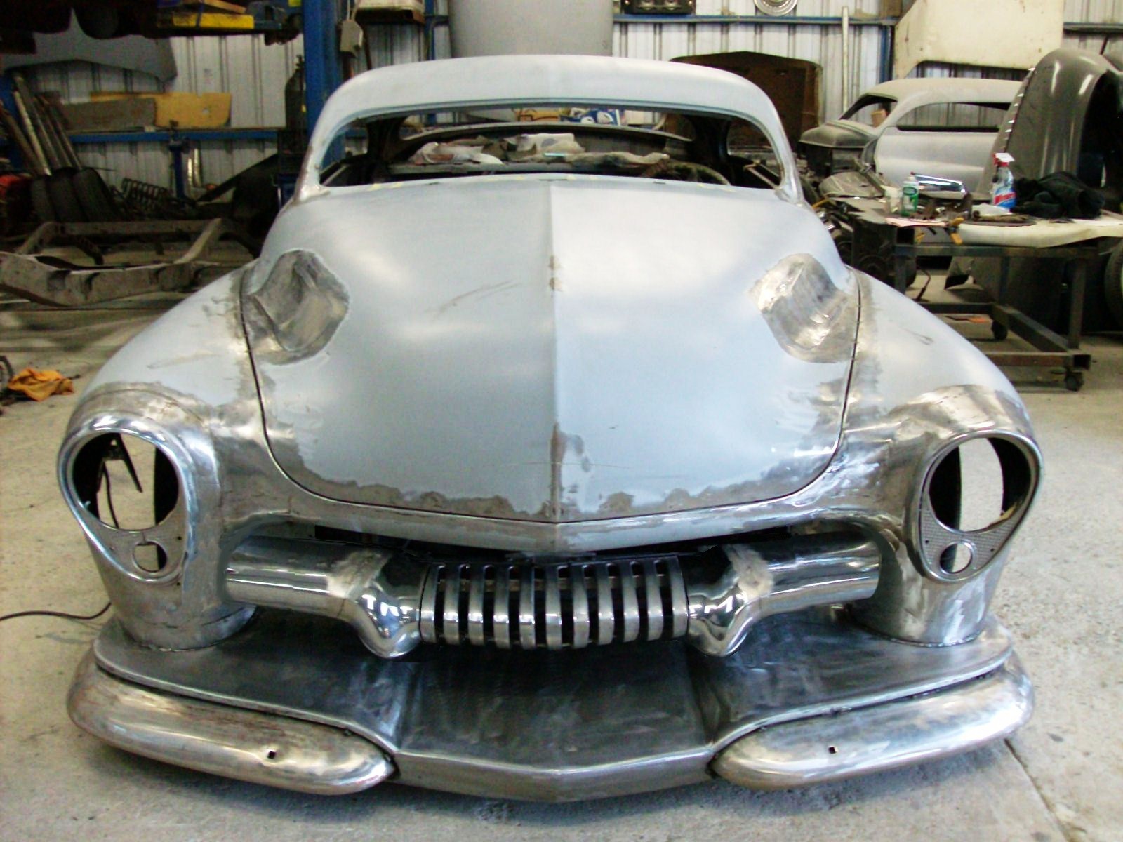

    I'm really digg'n this grill. Like we do to all kustoms we kind nick pick them. I
    was wondering of the grill was too close to the headlight buckets? I hope ya
    don't mind, I did a quick Photo shop.
    Happy Trails,
    Mick

    We are working hard to finish the rear bumper apron of this merc so I can finally finish the grille.

    Hey Mick, I do like your photo shop pic. I do plan to shorten the ends still but have not decided on the over all length of the center merc grille. Mybee you can help me with some more photo shop pic's. I am thinking of removing one rib from both ends of the merc center but keeping the gap. Hard for me to explane but only move the outer ends in about 7/8" not right next to a rib leaving a 3/4" space. Thanks, Rick

    I'm an Okie so I'm a little slow, how is this? Its a quicky....

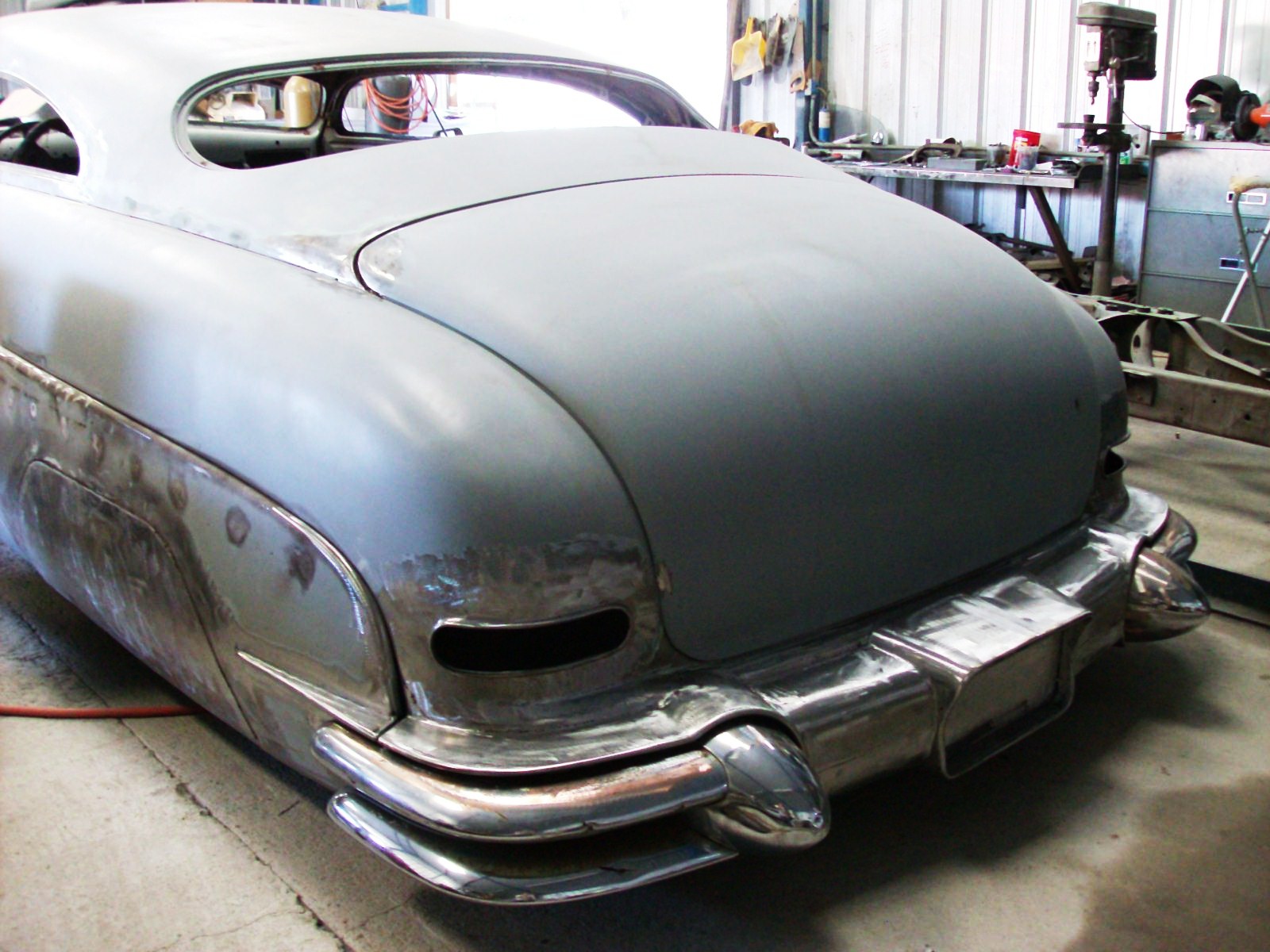

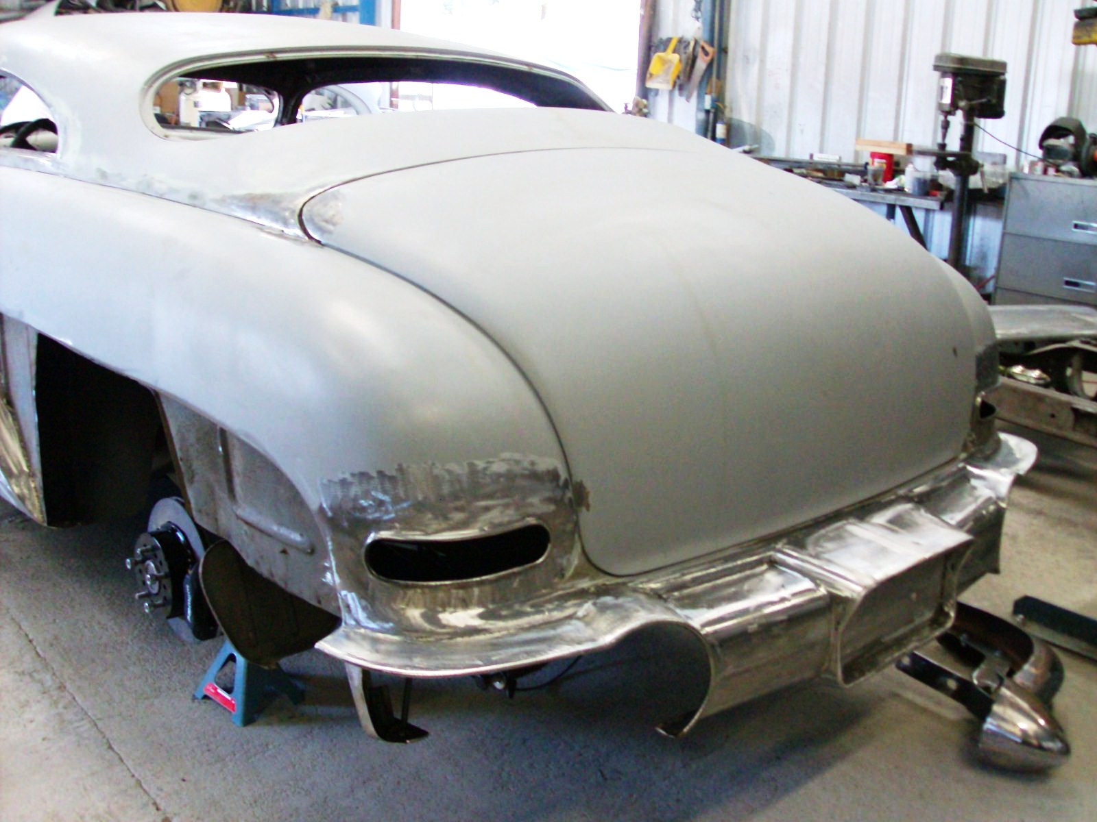

    Just about have the rear bumper apron & licenes plate box finished. We made the licenes plate box extra wide to fit the orginall 1949 Ca plates :cool:.

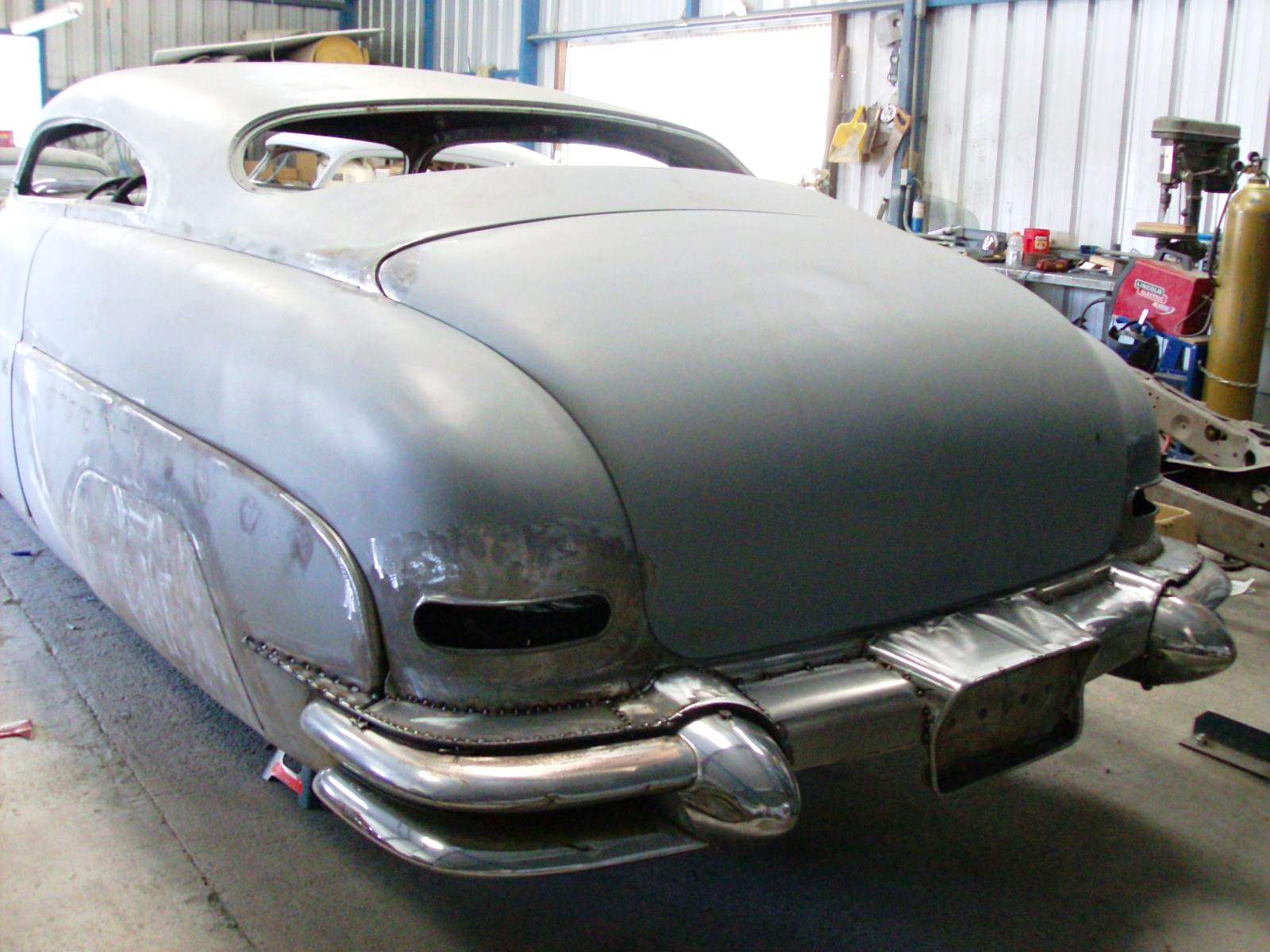

    Finished the rear bumper apron today :). Now its back to the Plymouth grille. Doing some thing a little different to the grille ends than orginaly planned. It is a secert for now but will post a few pics when finished.

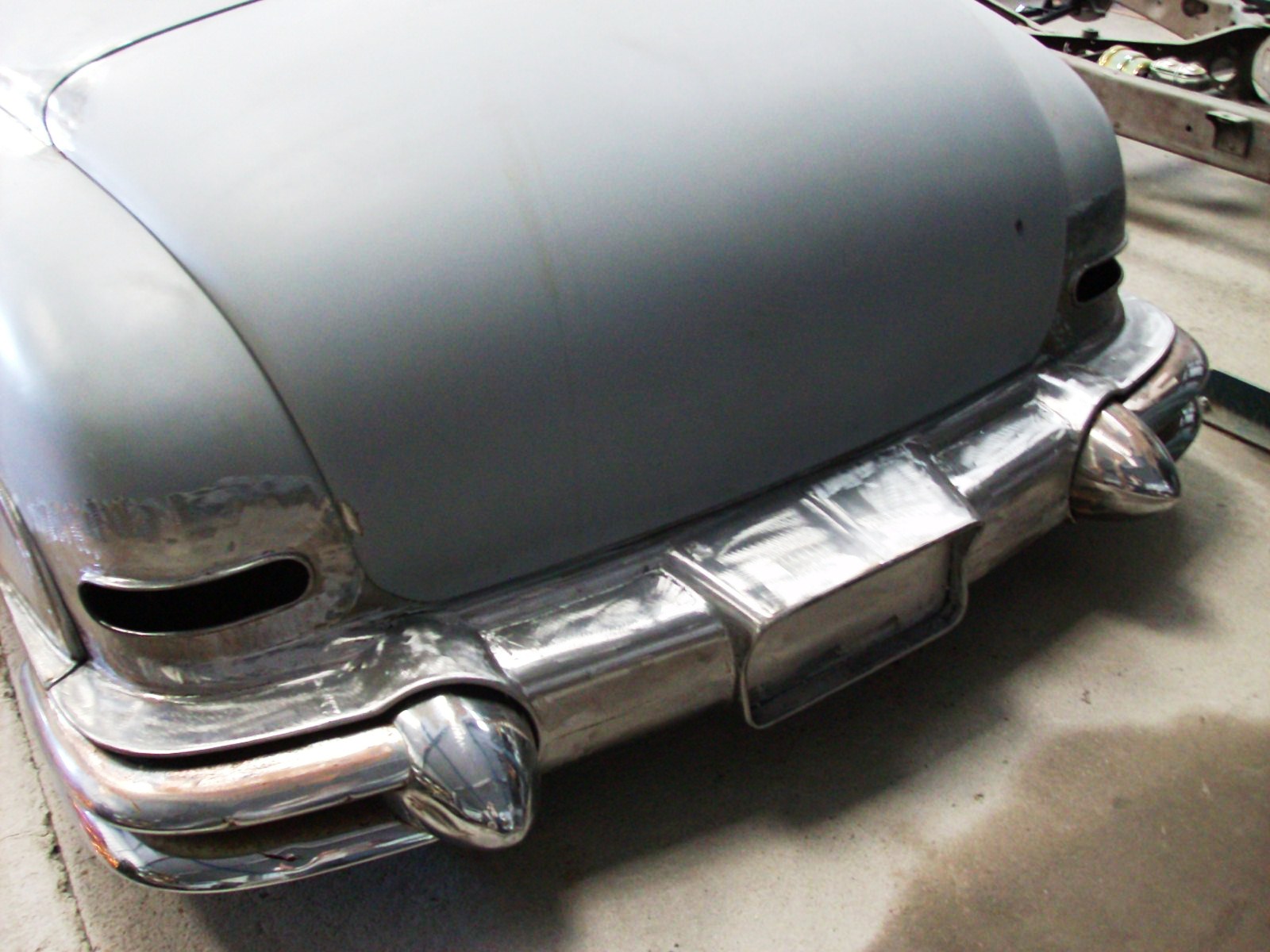

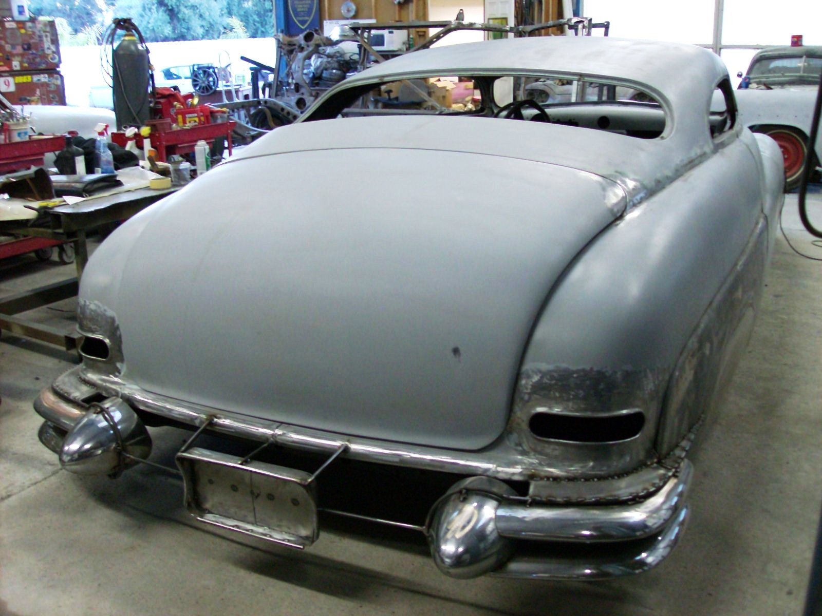

    Bumper brackets and tabs are all finished and reinstalled. Now all it needs is the orginal 49 plates

    Decided to finish the ends of the 55 Plymouth grille with a smooth radious tapper instead of bullites on the ends. I reshaped the ends out of some old bumper guards I had laying around. Now that I have the grille fitted I can remove it and finish welding all the fab seams on the under side. I then will br*** weld all the seams on the outer side and metal finish them so they can be chrome plated.
