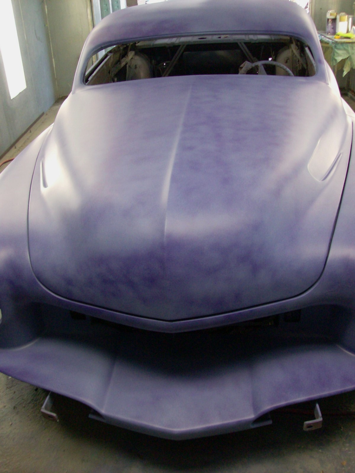

    Got the Skirts fitted & the gaps gaped. One more blocking and its paint time. So far the owner still has him mind set on BLACK wawawa :( so if you want to see it in some thing other than BLACK nows the time to speak up.

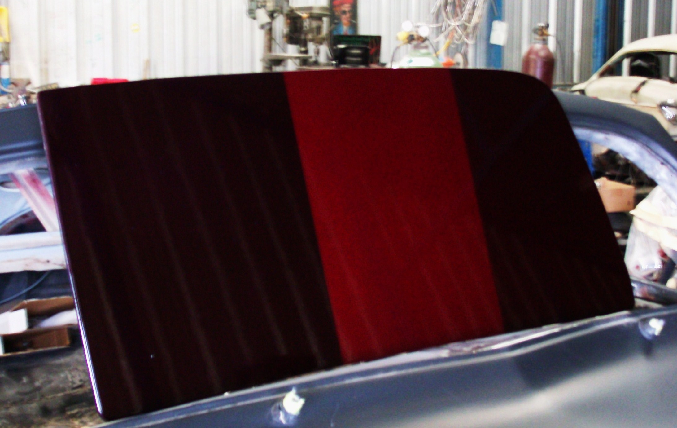

    from SO CAL
    Here are a few pics of the color test pannel. All three colors were done with the same dark red candy the only difference is in the base colors. The lightest or center color is over a putter pearl and the darkest is over a bright blue pearl and the middle is over an irish green pearl. In the first pic the bottom color is the one i like the most as it is dark cherry red in direct sun light and looks black in the shaded so it should give off the most accsents.

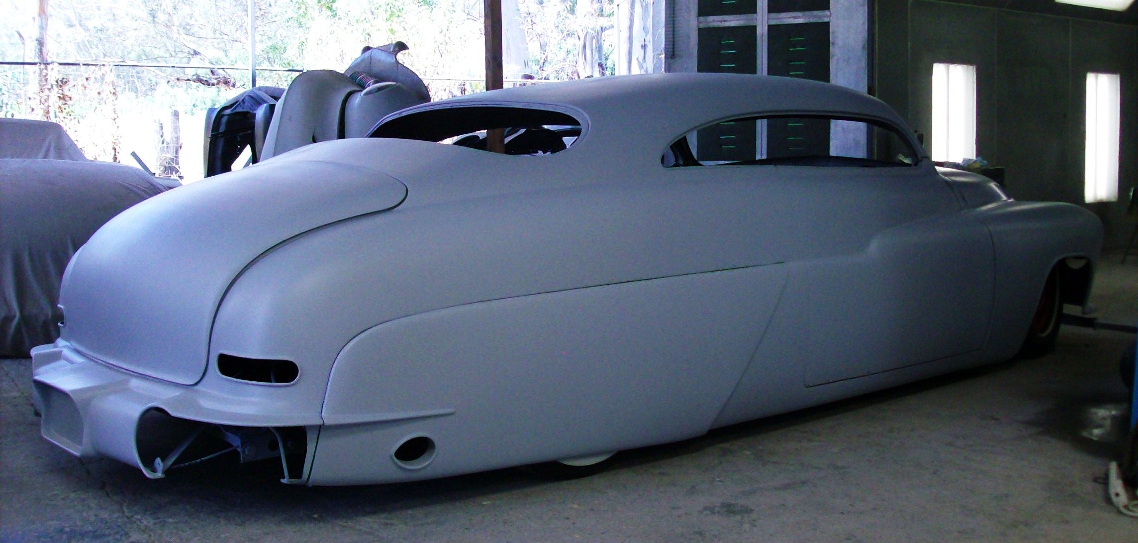

    Yesssss its ready for paint. Just need to know what color so lets here your choice and help my customer make his finall decision.
