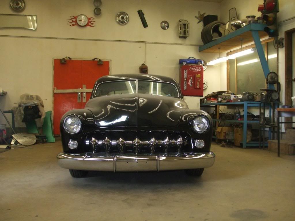

  14. desotot
    Joined: Jan 29, 2008
    Posts: 2,056
    desotot
    I moved the 40 Ford out of the way so I could get a straight on pic, I'm still short one head light ring but you get the idea.
  15. The Mercury's looking awesome .
