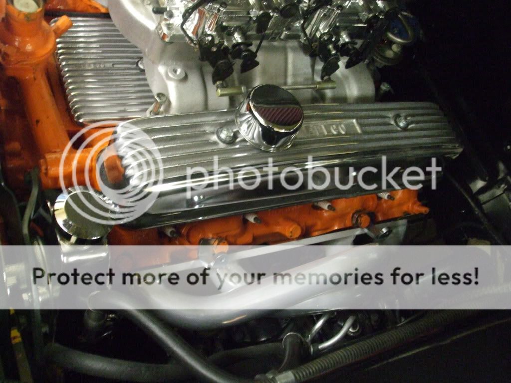

    that nailhead fit really nice

    Very nice. Will the buick exhaust manilds have enough room around the steering box or are headers necessary? Thanks
  30. desotot
    Joined: Jan 29, 2008
    Posts: 2,051
    desotot
    I tried to sqeeze in exhaust manifolds but the driver side was to tight, I could have moved the engine 1" off center but the drive shaft would have touched the exmember and I would have had to open up the frame slightly, I had the mandrel bends laying around from an other project that didn't happen so I put them to use.
