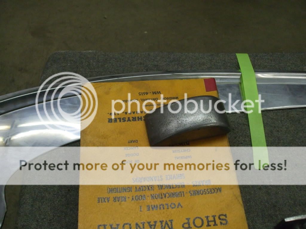

    I decided to run a full lenght front fender moulding so the front fender piece was not changed in lenght. After looking at many pics and seeing different folks running this piece from short [ starting at the rear of the wheel opening to the front of the opening and and other cuts in between ] it was difficult to decide what to do because they all looked fine, the other decision was whether to stay close to the top of the wheel opening or raise it a little higher like on some of the car pics I have seen on the web. Finally I decided with the long and low profile. This also saved having to shorten that first trim piece.In laying out the pieces on the side of the car I realized I would have to notch the front fender so that the door piece could byp*** the fender when the door opens, this is nescessary due to the fact that the moulding is almost a full inch thick at the peak compared to a stock mercury trim piece which is about a 1/4 inch thick. The 49-50 baby lincoln with the thick moulding has a notch in the front fender for this reason, fortunatly my car is not yet painted, I will have to weld the notch with the oxy acct for a nice smooth fusion. I also had to tap in the rear capped edge of this moulding to provide more clearance.
  13. desotot
    Joined: Jan 29, 2008
    Posts: 2,056
    desotot
    The door would require an extension because the buick door is about three inches shorter than the merc door, We had to make a choce on how to best do this with our abilities. After test welds on an extra piece of stainless we decided to go with a **** using a piece of stainless backing for a slip joint. This piece needed to be carefully cut and sanded to the right size and shape for a snug fit.We also had to mark and cut the pieces to the right sizes so we calculated this carefully.The mouldings are tapered so it was important to make sure the slip joint lenght was matched for a good fit, as well well needed straight lines so we set up a zip wheel in my old radial arm saw to do this.
    tape on the moulding gives us two parrallel cut lines, now we can cut the mouldings.
    here is the stainless piece for the slip joint, this will be tacked after so that the joint will stay nice and tight.

    When we cut the extesion for the door piece we also made the cut for the quarter panel piece. This piece needed only to be capped so we now capped the door extension and the quarter piece, these were tigged.
  15. desotot
    Posts: 2,056
    desotot
    The only thing now was that the bottom of the 1/4 moulding has a square piece that looked unfinshed so I looked in my stainless left over from other cars bucket in my leanto and found a single 54 olds rocker panel which had a similar character profile to the buick trim so I cut the ends of and used them to make a pair of stainless spears.
    don't know if we did this right but that is how we dunnit! Now to work and polish this stuff into *****liness. Special thanks to my brother Bill for all his help and expertise!

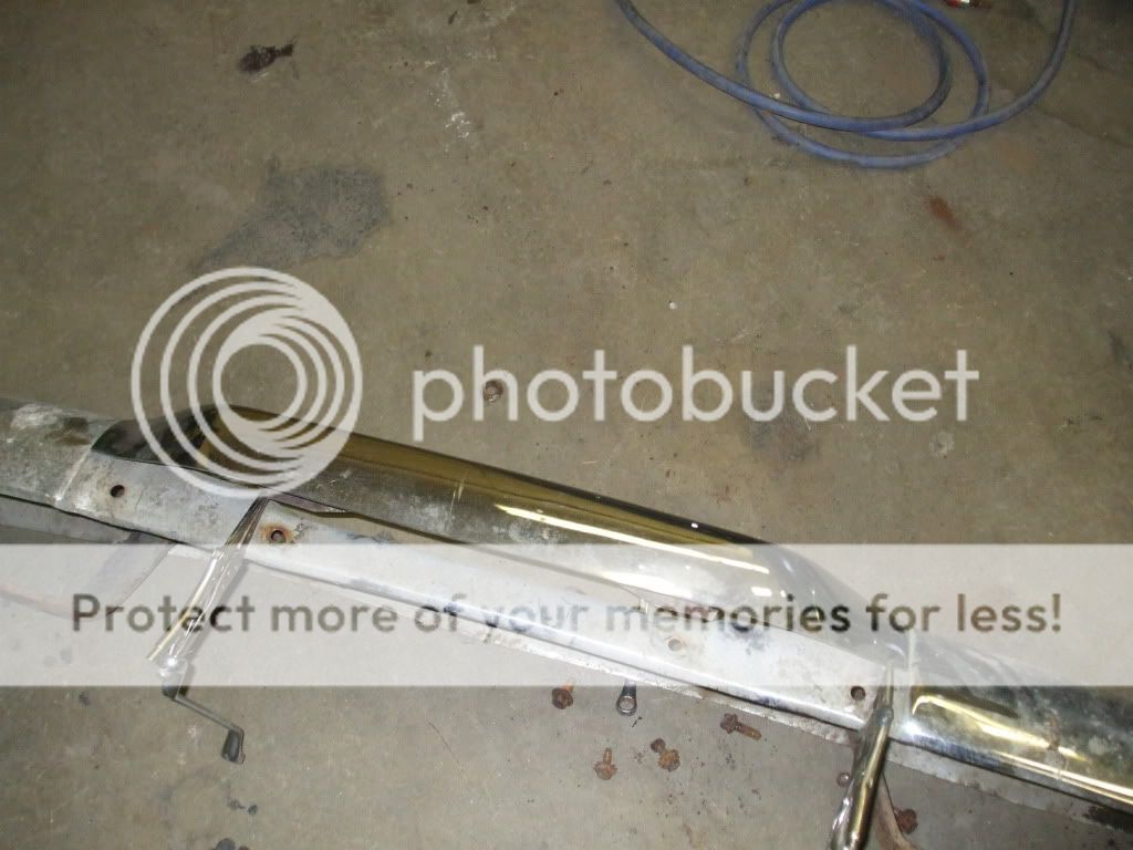

    so now I am going to figure my bumper arrangement, first I welded the rear bumper holes with the usual plate stud routine.Next I will use a 49 50 chev licence plate surround when I get my hands on one, willprobably order one from chevs of the 40s as they look like a natural adaption.
    still have to make up my mind on whether I will use a smoothed out stock bumper or modify this 54 desoto bumper, I prefer the desoto bumper but I have been known to change my mind at the last moment. The desoto bumper doesn't seem to clash with the merc rear bumper.

    working on the bmpers, I finally made up my mind exactly.I had a pair of 56 olds holiday bumpers kicking around so I robbed the licence surround off the rear bumper and nipped andtrimmed it so it would fit the merc bumper.The nice thing about it is it is wide enough to cover the flat spot on the merc bumper.Here are some pics.
