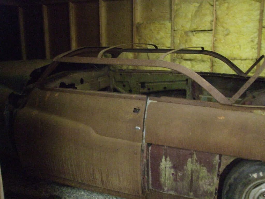

    thanks vonbuzz, I originaly felt it wasn't chopped enough but now that I've had it for a while the virtues of a mild chop are starting to hit home, however the next merc, also a 49 coupe which had the roof removed to make way for a carson top [ I've since decided to install 56 caddy conv top bows and make it work] anyway it has a shorter windshield frame so it will be more chopped.
