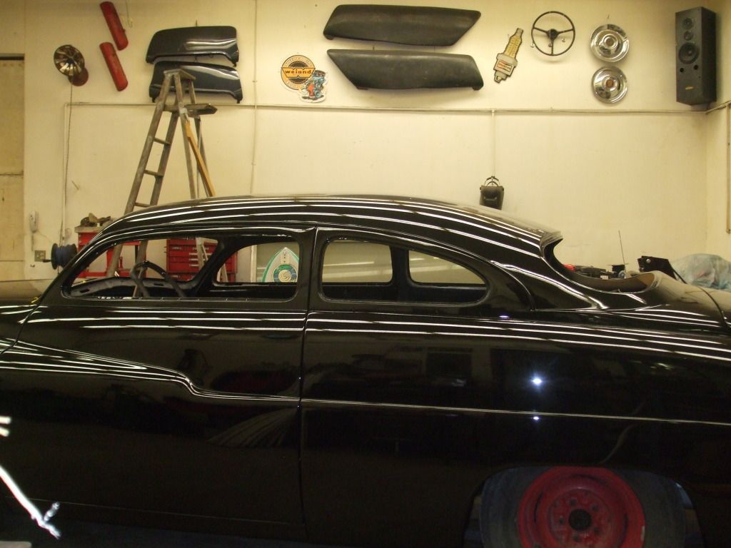

  13. desotot
    Joined: Jan 29, 2008
    Posts: 2,056
    desotot
    Some colour,, some pics , it will come home in a couple of days.
  14. paint looks great.is it polished or is that right out of the gun??
    great build,wish mine was closer to paint!
  15. desotot
    Posts: 2,056
    desotot
    the hood is getting some polishing to get rid of a fuzzy, it's pretty much done so it will be bolted on soon as I drop of the cowl lace, I brought out some everseal to put between the 1/4s and the body yesterday so they can be bolted on as well.
