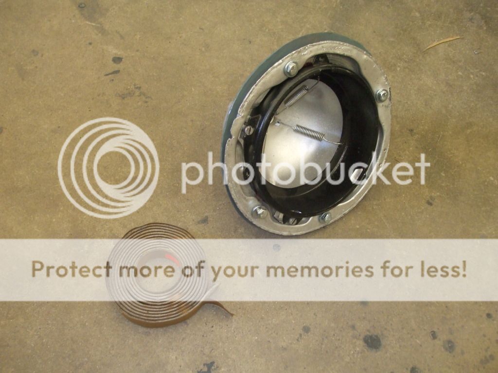

    Well, I have put the tail lights and front signals on and thought I should get the head light buckets mounted. I had two sets of buckets, one set of aluminum and one set of steel buckets, I decided to go with the aluminumbecause they are lighter which seemed important to me because they have to mount on the backside of the fenders due to the fact that the 53 merc headlight rings are welded on and now they won't be able to go though the front of the fender anymore.So what I did was I made a pair of rings with nut welded on the back side and these go on the rear of the bucket like a large washer so that thebucket gets pinched between the steel fender and the manufactured ring. The reason I did this was so that the bucket wouldn't be dangling by 4 points and start to break as I didn't want my headlights falling out . Here are some pics.Hope all this makes sense as I sometimes don't come accross that well.
    First I flattened the edge of the buckets to wide the sealer surface and allow the bucket to gat as close to the fender as possible.
    Here is a pic of the ring I made, it fits over the back side of the buckets flange.
    I put some grease on the raised bumps on the bucket to allow for smoother movement when the headlight is being adjusted.
    Some sealer to stop to much road **** from coming of the front tires.
    Before I took the car in for paint I made sure I ground a V at the bottom so the water could escape. Read this on the HAMB a while back.
    Here the bucket is installed.
    And here is a backside shot of the bucket with the retainer ring.

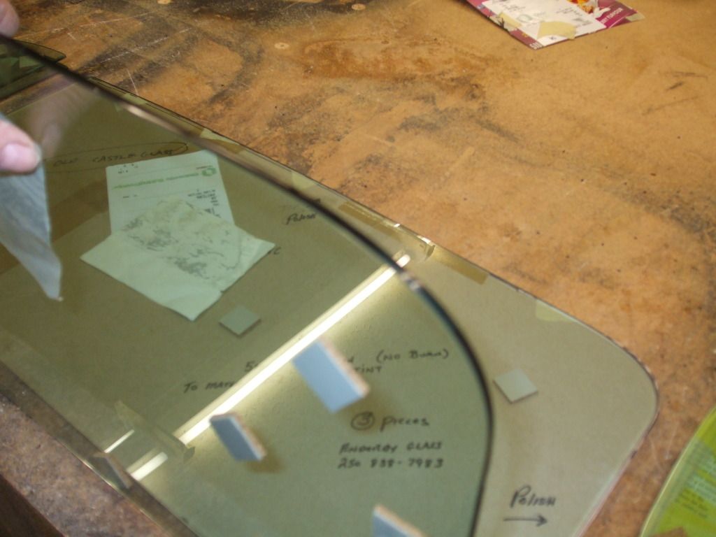

    Well, I got my tempered side gl*** yesterday, I had it made in 5 mil cause it will bind less than 6 mil will in the channels when you roll the windows up and down, it also weighs slightly less and the 63 year old regulators will appreciate it.I went with tempered because they won't break as easily. The back edge of the vent window, the front, top, and rear edge of the door gl*** and the leading edge and top and bottom radius of the 1/4 windows have been polished giving them a factory look. Here are some pics, hope they make sense.

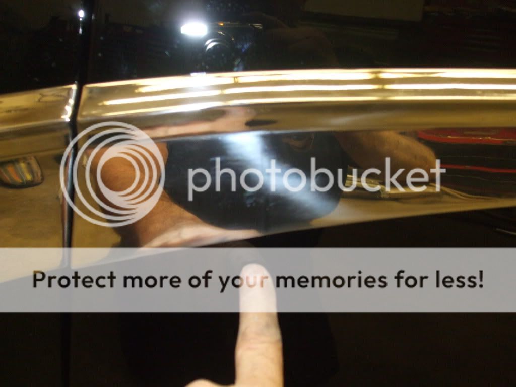

    Well, I got my buick side trim back from the stainless finisher today.The door pieces were lenghtened using a section from the 1/4 piece and welded,now they are finished and you can only see a line where the stainless rod alloy left a slightly different colour just above my finger on two of the pics. .p*** side.
