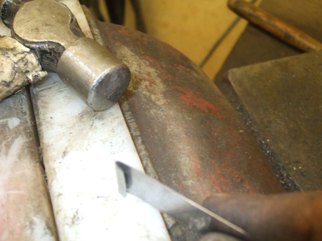

    Had an idea tonight when I was in the shop, I needed a whole whack of stainess clips for my door and 1/4 window stainless and I was wondering where I could find somethin springy stainless when I spotted an old flex fan hanging on my wall.So I grabbed a bunch of tools and made 8 of them in 2 hours. Here are some pics.
    you will need to deburr your piece carefully.I use my gl*** grinder,it's a belt machine with water.
    You will have to put a 3/16"bend on the end of your stainless strip.
    Then use a s**** piece of window opening trim to wrap and shape your clip, when this is done trim it to the right size and deburr your last cut , now polish the clip and repeat the process till you have enough clips,,,watch your fingers!
    And I didn't lose a single drop of blood,,,,this time.

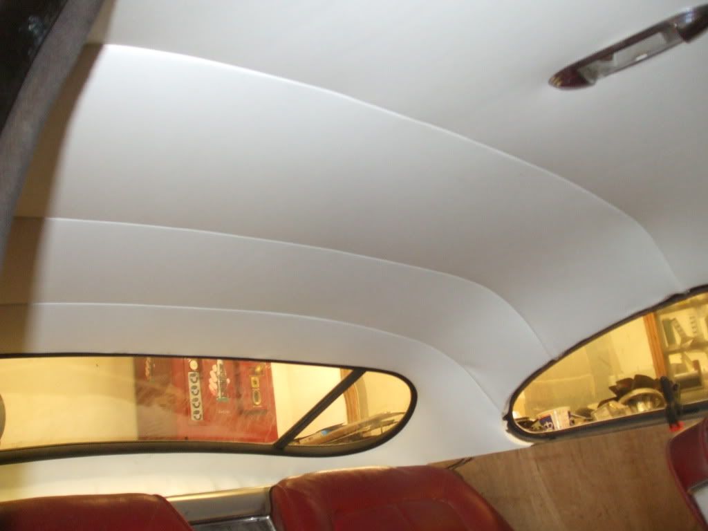

    I finally made and installed the headliner, that was nice cause I was also able to install my rear window finally.

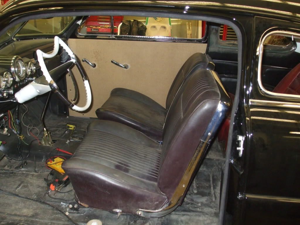

    So anyways, I now have the option of the G.M. buckets with the big shiny band over the top of the backrest, one advantage to this seat over the Riviera bucket is that both hinge points on the inside and outside of the seat are the same soyou have the ability to alter the stops and the seat will still sit evenly to the seat bottom where as the riviera seats have two different hinge points so that the left and right seats cannot be interchanged and the is only the possibility of one correct position for the back rest. The large chrome band will look good on the black naugahyde anyways.
