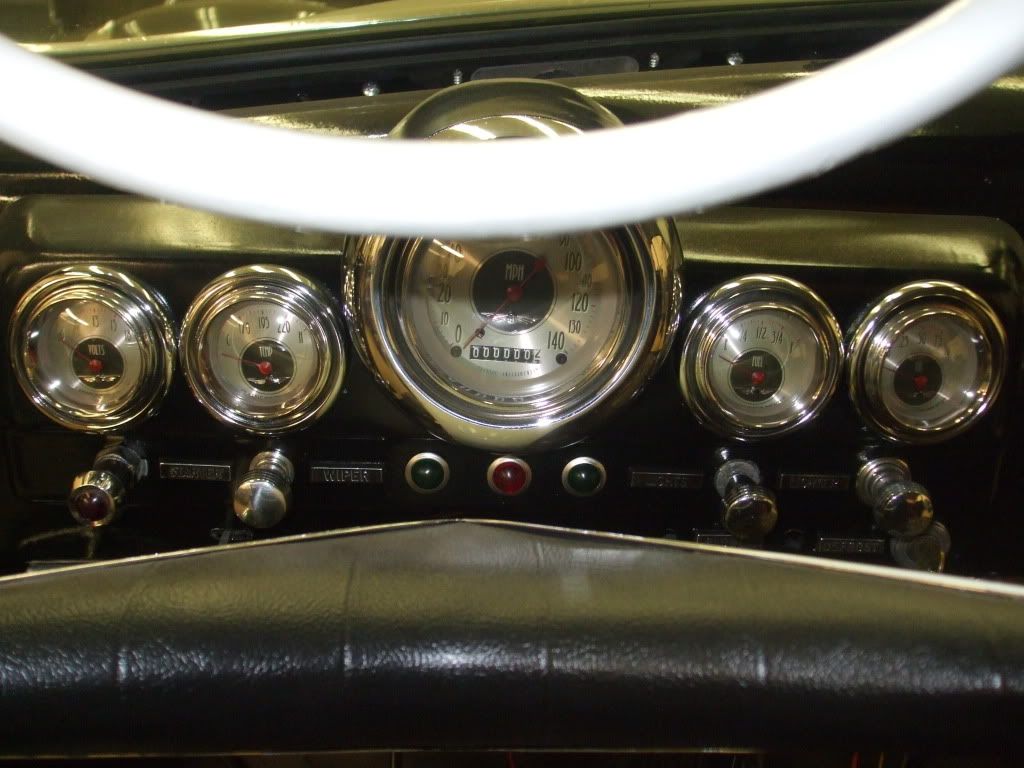

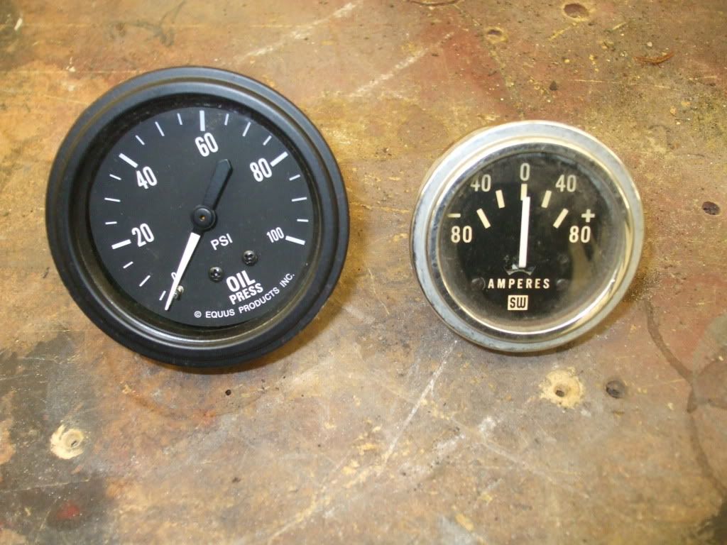

    I have avoided close ups of the dash cause I am aware that for many folks it is sacrilege to make certain changes on a merc such as bucket seats, newer gauges, seat belts etc...forgive me for I have sinned.I installed cl***ic instruments, these I believe were called , American Nickle, the had little chrome wings and curved gl*** and a nice color on the faces and followed me home from the parts store, what could I do.I had a problem installing them because they fell through the holes on the merc dash, after staring at the rubble heap for a while I mounted the speedo into the factory merc speedo ring, then I bought some gauges at the puyallup swap meet. These gauges were a 2 1/2" dia housing and my new gauges were a 2 1/8" housing. I carefully removed the stainless rings of the larger gauge and they fit behind my smaller gauges. This worked well because now they matched the look of my new speedo in the merc ring.
    First pic shows the large gauge with the ring removed compared to the smaller sw gauge which is the same size as the cl***ic gauges.
  2. I like the gauges. I'm planning to run some old buckets when I come a nice set.

    Gorgeous Merc! Great work man!

    Thanks for the tech on the gauges. I am also looking at Cl***ic Instruments.

    Those gauges look awesome in there!

    Thanks guys, the paint on the dash is pealy, I thought I could live with it but I can't so now I have to disasemble it again to repaint it.

    dash looks great jack!

    thanks for the kind words guys but my dash was out to lunch so I repainted it, seems like everything take to long to do.Here are a couple of pics of the gauge rings so you can better see what I did.
