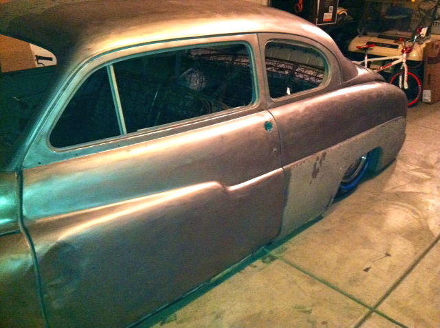

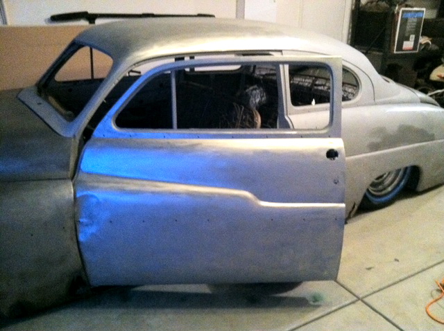

    Put the Body back on the new Chassis and even DA'd the Sheet Metal...

    from nowhere

    More Pics...
