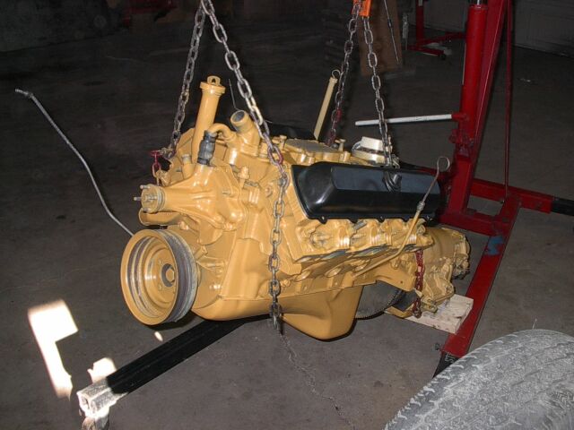

  1. got the merc on the trailer and will take it to get sandblasted this week.painted up the 403 olds for it this weekend. Also moved the 2 door merc over in the shop and marked out where the chop will be . going to chop it monday or tuesday nite.
  2. 403 olds for the convert
