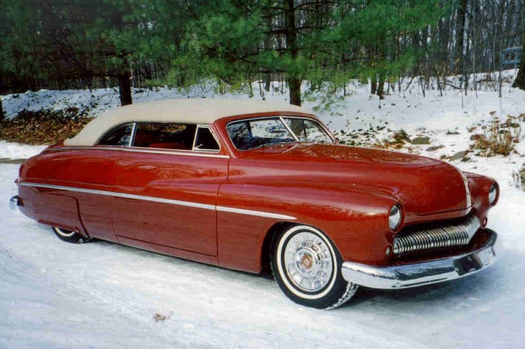

    My thoughts about a hardtop was to end up looking like this but with a painted roof.

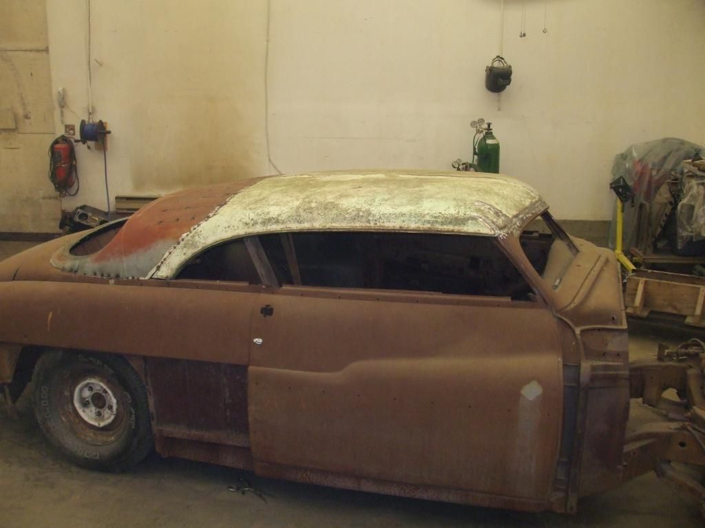

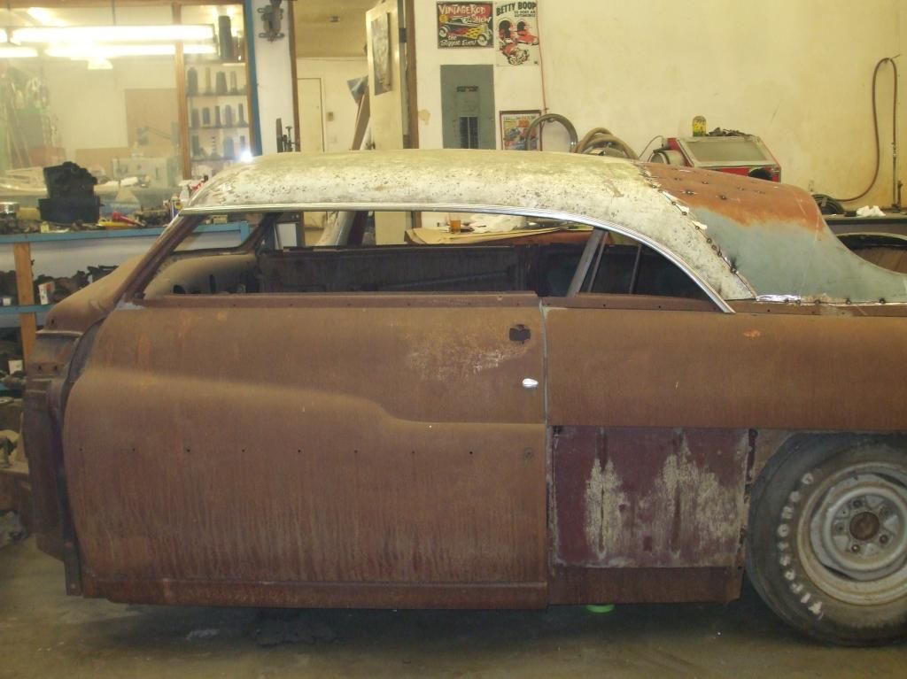

    And we have a winner,,, ME! I listened to you guys and my feeling was to go with a convertible,,, and that might still happen because I know where there is another merc sans roof, however with this project I wanted to do the one with the most cool factor and the majority of you went with the hardtop. I started last friday and spent today on it and here are some pics, I still have a lot of welding to do but this is it.
  13. desotot
    Joined: Jan 29, 2008
    Posts: 2,049
    desotot
    Here is a pic of the p***enger side with the uncut 56 Olds stainless drip rail, and the second pic is the drivers side with the drip rail trimmed long.

    Those are great pics Mo, especially the Hiohata merc. I will be going with flat gl*** and using a center post.
    I got most of the welding done on the roof today, yesterday I made the engine mounts and rear crossmember, then I stripped the frame and put it on the trailer so I can drop it of at the sandblasters. Unfotunately it looks like I will have to make a set of headers as the engine is to wide to accept any cast iron exhaust manifolds.

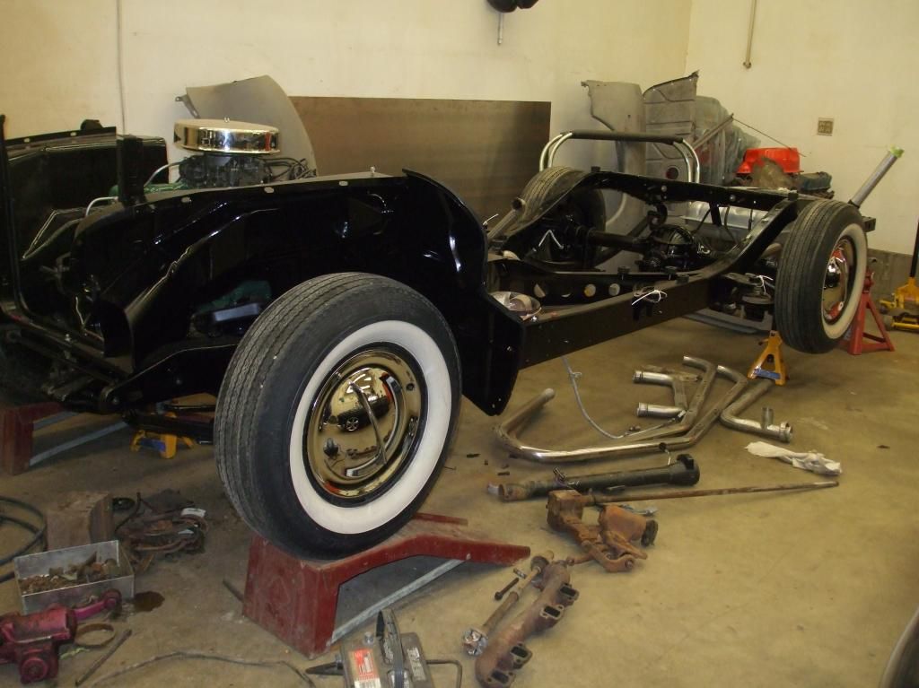

    Hey! I tend to get a little crazy busy this time of the year , working on getting other peoples stuff on the road, as well as spending time at the lake and my youngest kid getting married this summer as well as my other kids taking advantage of my time and working on the houseboat etc etc. However, I did get the frame and sandblasted and it should be painted and ***embled this week.I also had the body blasted and chased down pinholes in the welds and some other pinholes as well. I will give more updates in a few days.

    Slowly but surely, I had to modify theoilpan and pickup tube for draglink clearance.
  26. desotot
    Posts: 2,049
    desotot
    Also, I am using a stock steering box and steering wheel but I will modify an automatic 60s ford pickup steering column to fit the merc shaft and steering wheel.
