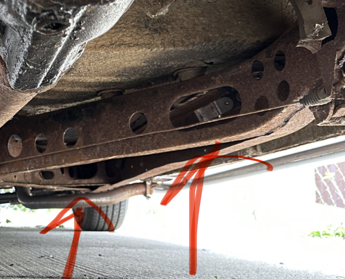

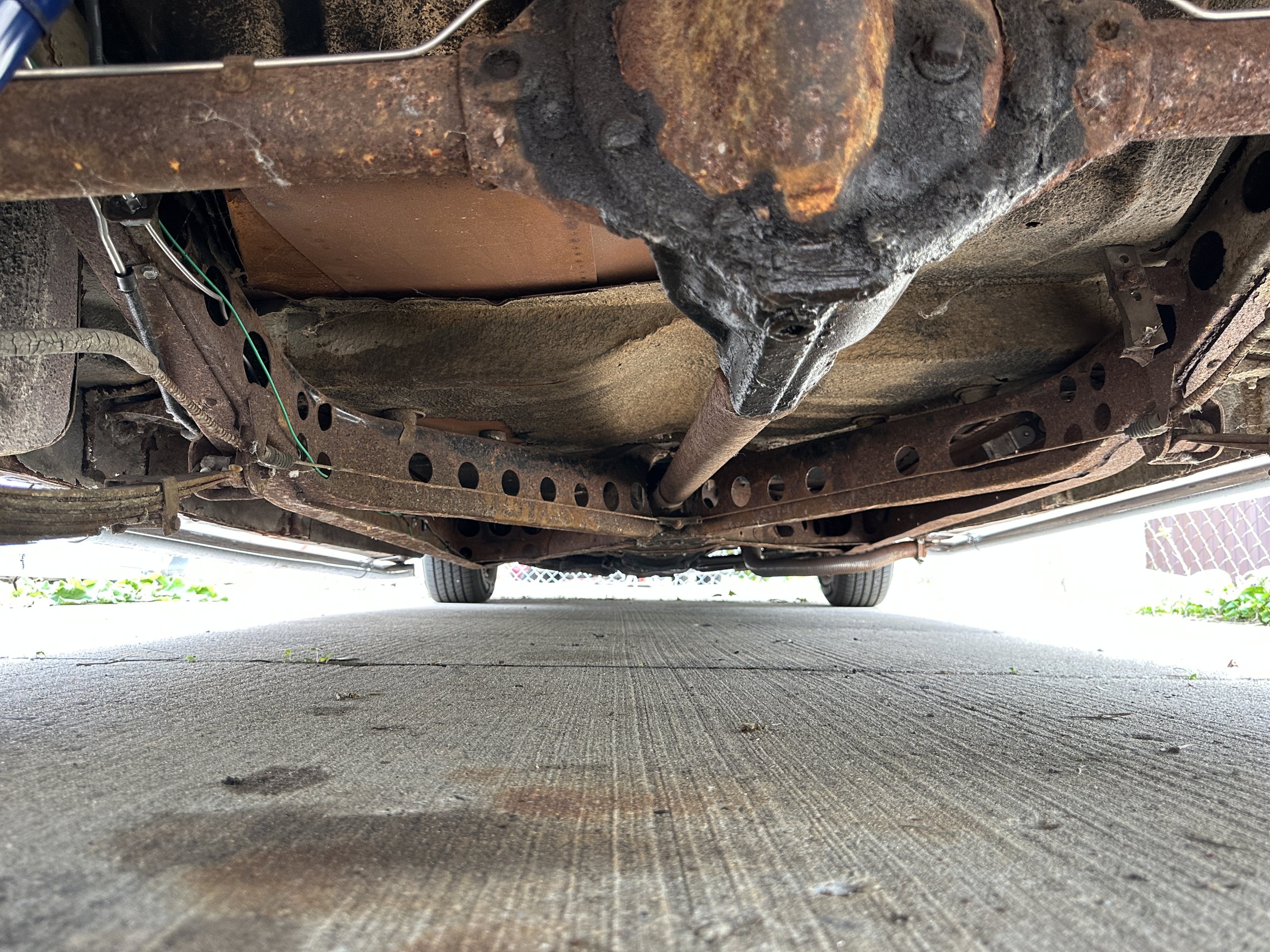

    Hey guys, looking for some good insight. I’ve been plugging away slowly at my 49 4 door. I’m quickly approaching the “it needs full exhaust” stage. The car has been lowered 4” in the rear and roughly 3” inches in the front with a set of Aerostar springs. I’ve got a set of lake pipes on it currently but have been planning to run it all the way out the back. I’m currently waiting on a set of reds headers to be delivered. However I need some insight. I plan to open up a few of the wholes in the stock cross bracing in the frame to keep the pipe tucked up higher, however I’m scratching my head on fuel tank clearance. The tank is offset to the drivers side of the car to compensate for the spare tire well. I still want the tank to be serviceable but I don’t want the tips to be pushed all the way to the outside of the body but I also need to ensure clearance with the ground with the car being lowered. Also entering splitting the pipes off to keep the lake pipes. IMG_7605.jpeg IMG_7638.jpeg IMG_7438.jpeg
    you make these oval holes on the other side.
    Exhaust runs thru the frame
    Make the tailpipes unbolt if worried about the tank
    Truckdoctor Andy and winduptoy like this.

    It’s not much, I can’t even get my floor jack under the car. I suppose the big thing I’m worried about is driveways. The lake pipes drag backing into the driveway here at the house

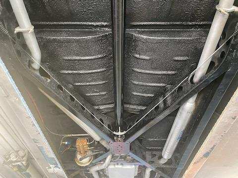

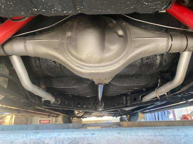

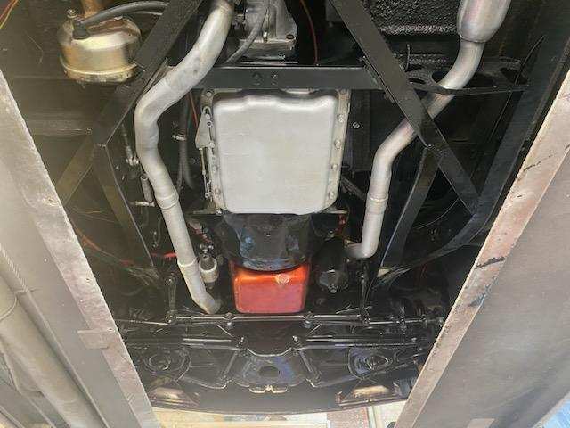

    Here's mine, front to back. Hope this helps.
    IMG_3318.jpg IMG_3317.jpg IMG_3316.jpg IMG_3315(1).jpg IMG_3314.jpg IMG_3307.jpg

  9. 2devilles
    Joined: Jul 16, 2021
    Posts: 882
    2devilles
    Not at all, or at least they're close enough that it isn't noticeable to me or anyone else. If one was waaaay back and the other was in front, sure, but these aren't that much different on a mellow Nailhead....I think the fact the tailpipes are close in length from the end of the mufflers matters a lot more than whatever is ahead of them....I've got an F100 that the driver's side is about 5 feet longer in length than the p***enger side (both pipes have to run down the p***enger side since the gas tank is on the driver's side, so the driver side leaves the header, crosses over to the p***enger side, then down the p***enger side, then crosses back over to the driver side for the exit), and on that there's some difference for sure, but it's loud enough nobody notices it but me when it's bouncing off of buildings.
    lostn51 and winduptoy like this.
