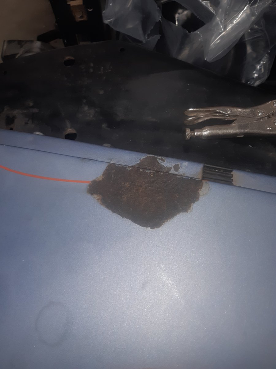

    New outter rockers with out fixing the inner jams .I guess they figured the sill plates will hide it lol.. all in all shes still pretty solid... Screenshot_20201204-073337_Instagram.jpg

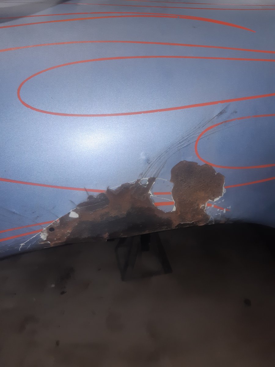

    Probably wasn't surface rust when applied but filler will absorb water so once there is a spot where water can get to it everything underneath will rust as it will just keep ****ing in water until it is saturated.

    I have been doing body work all my life, I have seen and TON of nasty body jobs, and on this merc I can guarentee that they mudded right over the surface rust... lol....

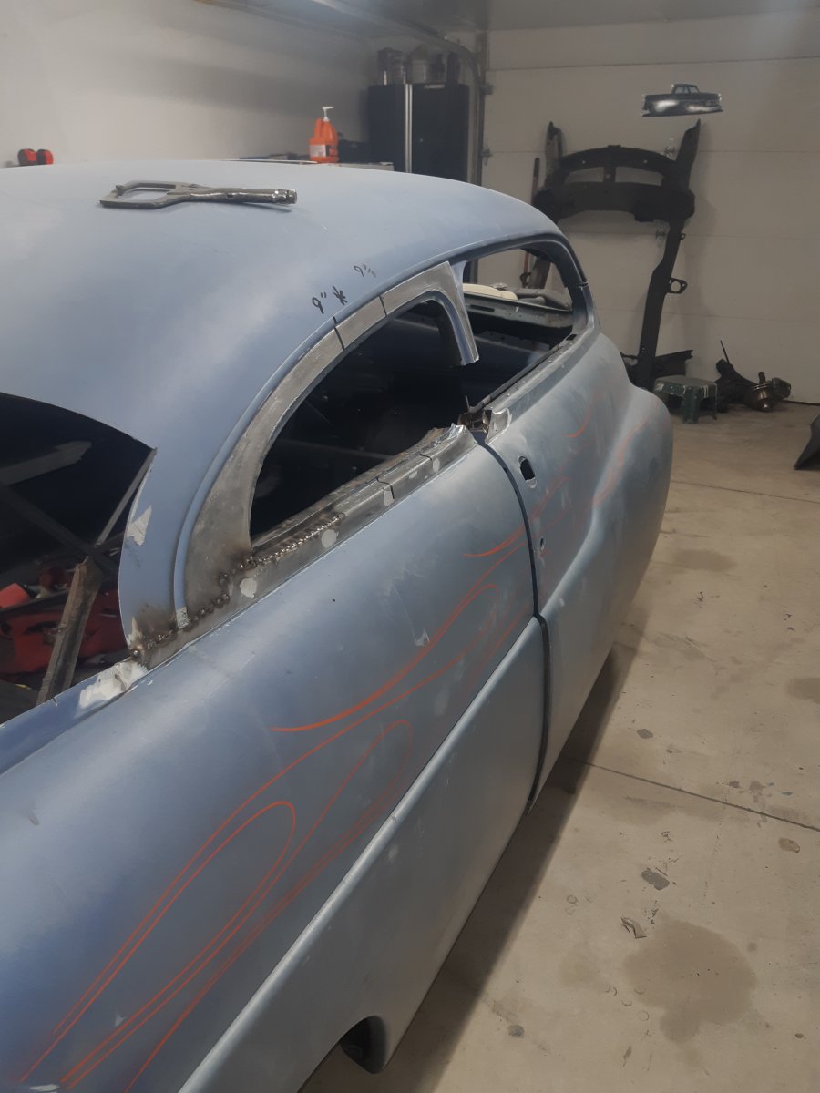

    20201209_202555.jpg 20201209_202605.jpg A little progress. Slowly but surely.... i still have to reshape the rear corner of the window, I am sure you guys have seen a 100 merc chops posted on here..

    Nice work. I have had both a chopped version and now a stock 51' Mercury, I like seeing both. I'm just not seeing a chopped Merc in my future. No matter which way you go? The Mercury has great lines. My $0.02

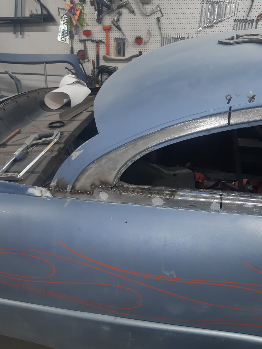

    Just a little progress tonight.. I rounded the rear corner of the quarter window. I was debating whether or not to leave it in a point at the rear corner, but after much thought i will round all the corners out on the old girl . 20201210_191217.jpg 20201210_194615.jpg
  26. chad
    Joined: Jun 22, 2004
    Posts: 1,012
    chad
    I am just winging it lol

    Repeat performance of last night..just on the opposite side... 20201211_183819.jpg 20201211_185917.jpg

    Got the drivers side B pillar sorted out made the new corner radius.. 20201212_175828.jpg 20201212_182613.jpg 20201212_182606.jpg 20201212_182613.jpg 20201212_175828.jpg 20201212_182606.jpg 20201212_182613.jpg 20201212_183134.jpg 20201212_184938.jpg 20201212_190619.jpg 20201212_193654.jpg 20201212_200049.jpg
