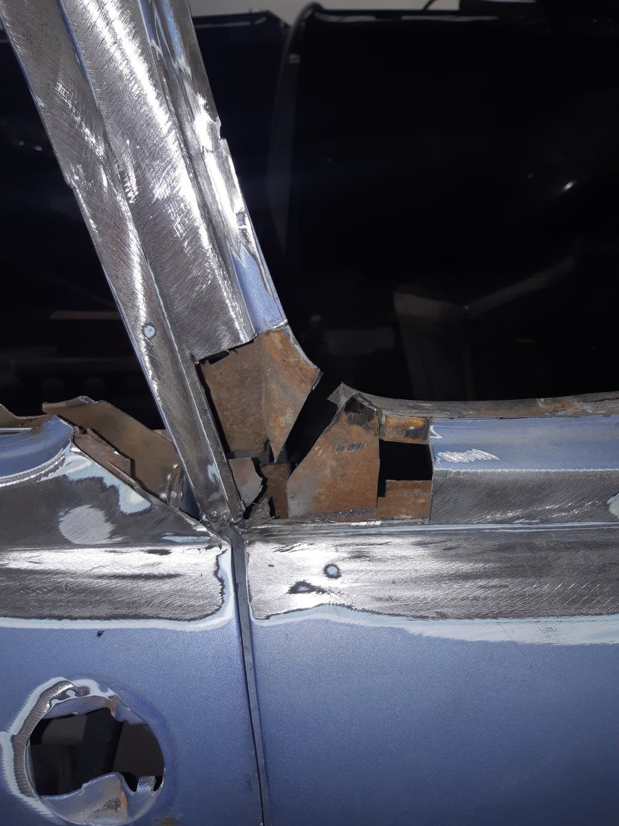

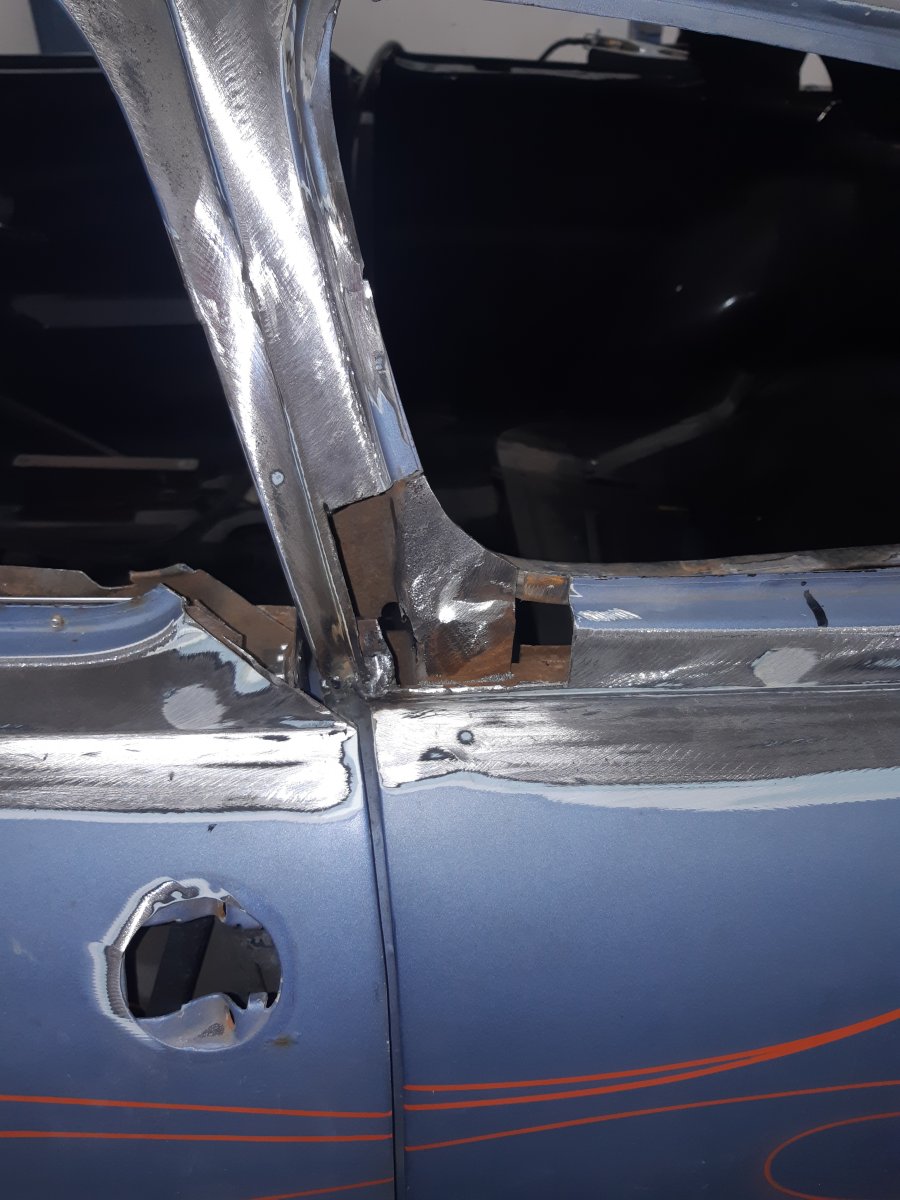

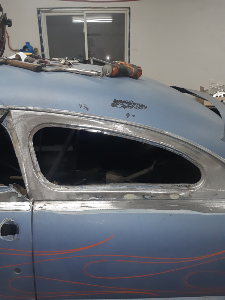

    20201214_193522.jpg 20201214_193518.jpg Got the rear quarter window done... I am really happy with the shape and how it turned out... i wont bore you guys with how i did it.. My last post basically shows how i did it, so there's no need to repost it lol

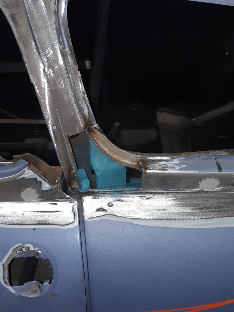

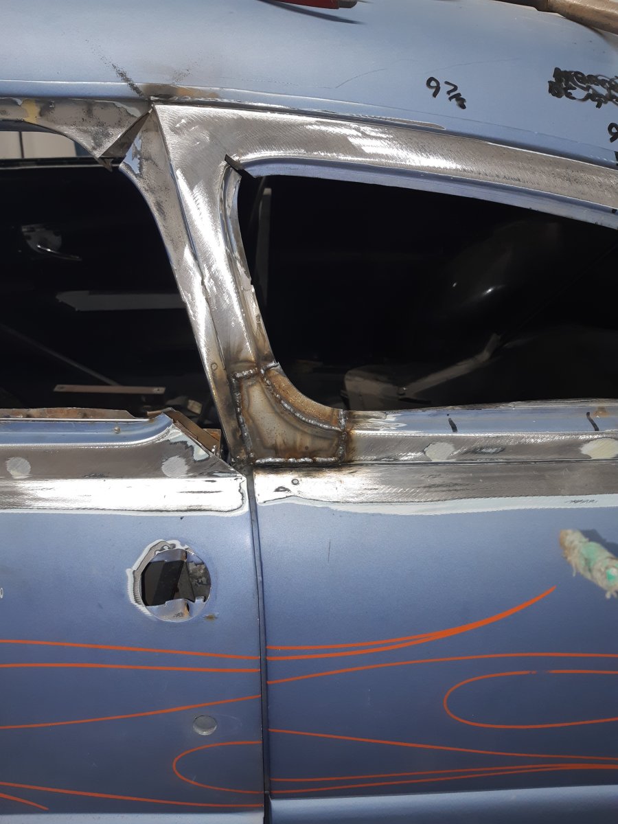

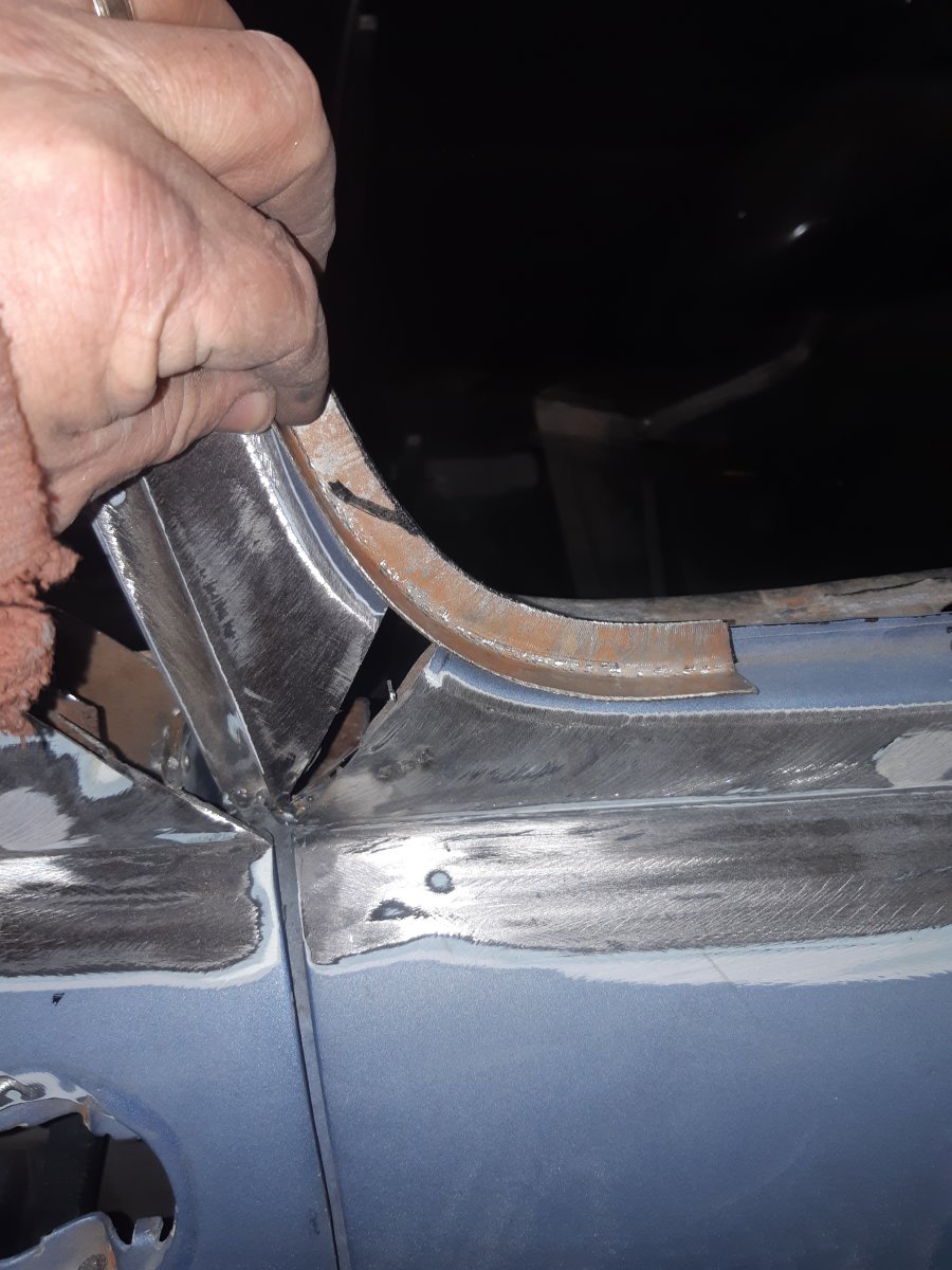

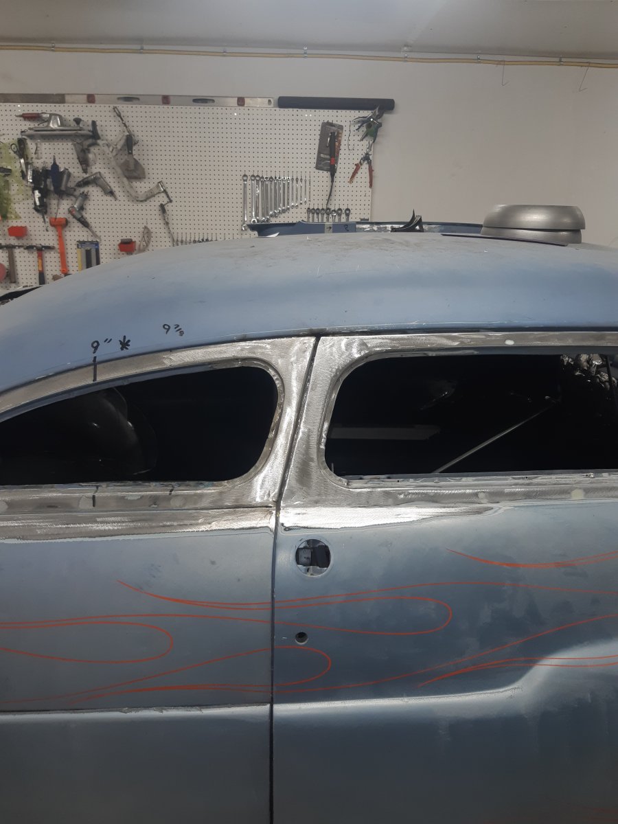

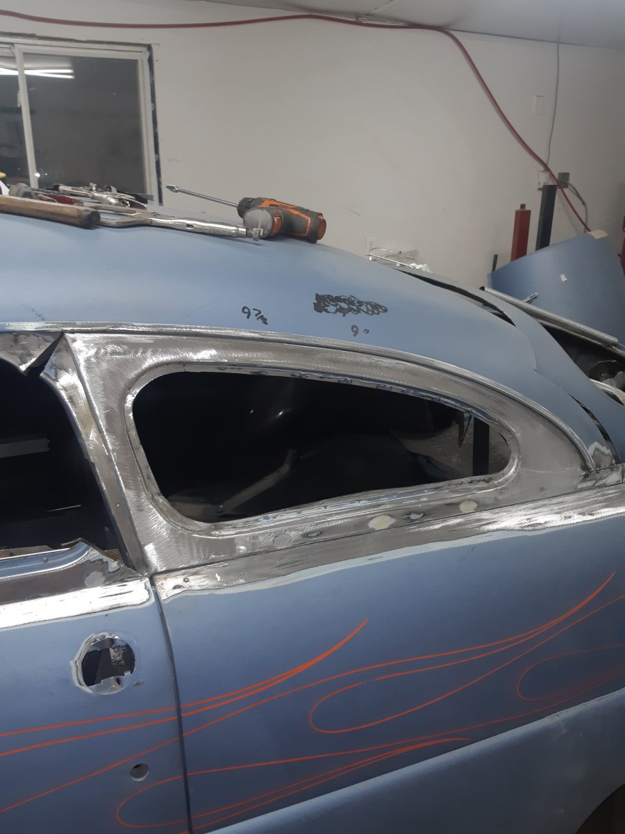

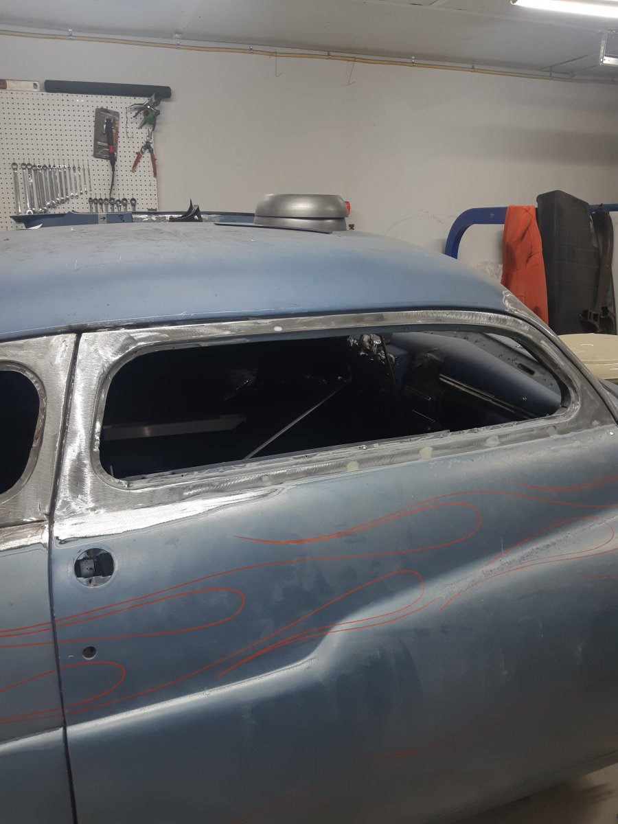

    Just a small update for those who are following along on my first attempt to build a custom...The p***enger door is finished on the outside... i have reshaped every window corner on this thing.... The lower rear quarter window radius matches the door top radius and the upper rear quarter window radius matches the lower door rear window radius... if that makes any sense lol... I think it looks uniform now.. something very subtle that nobody will ever notice... 20210101_213326.jpg 20210101_213334.jpg

    Is that 4" vertical height, or 4" out of the A pillars?
  8. chad
    Joined: Jun 22, 2004
    Posts: 1,012
    chad
    4" out of the A pillar and almost 5"
    in the rear

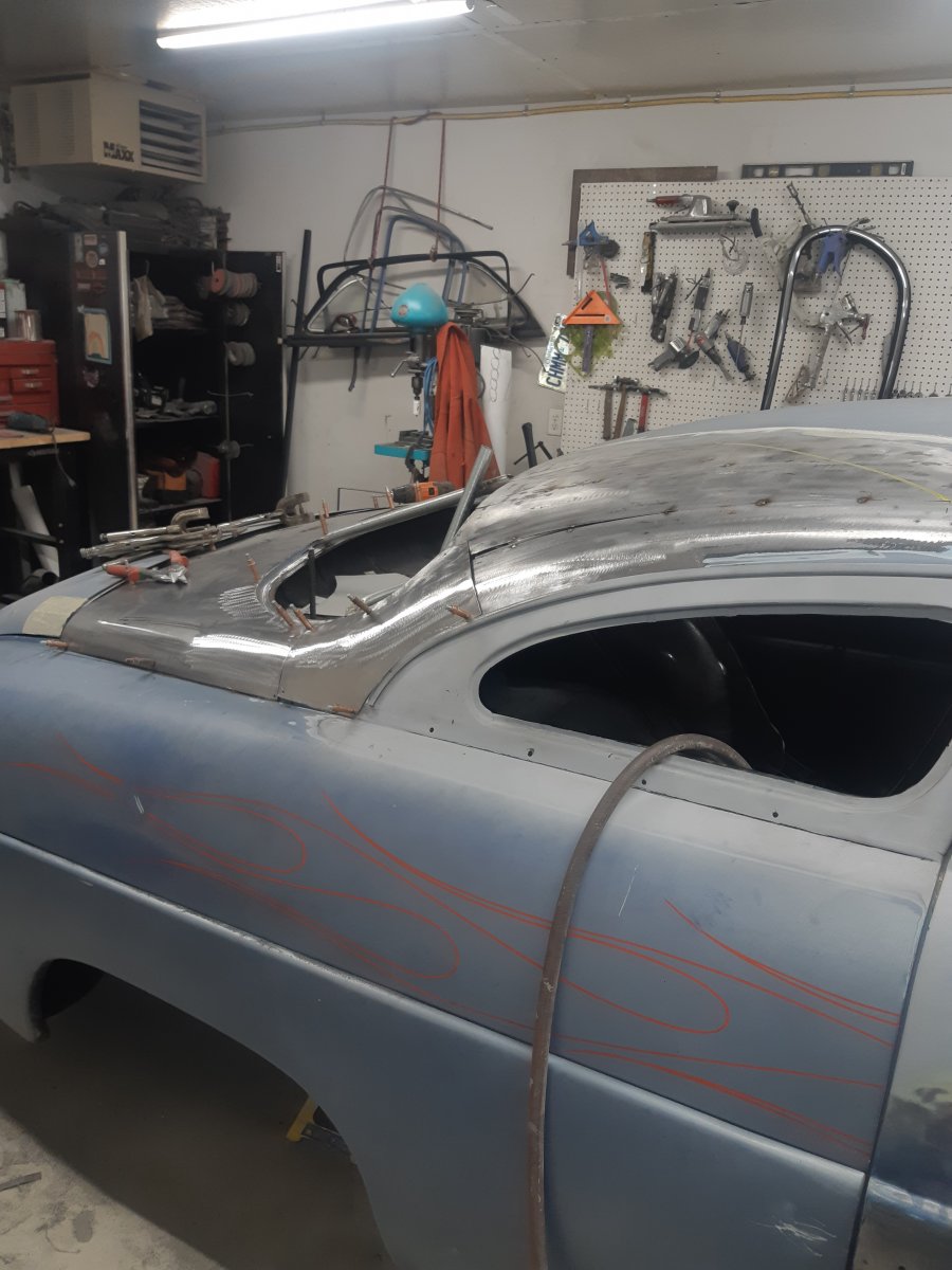

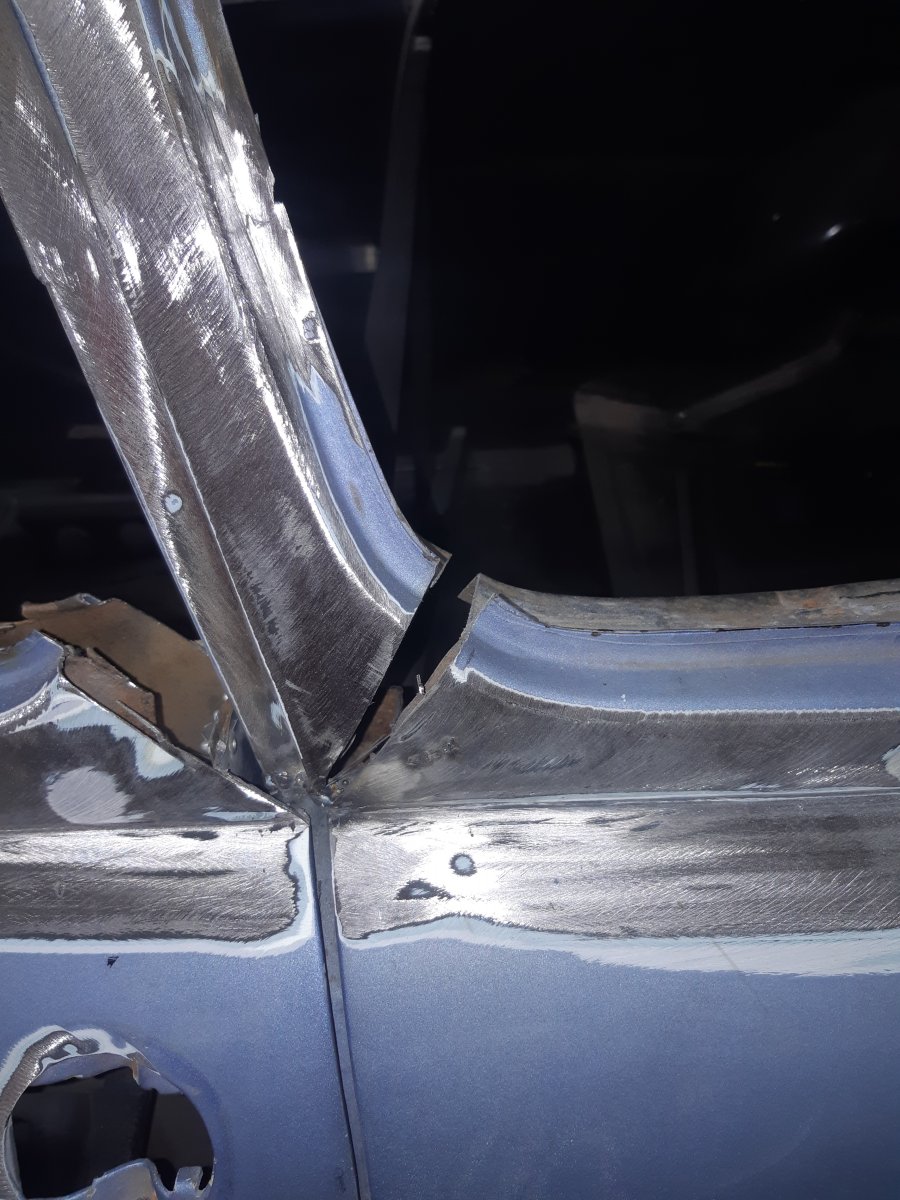

    Its been a whike since i posted any progress pics, got the p***enger top finished and then got into the bottom of it, there was some really crude body work done . The door was caved right in and they just slathered it with mud. So i had to break out the pin welder, pull it, hammer dolly shrink and repeat... its pretty close now, 1 more round should get it.

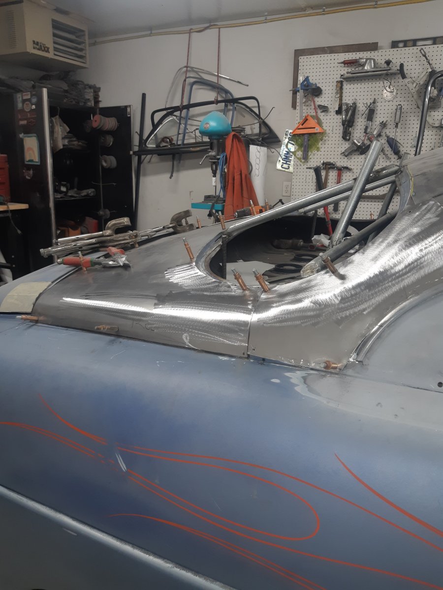

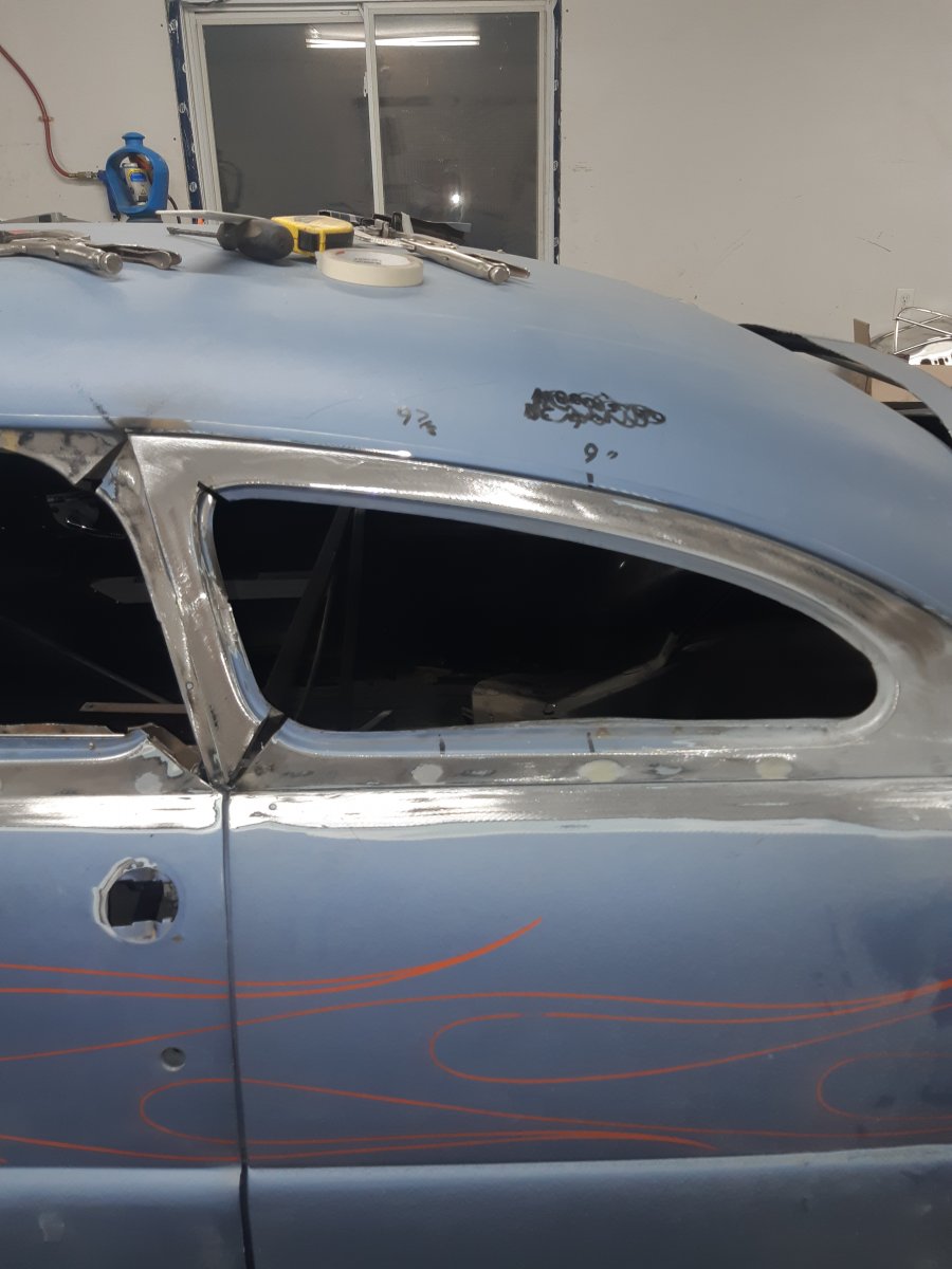

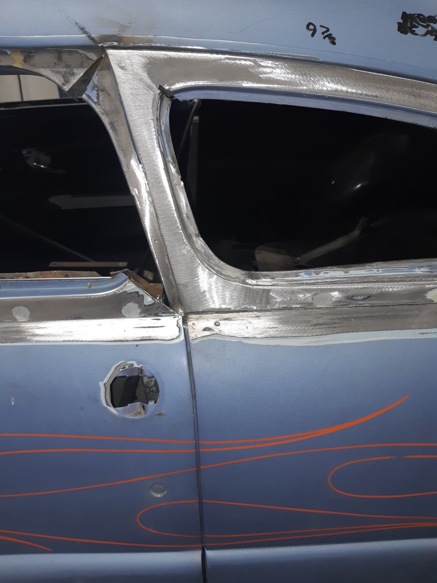

    Then i started the back window.. the part i was dreading the most... i feel a little better now that its all roughed in...
