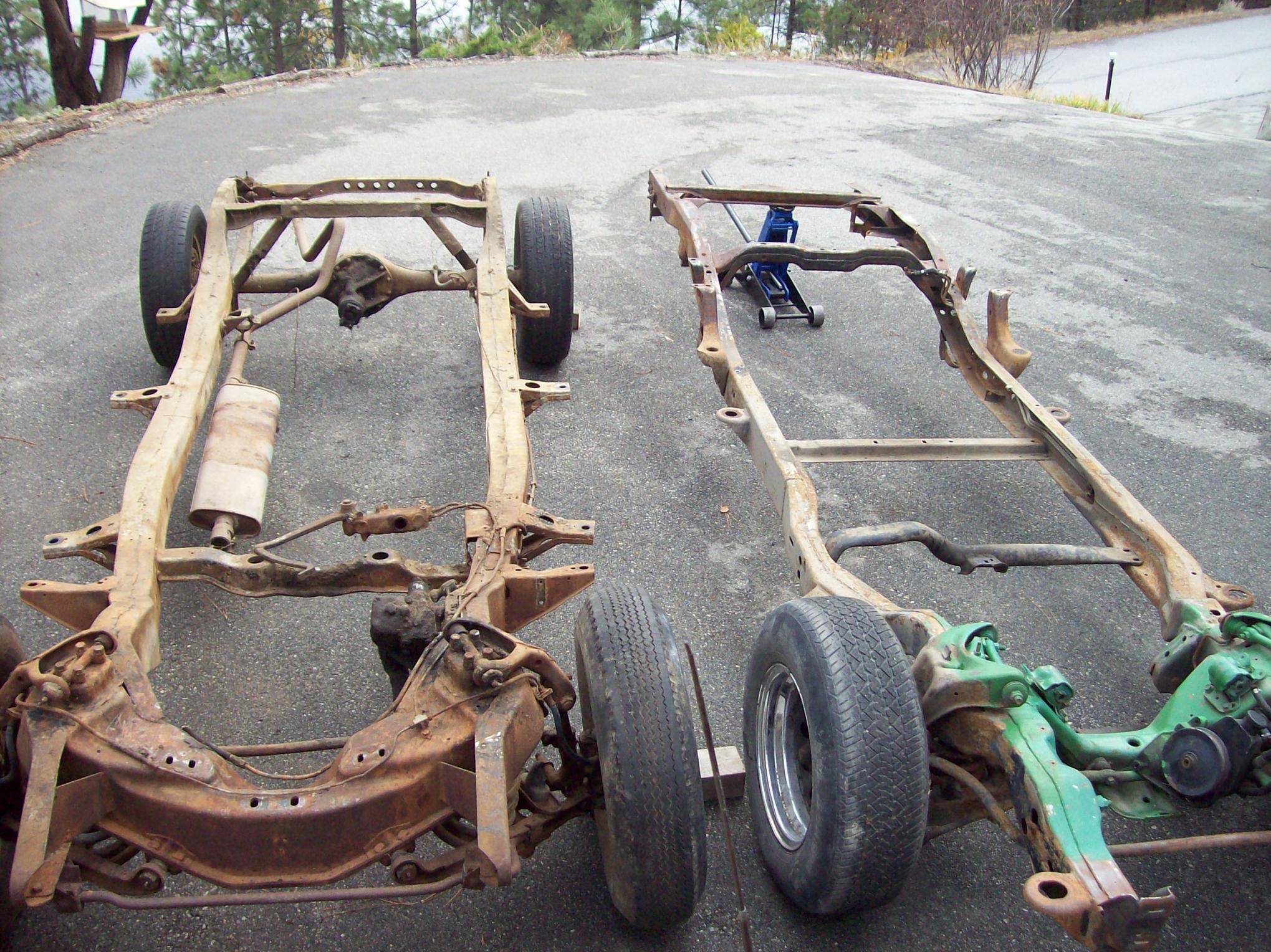

    Picked this car up last month and has been falling together. Started with not knowing what to do with the stock frame and running gear. The flathead is done and will never be anything but recycled metal. As for the rest of it, I want something rleiable that my wife and kids can take to the store or out on the highway with some reliability. The drum breaks are finnished, kingpins have wear and it all just seemed like too much work for nothing so I decided to clip it. After looking and reading all I found was that the S10 was the way to go and on the hunt I went. Last week I found a 92 S10 Sonoma rolling chassie and gave the man the $100 asking price for the rolling chassie.
    After I got it home I started cleaning it up with removing things that were not needed and found that it already has drop spindles and lowering springs in it! Nice! He even rolled a real axle under it with no springs so that was a bonus for me. I want to end up on airbags so this chassie is perfect for me and I am going to fab a 4-link in the rear and on some coil springs for now to get it on the road.

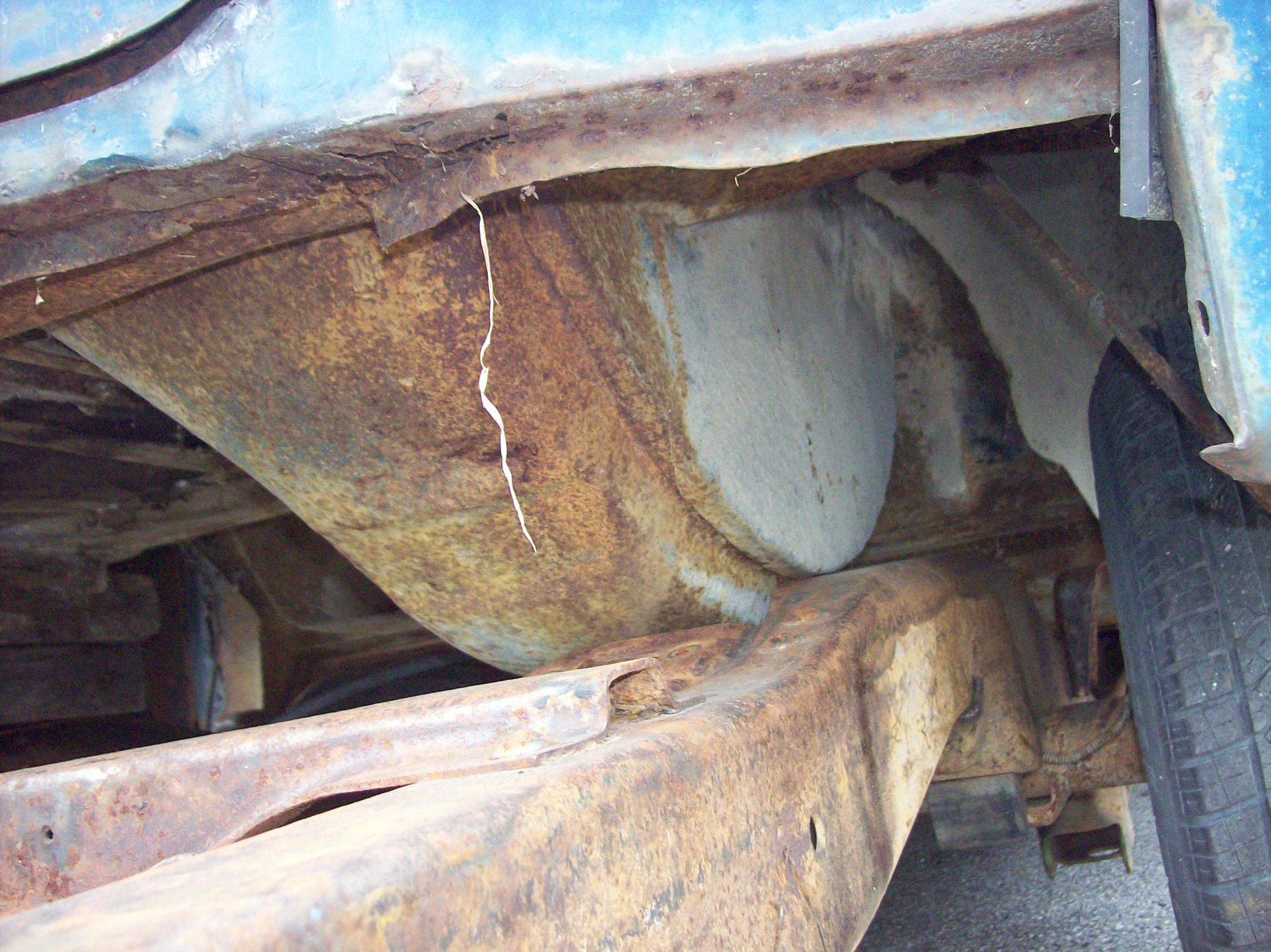

    I now have the stock frame out from under the car and the new one under it and have found the spare tire is going to have to be removed from the trunck. After this is done, today I hope, I will be able to start installing the body mounts under on the frame. I have removed all of the stock mounts off the orignal frame and am going to reuse them if possable on the S10 frame.

    Yes, the car had only seen weather for atleast the last 30 years so I gave it a bath and found some blue paint under the dust. lol Love how it looks and hope to keep it's look just like this for along time.
