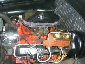

    Before I go and buy doors for my '49, whats the interchangability between the different models of '49 Pontiacs? Does the model screw up the ability to swap parts with a Chebby? Is there anywhere that carries body panels for it? And, is the wide strip of metal that runs up the middle of the hood and trunk stainless or ? Its been painted over and Id like to bring it back out. We picked this one up not too long ago, were going to be retro-fitting it to a 50's/60's style rod. It came with pleunty of 80's streetrod crap - Crap edelbrick chrome, a 10 pound billet air cleaner, crap 80`s camaro console, 90's sunpro gauges, power leather bucket seats and a big honkin 455 Olds shoehorned into the engine compartment. Its allll gotta go! (well, maybe Ill keep the 455 :D) Thanks!

    Thaks for the info! So unless I find a 49 Pontiac/Chevy Fastback door Ill be working with what I have, it looks like. I can dig it. How about the radiator? The stock radiator is trying to cool a 455 and it aint working out too damned well. From what I see, its alot easier to get a good aluminum 49 Chevy radiator than it is a Pontiac. Thanks again.
