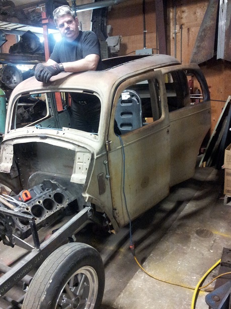

    It's been far too long between updates but the truth be told... we have been neglecting the ugly little beast for the last few months. Well... we're back at it. Mostly t******* ugly stuff off and fixing rust on the center posts but we have also been designing the center steer seat position and the roll cage.
    Big problem with center steer. The rule book states if the driveshaft runs under any part of the driver... it needs to be fully enclosed in 1/8" steel.
    Since this is really a period statement and for our own ****s and giggles, we went over kill. The floor pan mounted between the frame rails is damn near battleship caliber at 3/16" but it gives us a solid foundation to mount the seat and belts, some really good frame structure and some extra protection in case the driveshaft decides to try and mate with one of us while driving. The plan is to build the 1/8" tunnel under this plate. Obviously it will have to be removable and notched to allow the locator bar to travel inside it. If done right, the mounting bolts will double as seat mounts. It's going to be a bit heavy but the wieght is where we want it, down the middle and low.
    That's my brother Paul doing the required "Vroom Vroom" session and showing off the really big "escape hatch". The distinguished guy in the window is our friend Larry. (Top dragster and 10 second off topic Mustang)
    We're going with a funnycar style cage and have started bending the bars for it. There will be a perimeter bar that runs from the frame - around the driver - and back to the frame. The overhead bars will be squared off rather than tapered simply because it's easier to bend them that way and we have limited skill on the bender. In the end it should look a lot like an old school funny car with a square style perimeter cage. (Pictures of the cage coming soon)

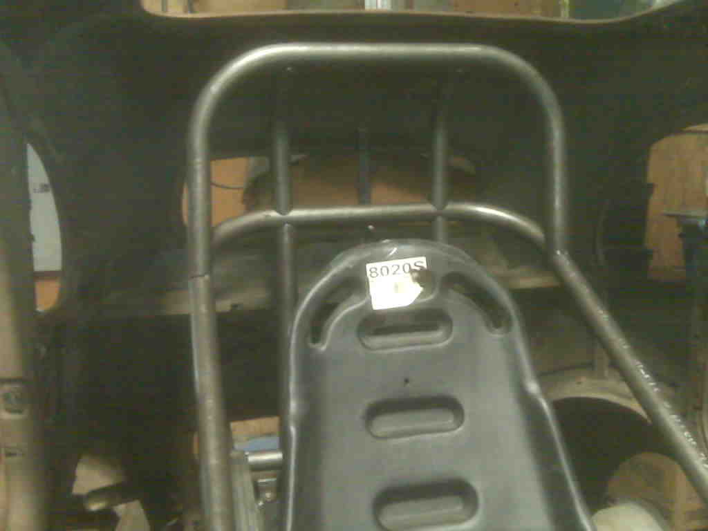

    Here's the start of the cage. As I mentioned, we're going wide and without a taper. Just trying to stay within our talent range. Besides, both my brother and I have wide shoulders and not that young any more so the wider the better (Easier to get in and out). We'll move the center bars closer and the lower bars will be angled outward to the framerails for more strength. We'll also triangulate the side bars along the shoulder hoop. This might be a bit of overkill especially for a car that might, on a good day, see the high side of the 9 second range... but we think it's cool. And that's what counts.
    The seat isn't mounted in the picture but it will be moved back and reclined quite a bit. We'll mount a headrest off of the back bars.
    We've also bent up the front bar and tacked it in but it looks goofy without the other bars. Once we have it a bit farther along I'll post more pics

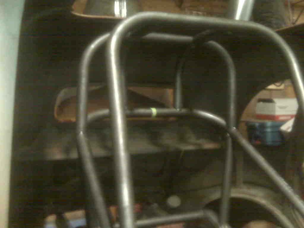

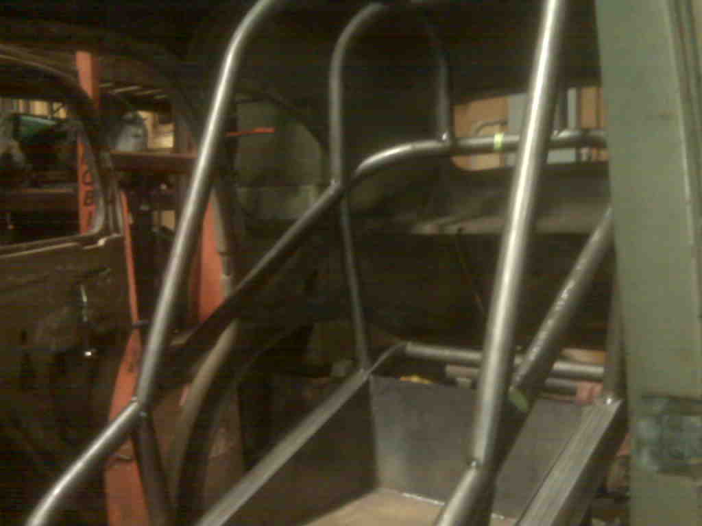

    This should give y'all a better idea of what we are trying to do.
    We got the front hoop and the bars between the hoops tacked in and re-did the rear supports. We also tacked in the side supports to the frame. We'll add in 2 more at the back to support the rear of the cage and we'll triangulate the side supports. We'll also add in some halo bars. Serious overkill for a door car that will likely be kept in the low 10's but we like how it's all coming together.
    Not too bad for a couple of hacks.

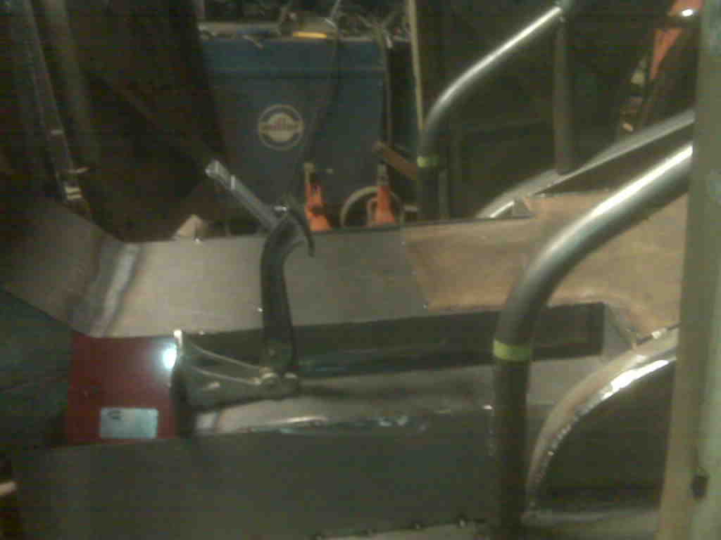

    We've been banging away on the prefect but it's not in any state to share any pictures at the moment.
    We started to mock up the steering and we are trying to figure out the best place to put it while at the same time keeping in mind that the primary drivers are a couple of broken 50 something guys who don't bend and twist very well anymore.
    We have added in some of the flooring. We decided the outside panels from the the frame rails to the body needed to be beefy so we've gone with some heavy gauge steel. It's overkill and adds even more weight but I support the idea since it will add some integrity to the body as well as give us somewhere to step trying to get in / out. It also eliminates the need for a framework for support under a thinner floor material.
    Rather than building wheel tubs, we've decided to build a bulkhead dividing the driving area from the back of the car. We'll have to see what plays out for tire shielding in the back but for now we're not too concerned about it as long as the driving area is sealed and seperated. So far, the interior build is starting to look like an old school funny which we think is very cool

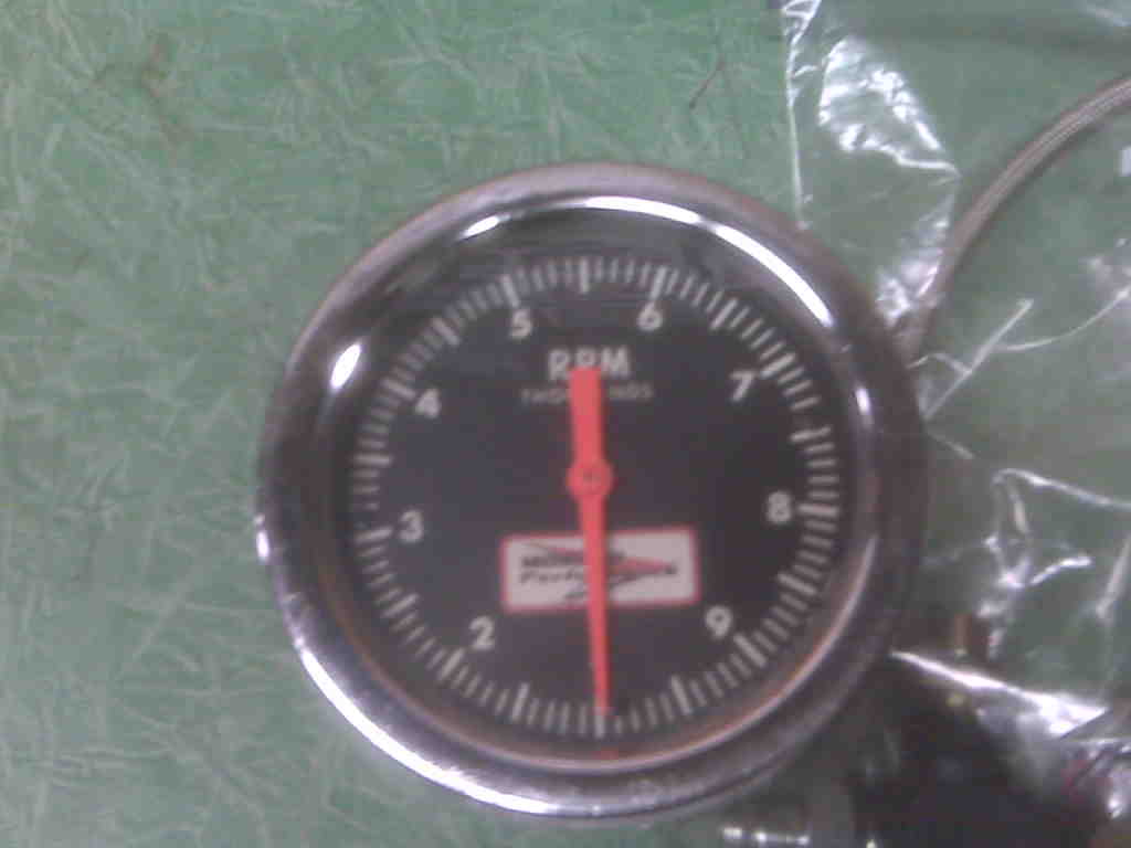

    Here are some pics of the fun stuff we received a while back and pulled out this weekend. An old school style mechanical tach as well as a priming system for the fuel injection and a Phasing unit for the magneto we'll be running

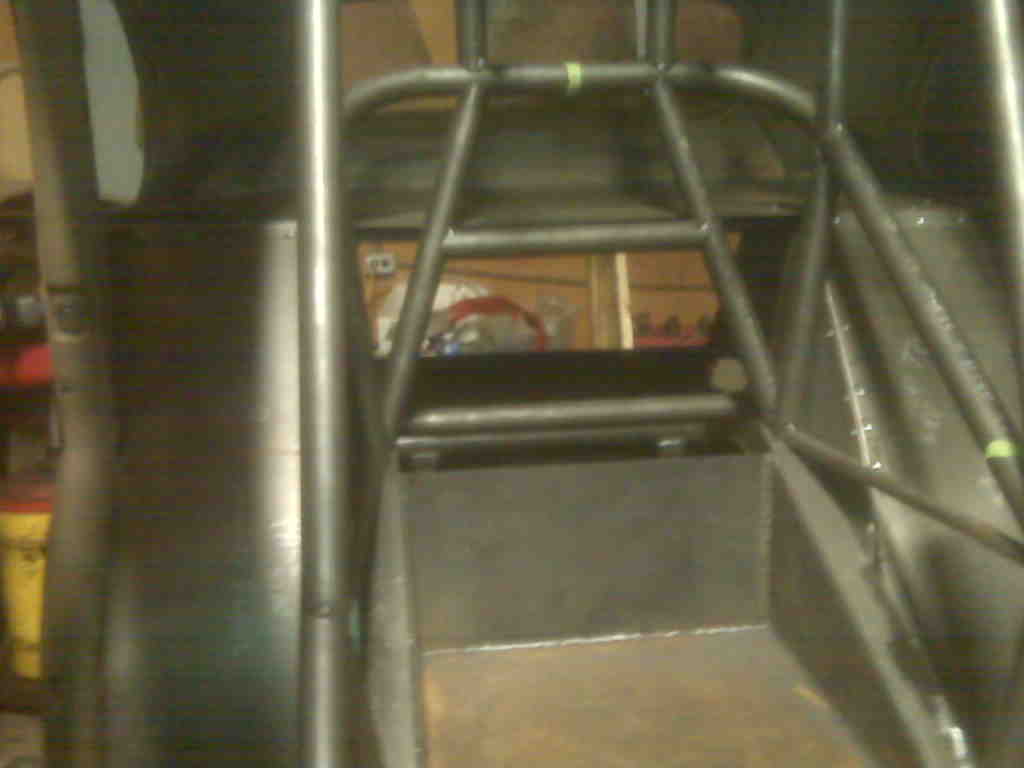

  22. Saxxon
    Joined: Dec 14, 2008
    Posts: 1,835
    Saxxon
    Still banging away on the Ugly Beast.
    We started to put in actual tubs but we hated it and tore it all out. With my limited sheetmetal skills I somehow managed to cobble together the rear bulkheads and wheel "tubs". We'll fill in the backside as well. The rear of the car will be open to the elements with only a battery box / battery in the back. Not sure what we'll do about shielding for the flying rubber in the trunk area...maybe nothing...just have to make it up as we go along.
    For now it's all held together with poor man Kleco fasteners...that would be sheetmetal screws to you well equiped folks... once the cage is all welded in we'll go back and rivot the whole shoot'n match together.
    In the meantime, my brother is piecing together the floor pans and ****** cover. The side pic gives a good idea of the pedal placement.
    When you're learning as you go it tends to be a do and re-do kind of thing. Somehow, no matter how hard you try it still looks like a hack job. Thank god for carpet and paint.

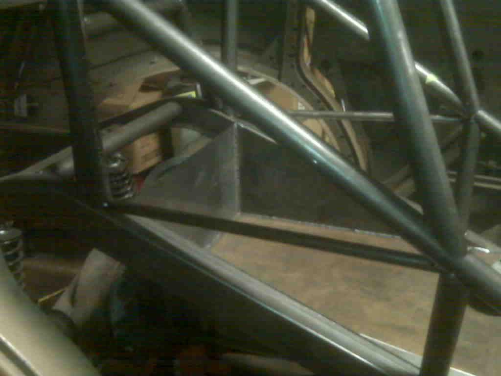

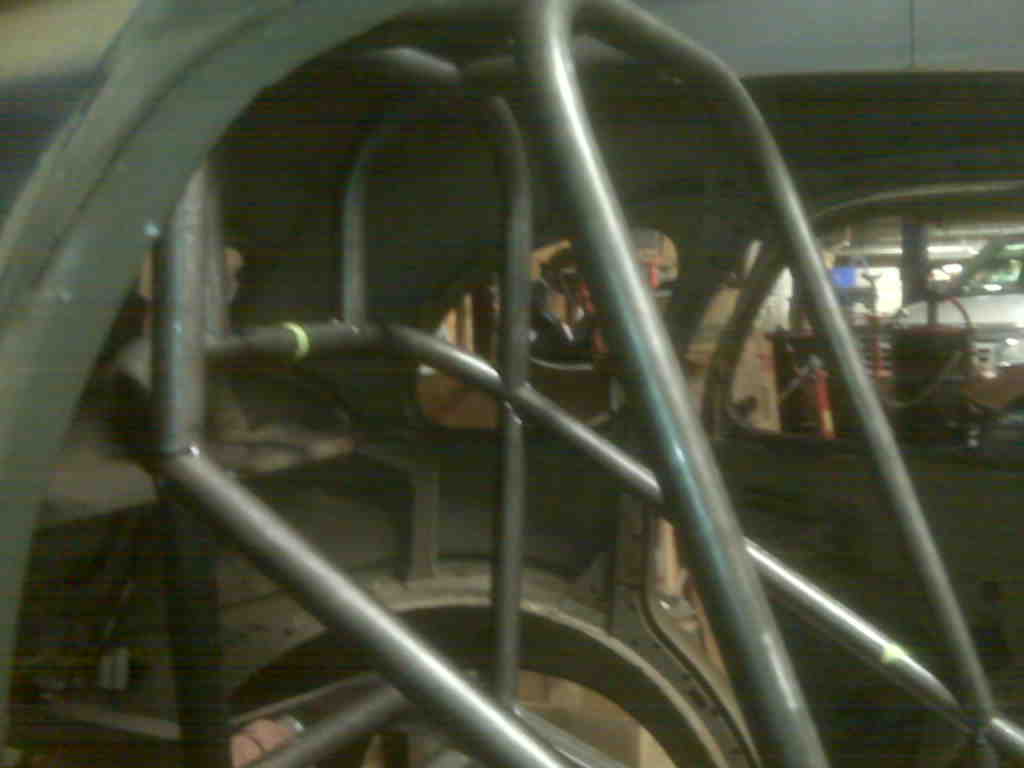

    We pulled the cage out for final welding. Pretty easy to do with a 26" wide cage and a big hole in the roof and 4 doors to duck in and out of. 3 guys, a little patience and it's on the welding table. We're adding the helmet bars while it's out.
    With the cage out it gives us the chance to finish mocking up the tin work. The pile of rework isn't too large so obviously we're getting a little better at it... or our standards are dropping. One or the other... The battery tray has been fabbed and tacked in between the rear frame rails and we're currently working on the rear part of the wheel enclosures. Just keeping it simple and following logical contours. Nothing fancy.
    Our remote fuel pump drive has arrived and we dropped it off at the engine shop. We also replaced the fuel lines on the hilborn intake as the current ones are cracked. Nothing like a quick $500 for some brackets, spacers, 8 hoses and a belt. (Ouch!). But, that should be the final pieces for the motor. There is some talk about getting a local sprint car guru to help us set it up on the dyno but nothing confirmed. We got the set up from AlkyDigger a few years back and it was already set up for alcohol so we probably wouldn't be too far off running it as it came for a baseline.
    Just before the cage goes back in we'll start to replace the sheet metal screws with rivots for the areas that will be tough to get at once the cage is in the way. We'll also start sealing everything up and then turn our attention back to the steering and the placement for the fuel cell and radiator ... and mount the seat, the shifter, the pedals, run brake lines, wire it up, fab a panhard bar, mount the driveshaft tunnel, mount the lexan (yellow of course) ... Sooo much more to do...
    Sure having fun though !! :)

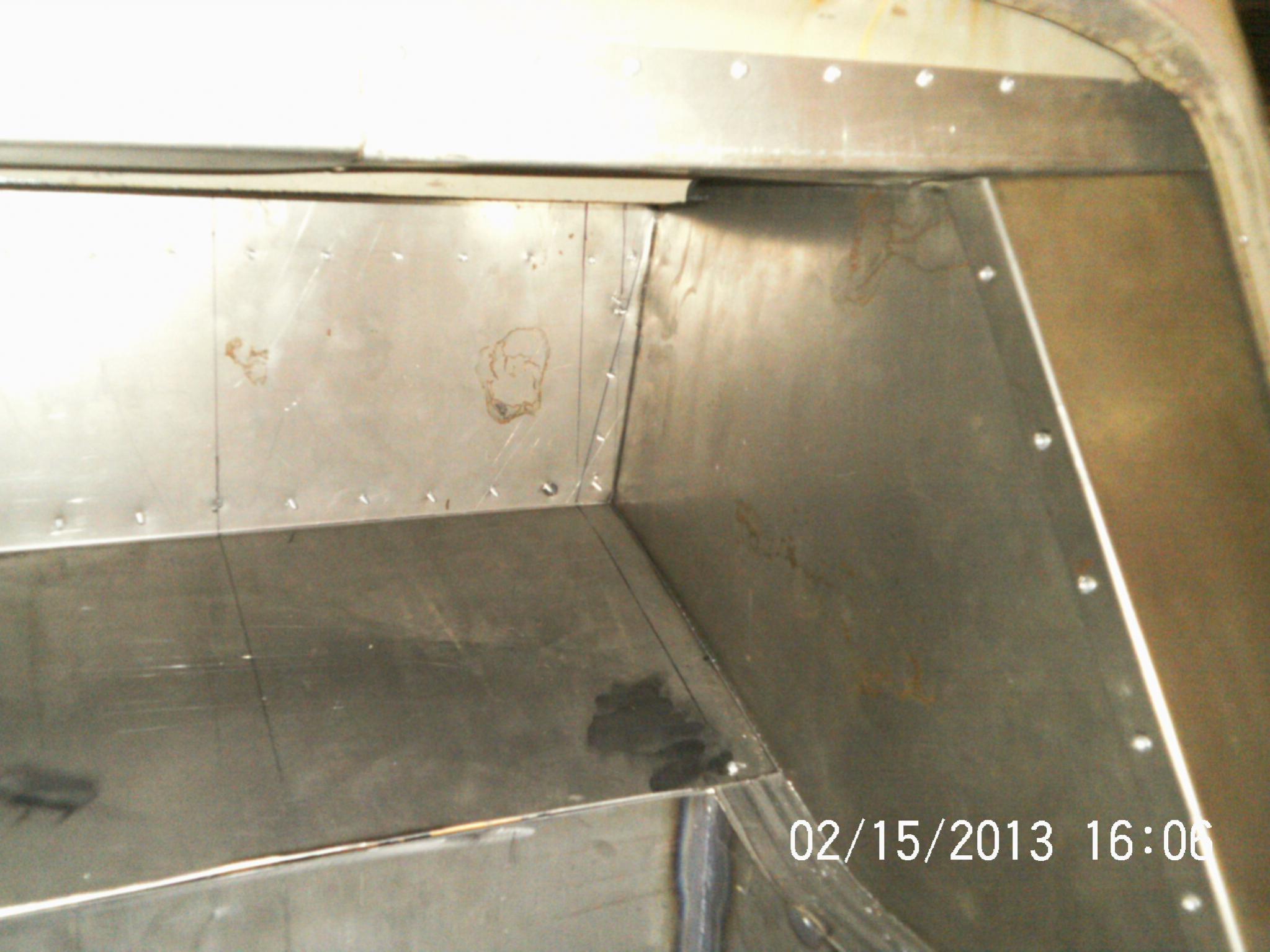

    Sheetmetal work... doesn't **** too bad if you have the right tools. And talent... Tools we have... talent...not so much.
    We spent the day riveting the rear bulkhead together but can't do the whole thing until we put the cage back in. I also spent some time closing up the trunk and welding in the battery box. So far it looks...acceptable. Nothing show worthy and the rivots aren't in perfectly straight lines but a lot of that will be covered by the paint and it is turning out a lot better than most folks thought it would.
    The whole shoot'n match is steel and needs to be cleaned and painted so sorry for the rusty spots. Oh by the way...when installing a couple of hundred rivets, an air gun quickly becomes the best tool ever made especially for my pastry soft computer hands.
    Once the cage is in we can put in the front wheel tub panels and stop fiddling with the back of the car
