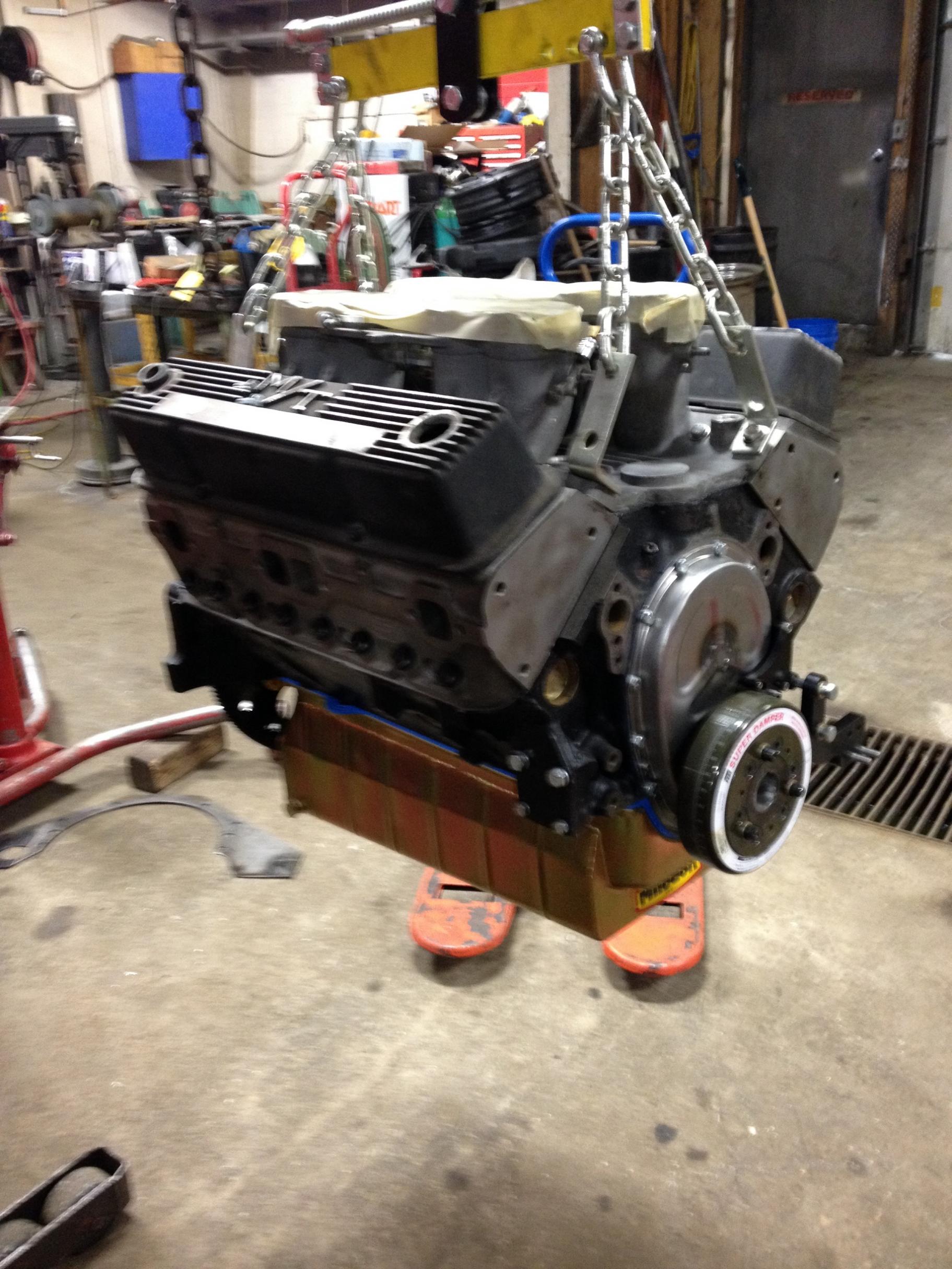

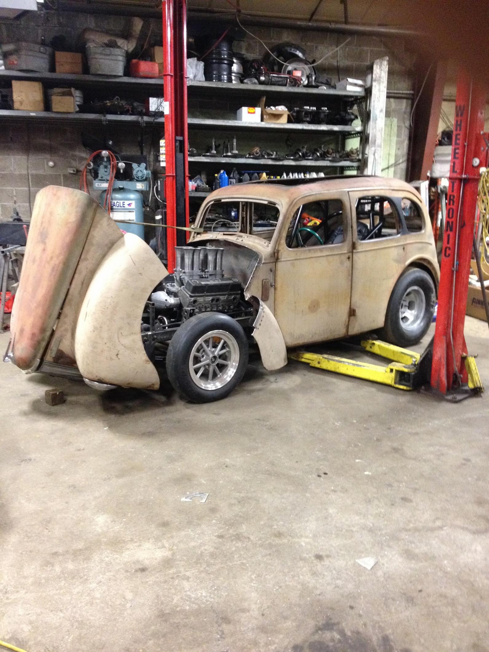

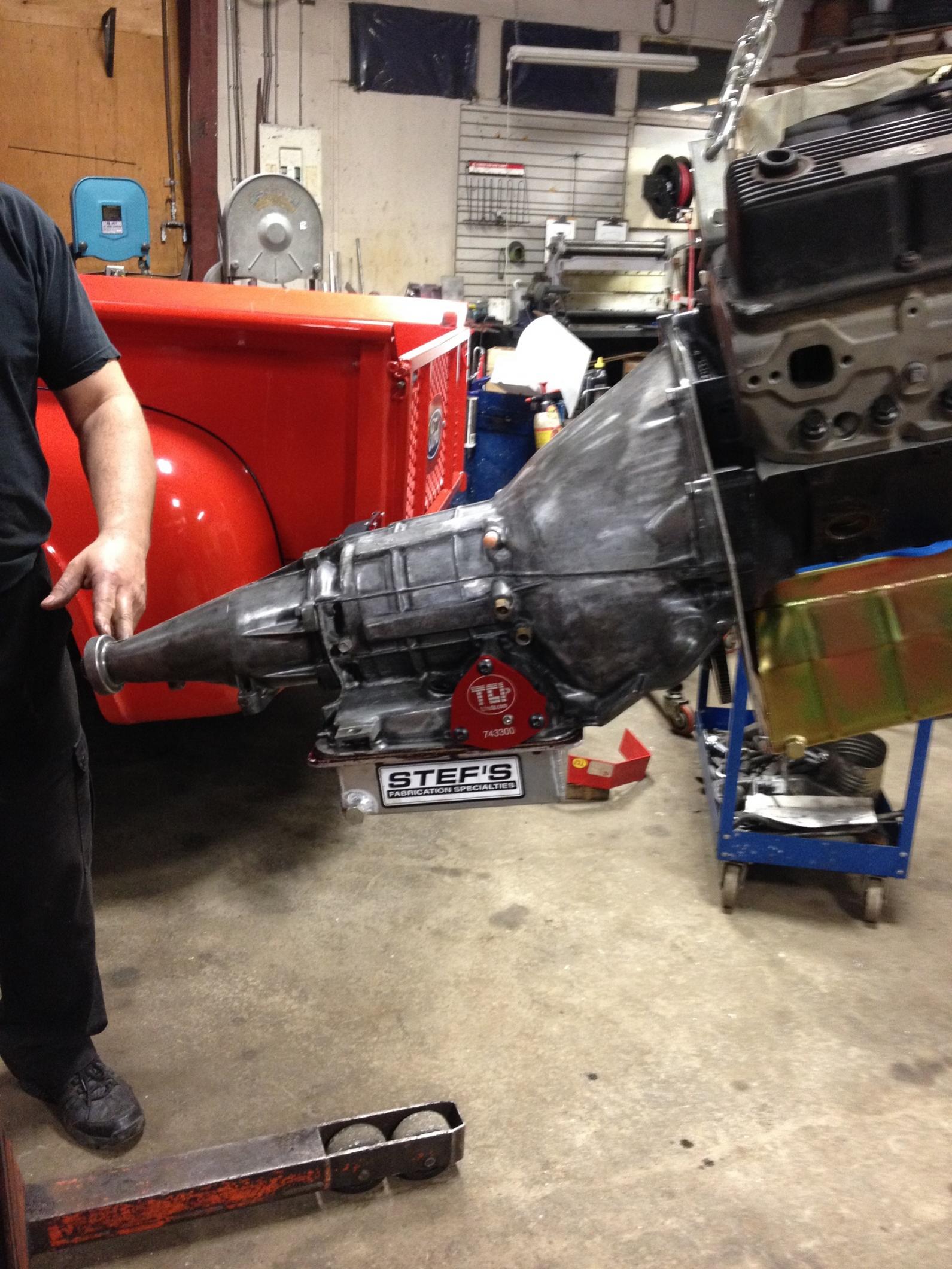

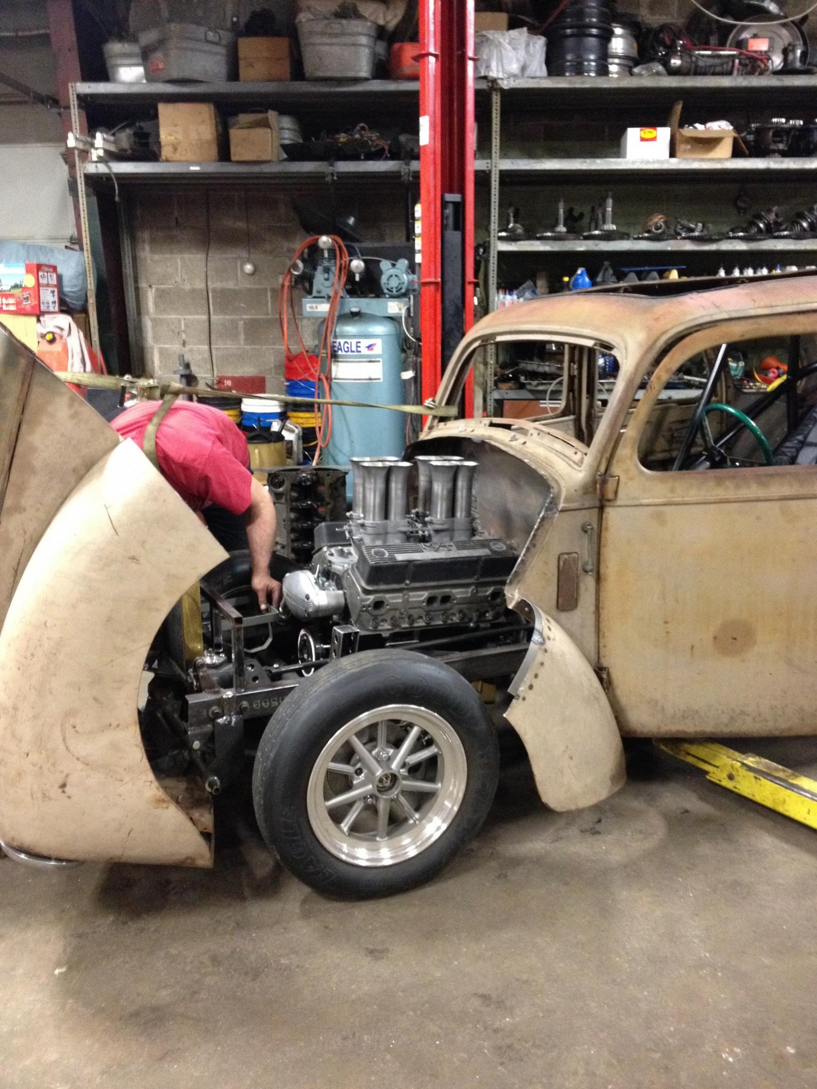

    Here are some pictures kids, we pulled the mock up motor and put in the real bullet and the fully built Powerglide, We started cutting fenders and finalizing pedal placement. We are also putting the original dash in place and we will mount the few gauges we plan on running in an aluminum insert. My brother fabricated up some simple but effective shock towers and now we are almost ready for the mind numbing process of sorting out the fuel and cooling lines, running brake lines and doing the electrical. We also have to sort out where to put the fuel pump and run the lines
    Sorry about the modern style fuel tank but it's bigger than the modern style Moon tank we have and we would rather have the capacity when running alcohol.
    Then we need to sort out the Hilborns and set up the Magneto. We plan on painting the frame and interior but we want to leave the body in it's patina glory, We also plan on leaving the roof open if they allow us. Far easier for us broken old guys to get in and out

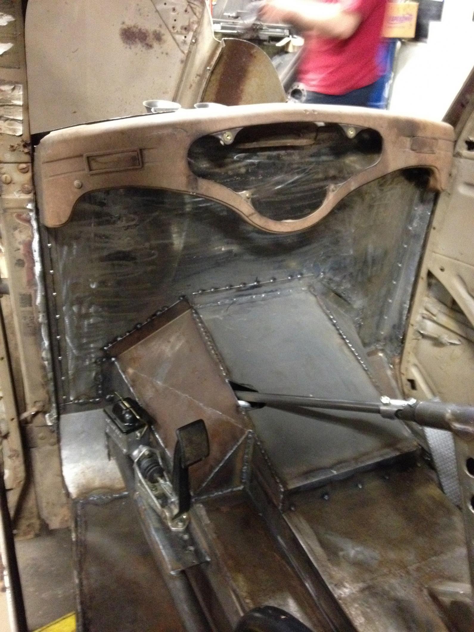

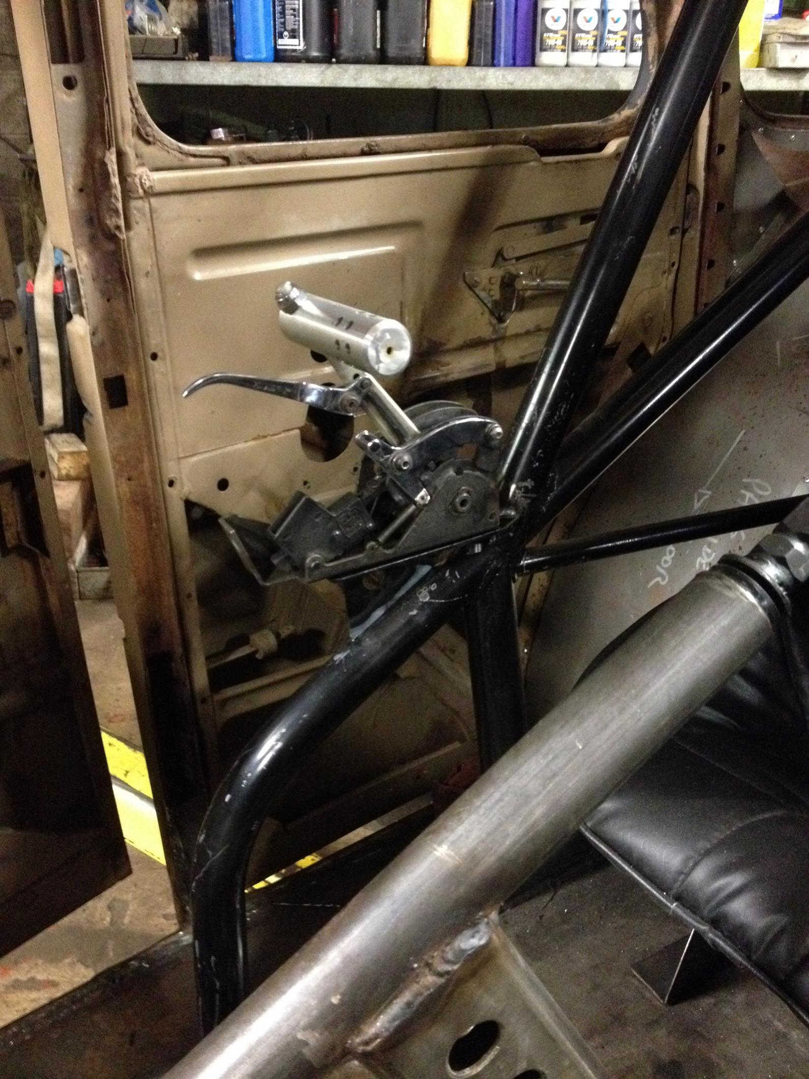

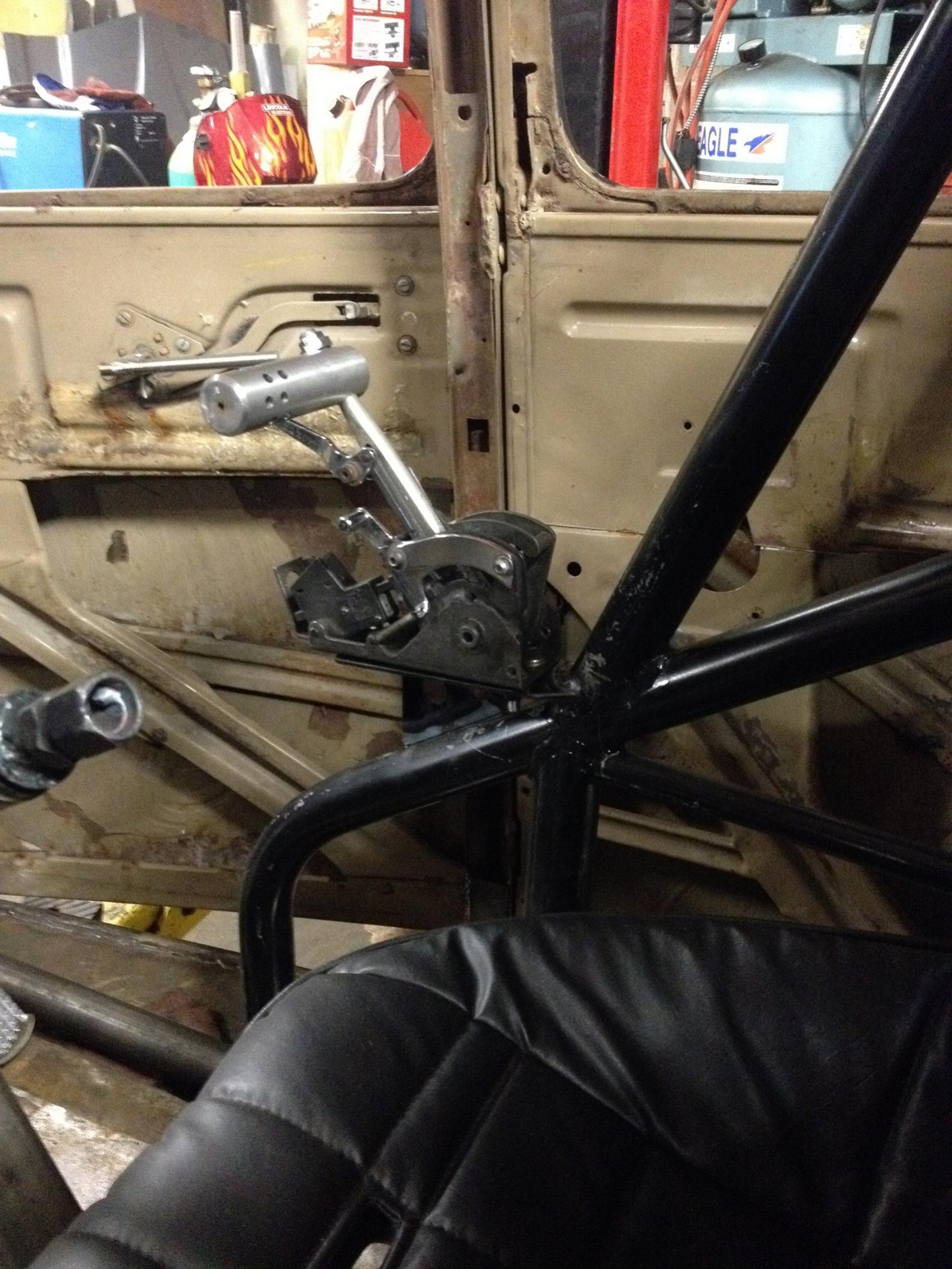

    2 days in a row at the shop... and we're not even in thrash mode. Sooo much more to do and the Scout is sitting in pieces waiting for our attention as well.
    Spent most of the day fuddling with the tilt front The sheet metal is so distorted it's hard to figure out where anything should sit. We also found out that we cannot put the engine and trans in from the side without holding your mouth the right way and smashing fingers. Much easier if we can attack it from the front. So we pulled the front support for the rad and fuel cel and re-did it as a removable unit.
    The paint thing yesterday has caused us to divide by zero... I painted the engine and transmission and my brother started painting frame rails and the underside of the car... I'm very worried...this whole paint thing is getting out of hand... it's starting to look like we know what we are doing...which we don't. The resulting paint high isn't too bad though...
    We also modified our shifter by adding a custom shift knob made from some weird aluminum ...thing... we found. It makes it a LOT easier to manipulate the shifter with the cage the way it is. We finalized the mount and welded it in. We'll likely shorten it a little but for now it works great. It sits only a few inches from your right hand and very very easy to make the 1-2 shift and you can still reach the lock out.

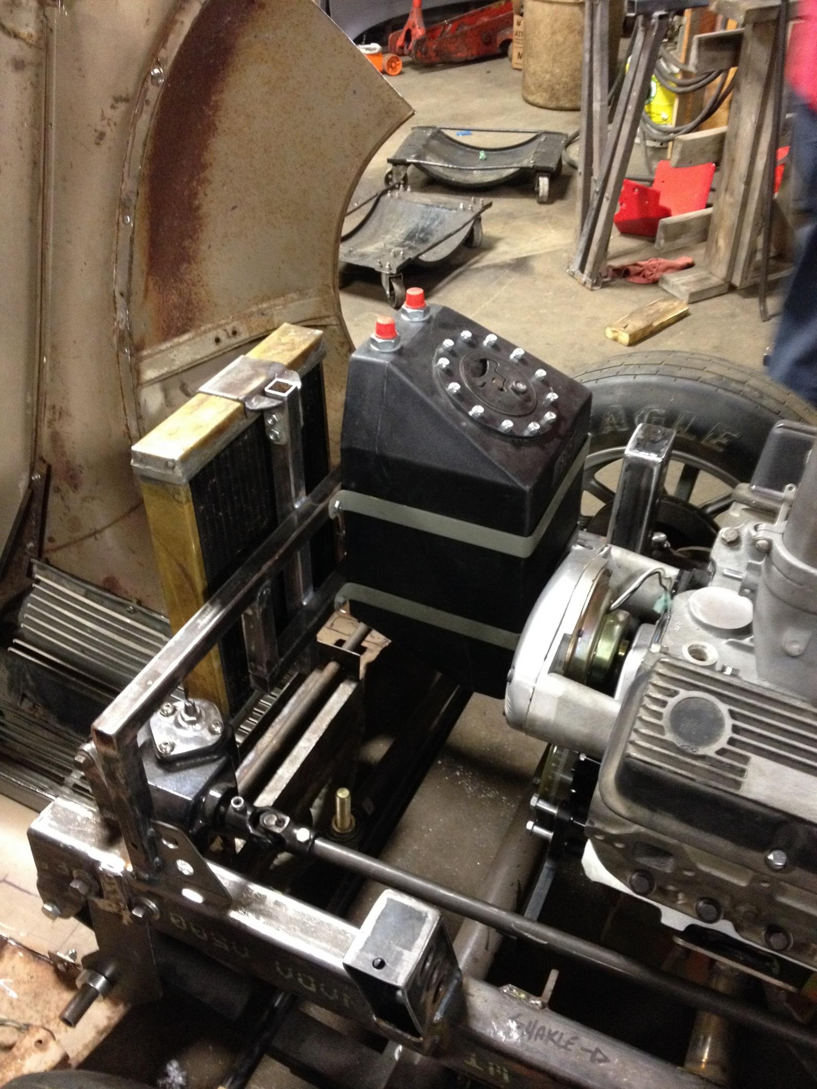

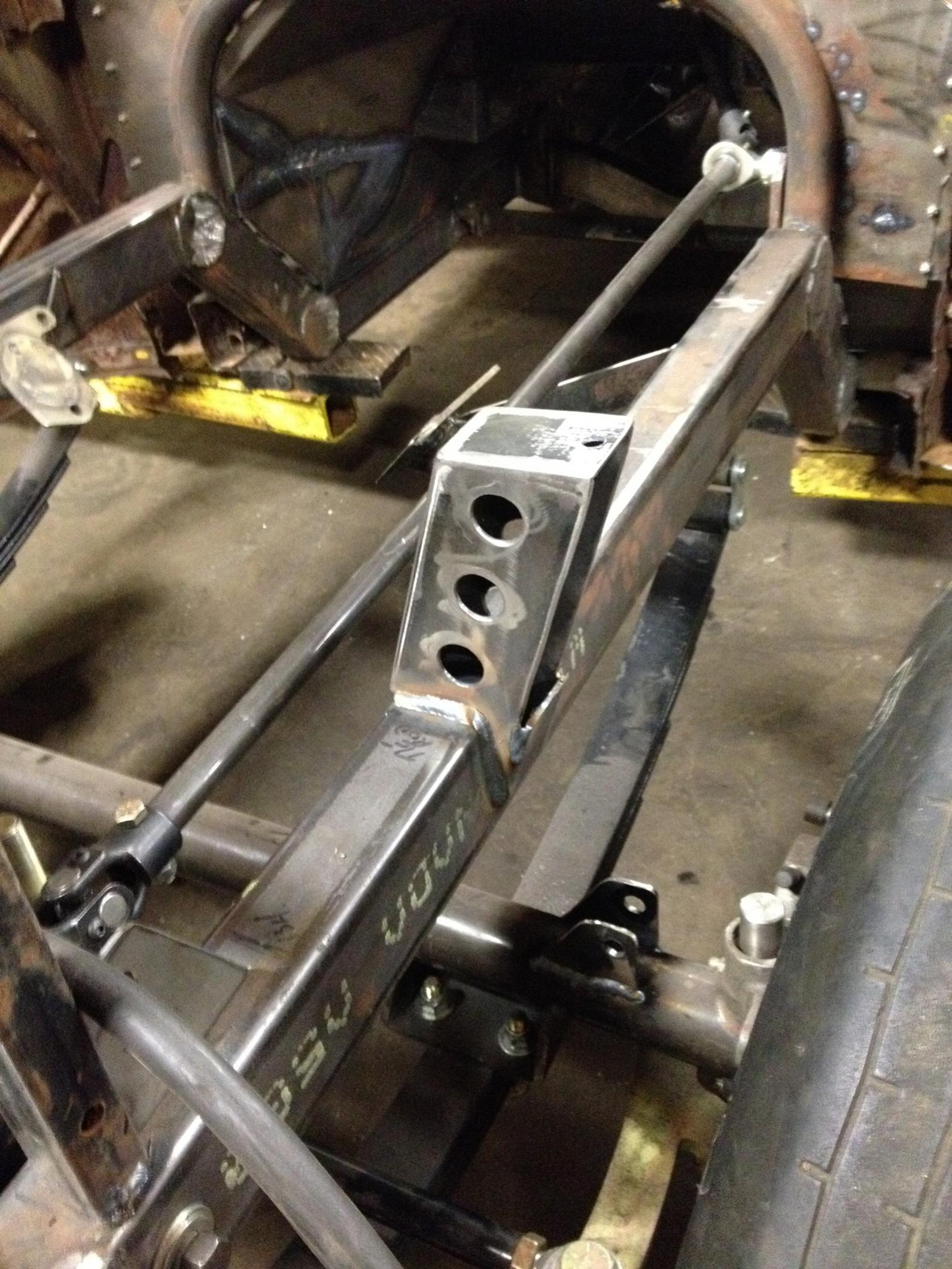

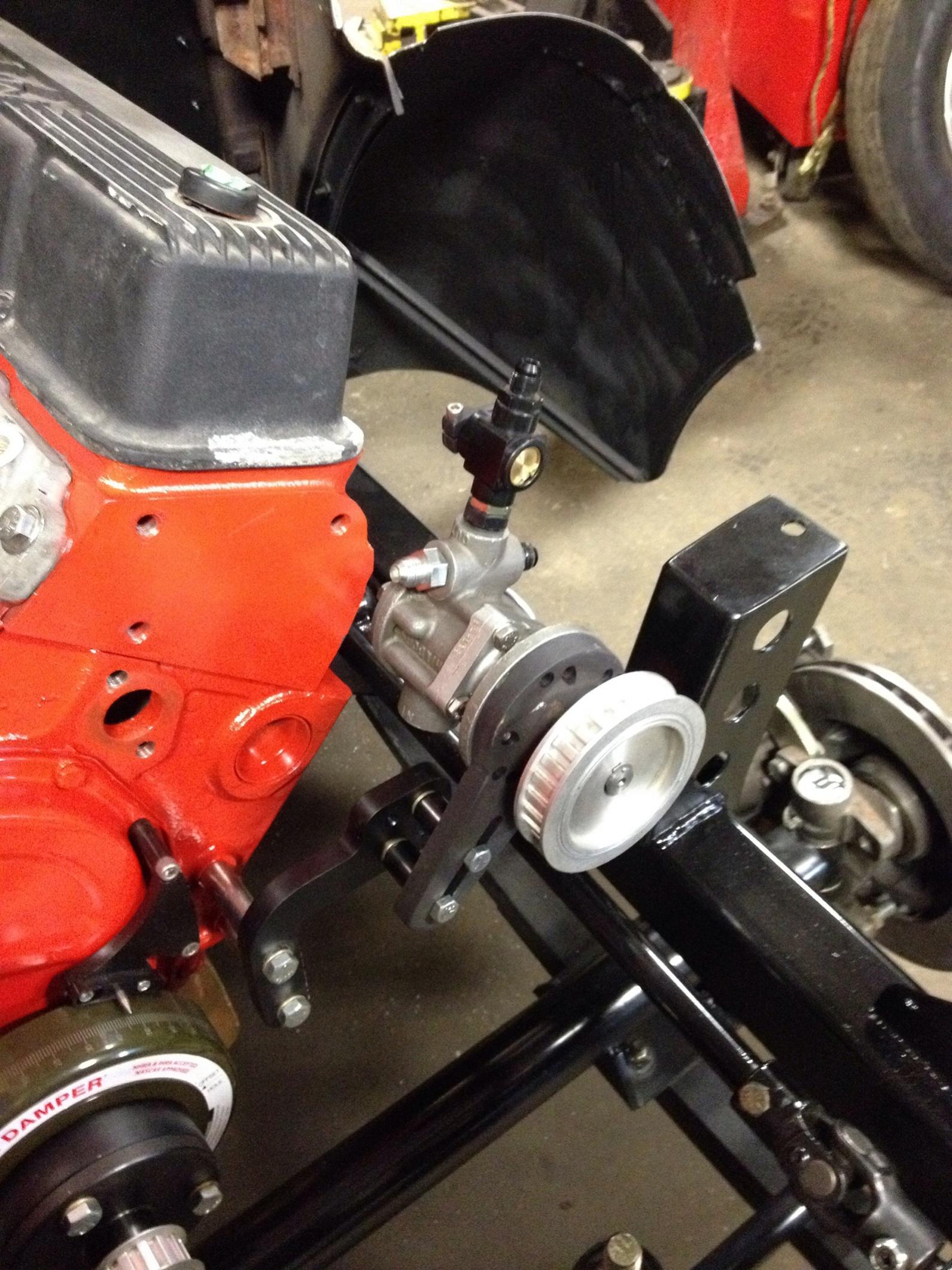

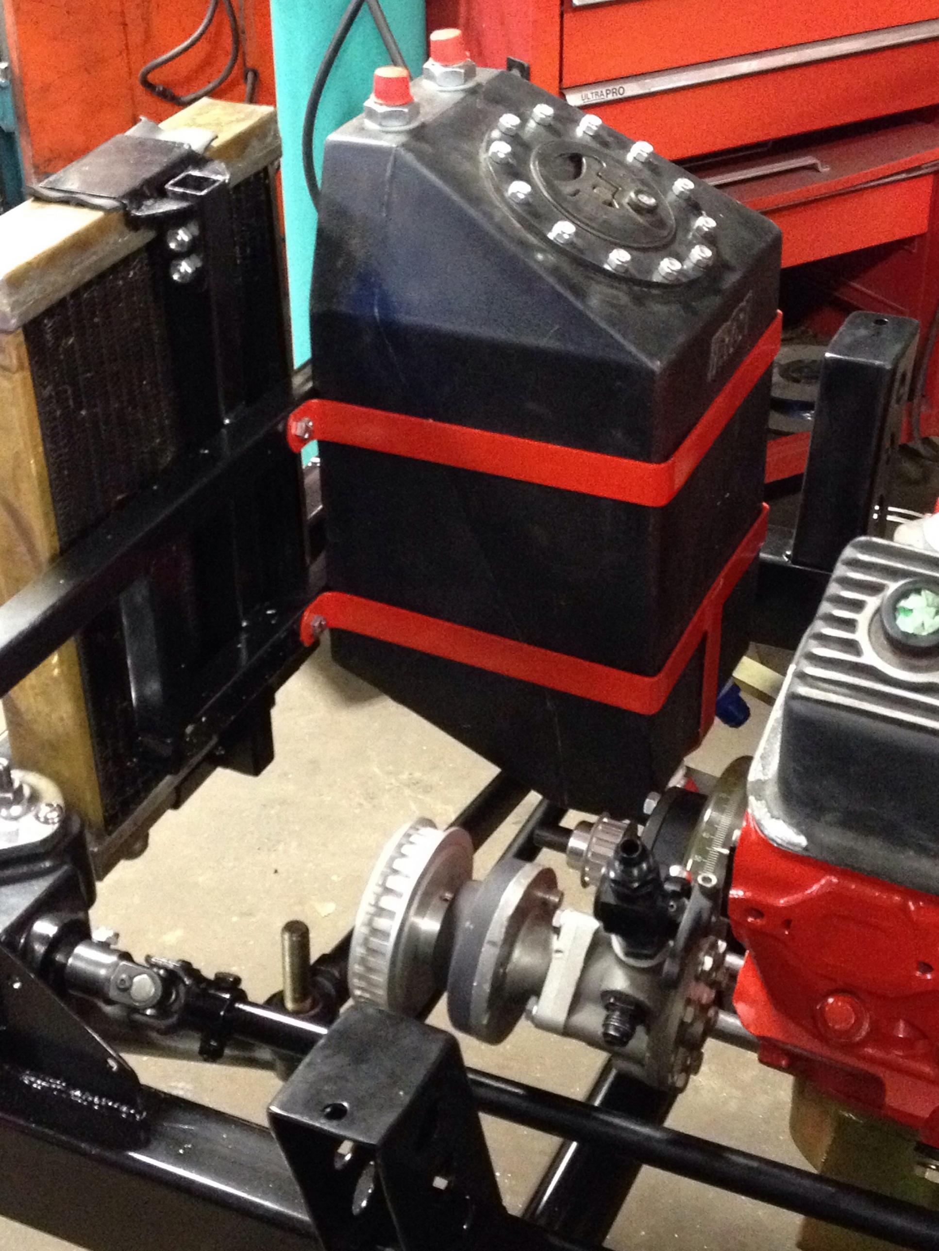

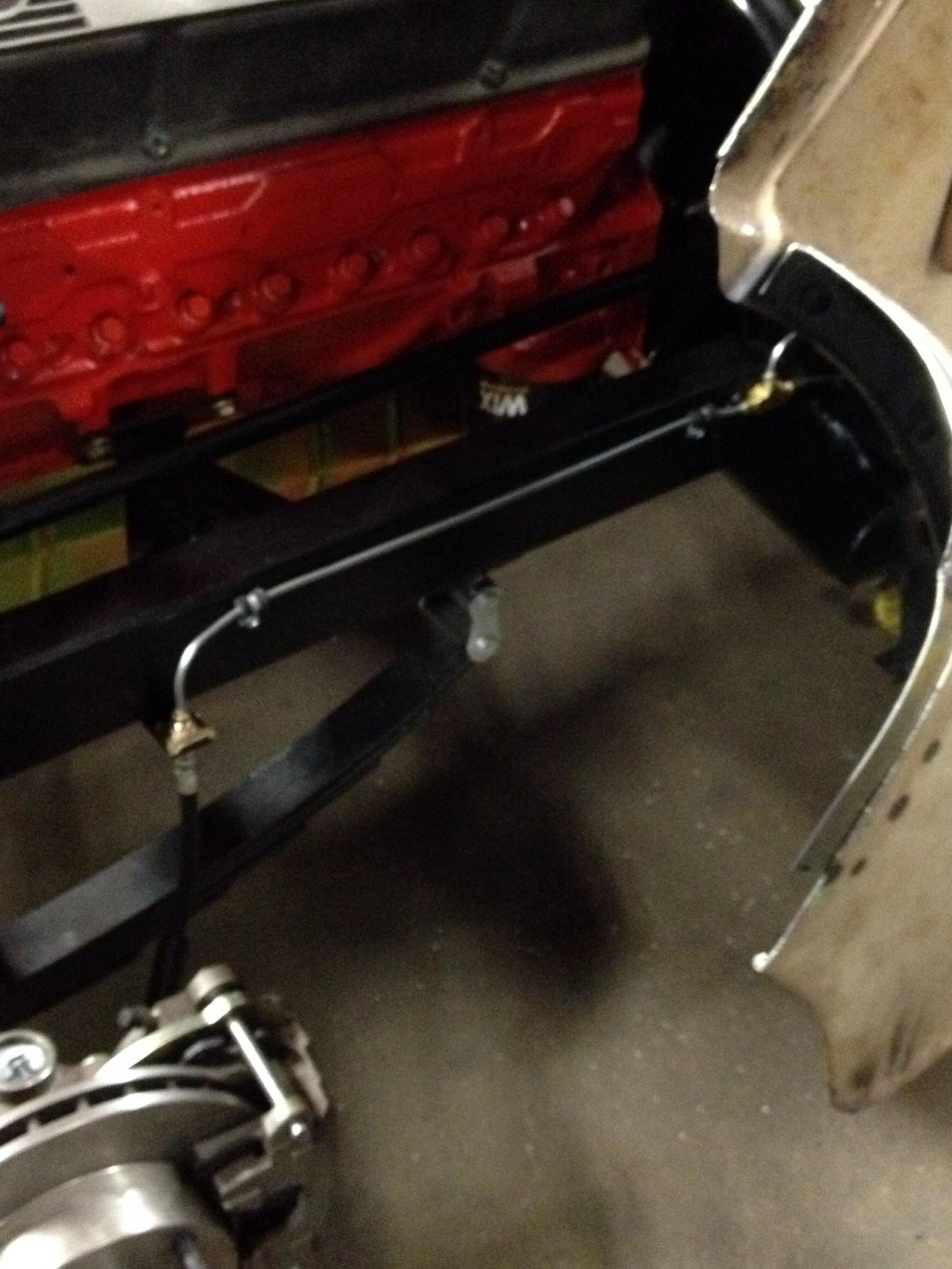

    Fuel system placement time.
    We are limited as to where we can mount the fuel pump and ultimately it's where the pictures show. It a bit high for our liking but we are hoping it has enough to draw a bit uphill once it's running. The primary byp*** and fuel shut off will be mounted directly to the pump to reduce the lines and complexity of the system
    We also mounted a priming pump (not in the pictures) and the plan is to prime with gas so we'll run a small surge tank beside the fuel cell. I just submitted a long list of fittings... pocket book say "Ouch"
    Oh yah... brake lines !! One step closer kids

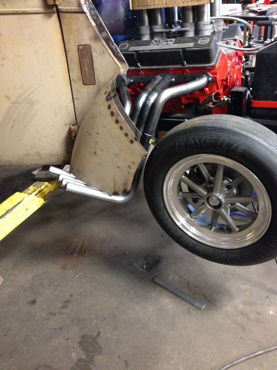

    Time to build the headers... decided basic fenderwell style is... well... boring. Went with the Headman zoomie build your own kit and brought in a talented friend...Scott... and built our own to fit.
    I think they look seriously bad ***... almost makes me want to put the blower motor from the Scout in the Prefect just to match up to the headers. The Scout would look *****'n with the Hilborns... like I said...almost. These are obviously not finished and are just tacked together. They fit under the fenders with a bit of t******* to the sheet metal.
    We also dropped about $200 in fittings and hose and plumbed the Hilborn fuel system. The Plastic fuel cell we are using had 4 bulkhead fittings and in the end we are only using the outlet that has the ball check valve. Everything else we repositioned.
    By the way... I HATE -4 hose and fittings...they seriously **** to make...
    After screwing around with the fitting tools and different ways to cut the ends I finally fell back to the good old tried and true way of getting the hose into the fitting by using a very small flat screwdriver and stuff the loose ends in. Works great... got both ends together and just as I was tightening the last fitting... it snapped off leaving the piece inside the hose... I'm not a happy camper...

    For hose cutting I use the Speedway Motors hose cutters, they cut a perfect end with no bits hanging out, at $20 they are a bargain
    Looking good dude.

    That might be the best bit of advice we have received in 5 years... ordering one today
    Oh ya... I got pinged by 4 very concerned folks about my -4 line rant. (Thank you all by the way) The -4 lines are on our priming system and not on the primary fuel system itself. That system is all -10 / -6 lines as suggested by Alchydigger and the system itself.
