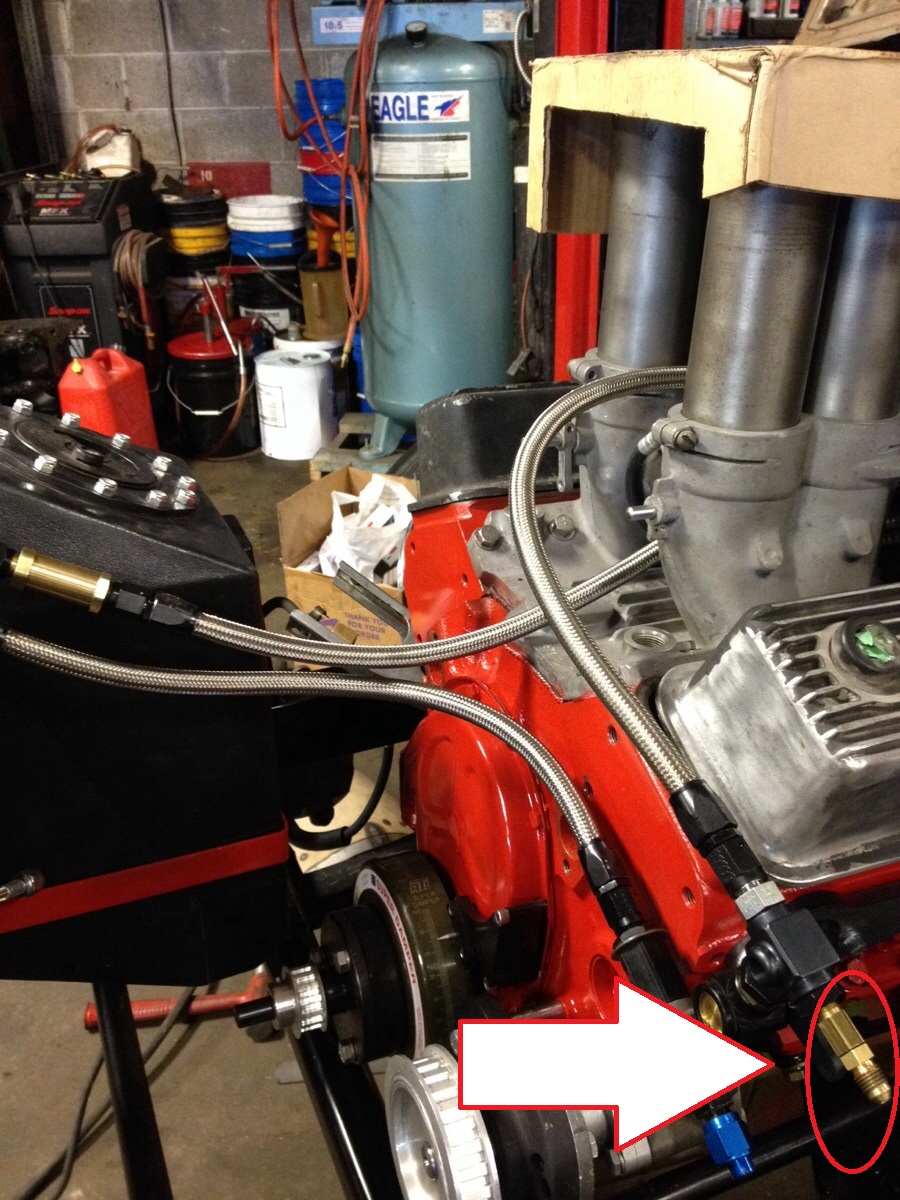

  1. -4 fuel lines with alky??? LOL....

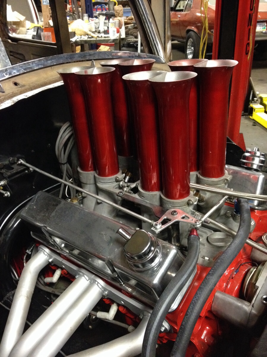

    What size Hilborn are you using? Will you run alcohol or gas?
    els likes this.
  3. Saxxon
    Joined: Dec 14, 2008
    Posts: 1,835
    Saxxon
    2 7/16 Hilborn on alcohol.
    els likes this.
  4. hotroddon
    Joined: Sep 22, 2007
    Posts: 28,240
    hotroddon
    I was going to say the same thing!
    I feed my pump with a -10 and then by p*** with -6 as recommended by Hilborn - and this is with Gasoline
    els likes this.
  5. Saxxon
    Posts: 1,835
    Saxxon
    Ok guys...please read the previous posts...
    The line from the fuel cel is -10 and the distribution lines are all -6 as per recommendations from Hilborn and AlkyDigger as well as the inlets and outlet sizes of the parts themselves.
    The -4 is for the priming system but thanks for the concern

    Will you be doing any dyno work, or just the **** dyno at the strip? Curious what HP you'll be at. I've got a 2-1/2" Crower going on my SBC Thames on gasoline, but mine will be streetable (I hope!).
    els likes this.
  7. Saxxon
    Posts: 1,835
    Saxxon
    We wanted to put it on a dyno for set up but we are running out of time. We "may" put it on a ch***is dyno if we get it ready soon enough but we have a lot to do and my Scout g***er is sitting in the corner waiting for it's turn to be re-***embled.
    We know the motor made 505 hp with a carb on alcohol before the rebuild and the few extra tweaks done to it. We are hoping for 530 - 540hp. Our limiting factor are the heads. They are decent Dart Iron Eagle but they could be better.

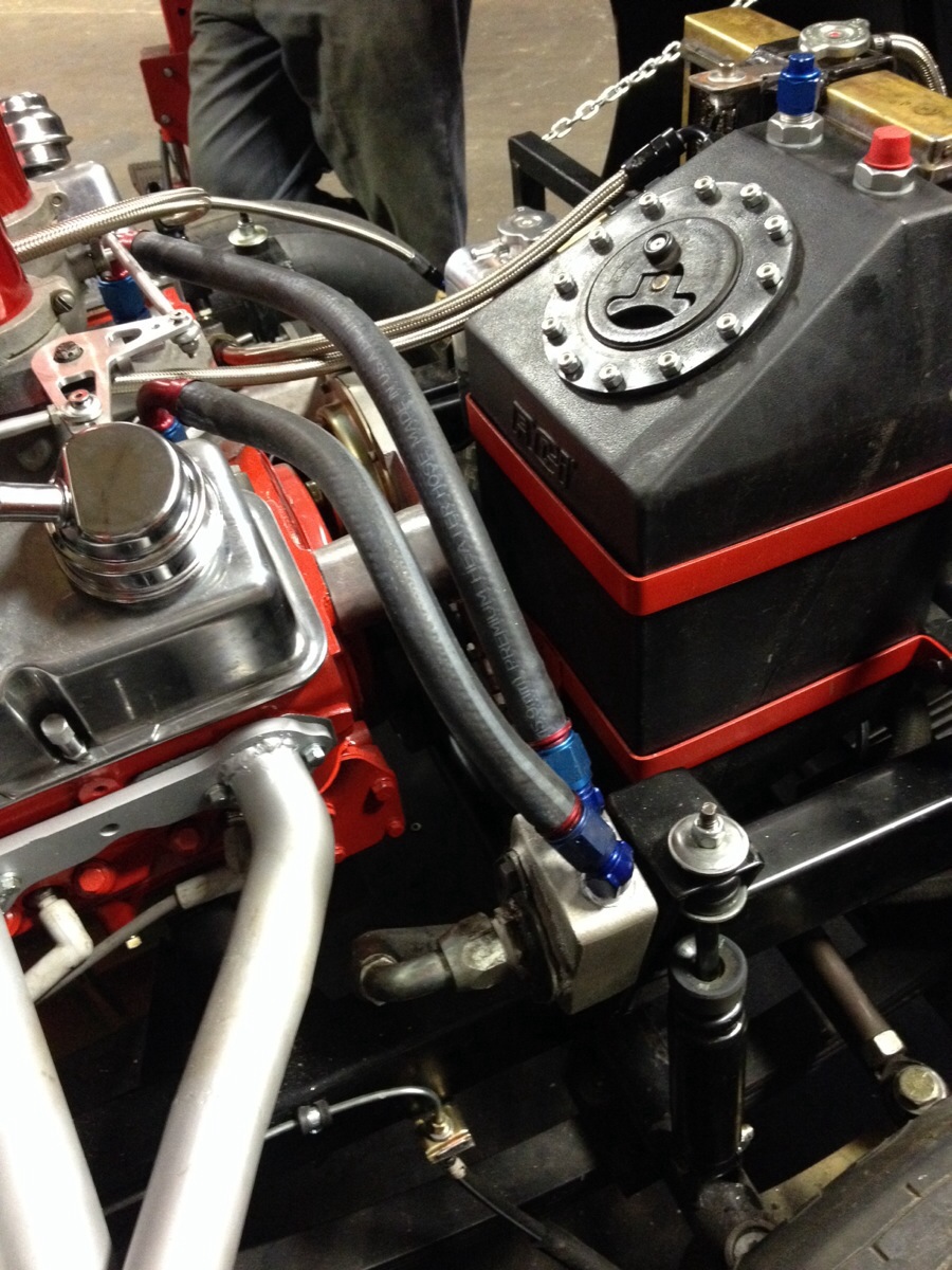

    Pipes are being repositioned and welded up, electrical schematic being drawn up and hopefully we'll have that sorted out in the next week or so. Cooling lines being sorted out. We are having a bit of an arguement on how to do this. My brother wants to use pipe. I want to use AN and hose and Larry says he has stuff under his bench we should be using... we just need to get him to bring it so we can see it. Too many cooks sometimes make for difficult decision making paradigms. Our next dilema is adding the driveshaft tunnel required for center steer cars. This will mean we have to fabricate a panhard bar / watts link of some sort. Again... too many opinions have us frozen on this subject.

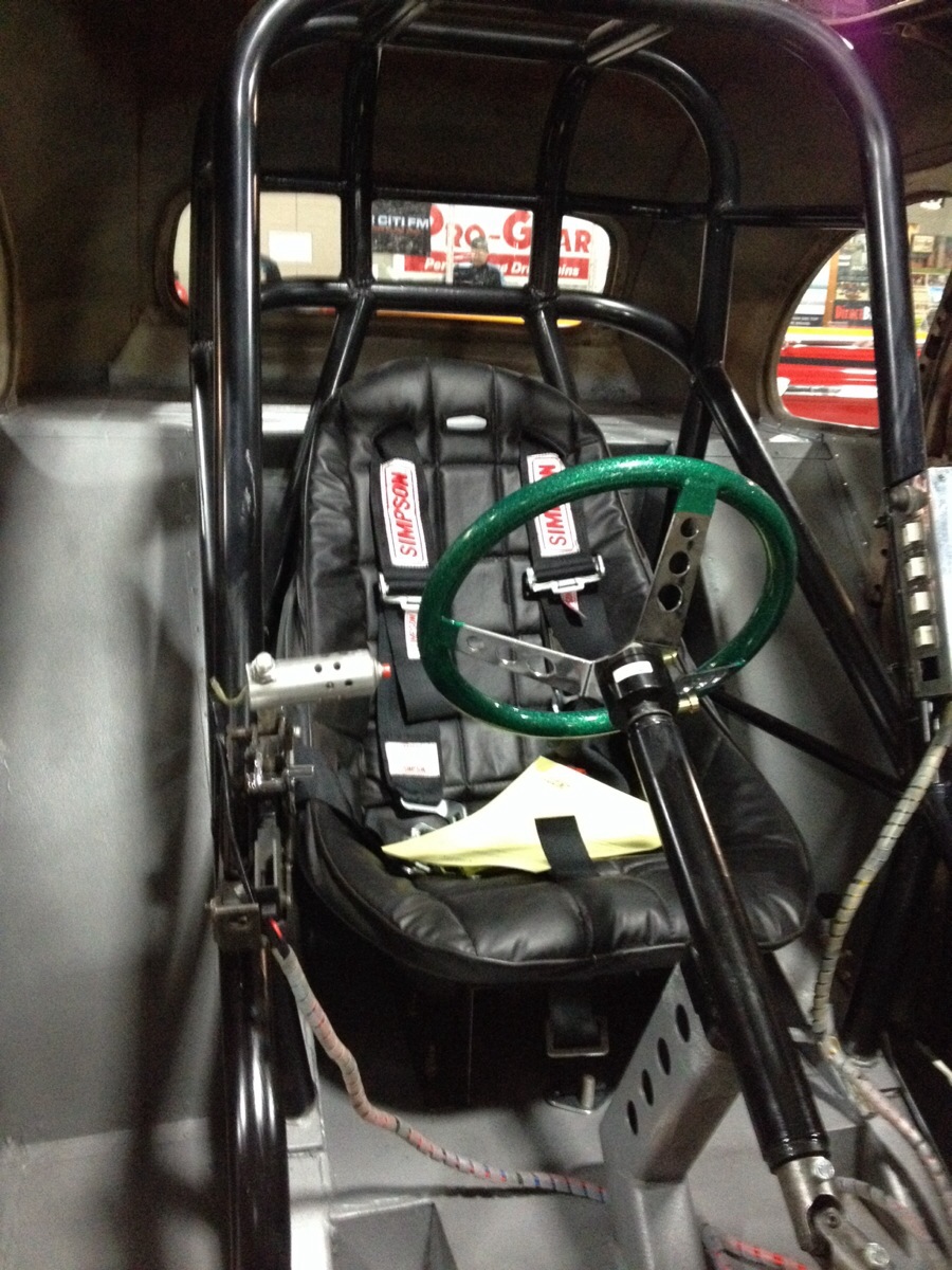

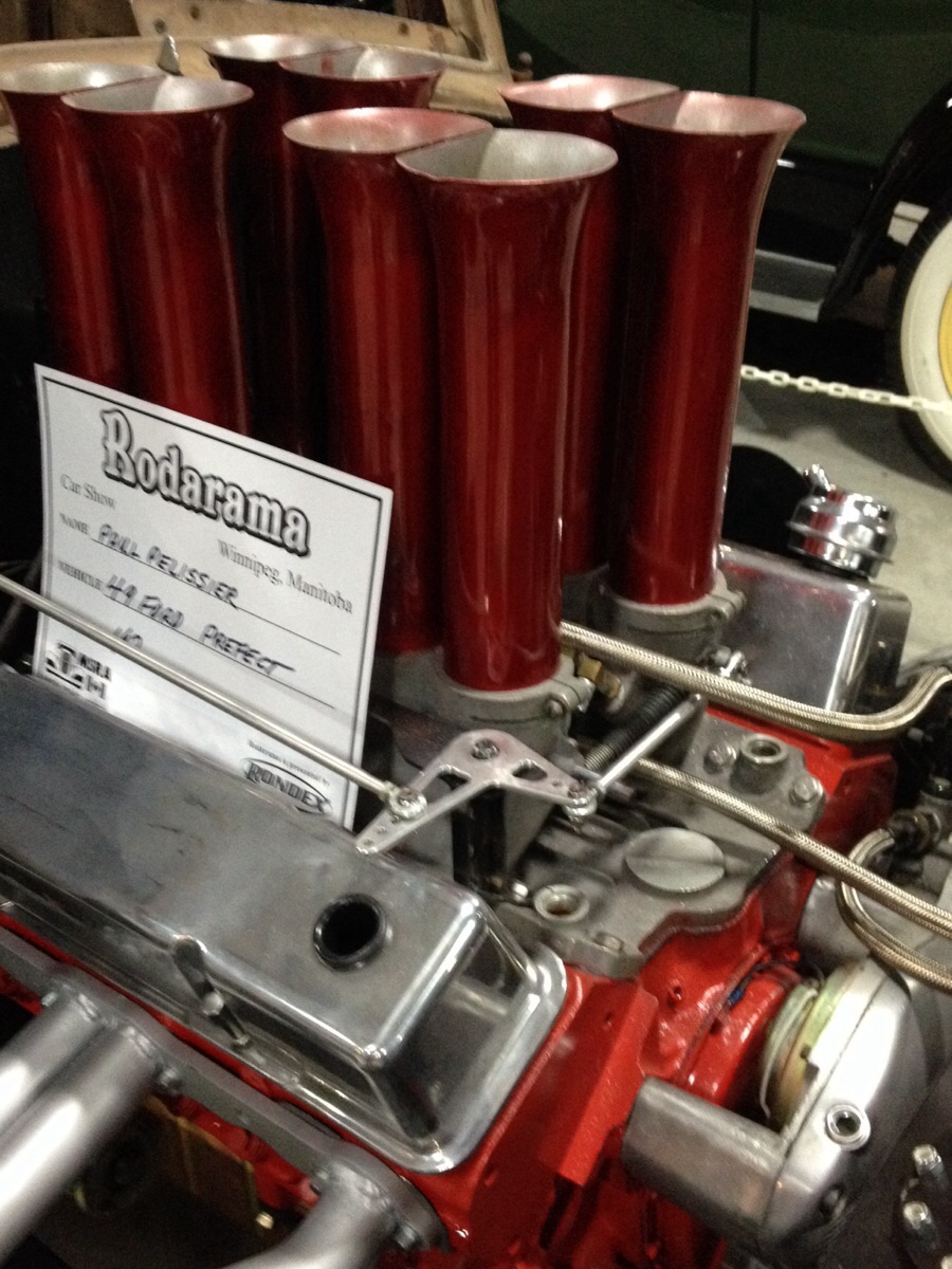

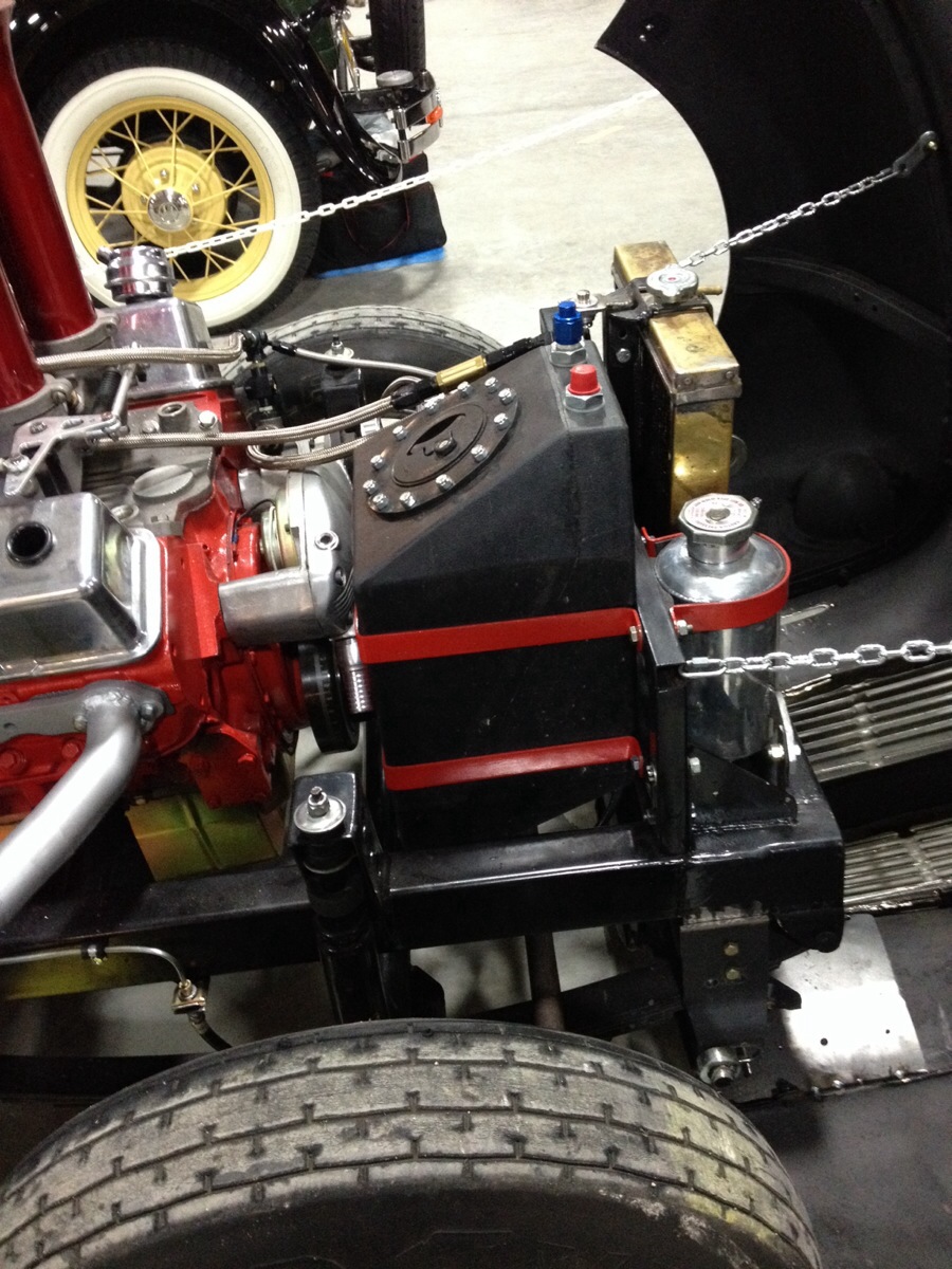

    The Prefect took it's first tentative steps out of the shop... Ok...we pushed it into a trailer and took it to a car show... in snow storm.
    The Rodarama show is out on by the Manitoba Street Rod ***ociation. It's a no frills up close and personal event held in the middle of 2 hockey rinks. It's a very cool little gathering. The MSRA barely tolerate drag cars and are totally against trailer queens of any kind. But the hard core rod guys really liked the Ugly Beast and it's one of the few cars there that had folks stopping and staring with more than a few points and headshakes... I love it
    Here are some ****py pics of the Ugly Beast's first public appearance

    1st public appearance was a great success. Lots of positive feedback. They even saw fit to award the Ugly Beast with a 1st Place - Special Interest. We were also informed the Prefect was in the running for people's choice. Very cool
    Now... enough of the posing ****... time to get this thing running and pound the **** out of it !!
    Oh yah... see the look on the kid's face ... that's what's it all about !!

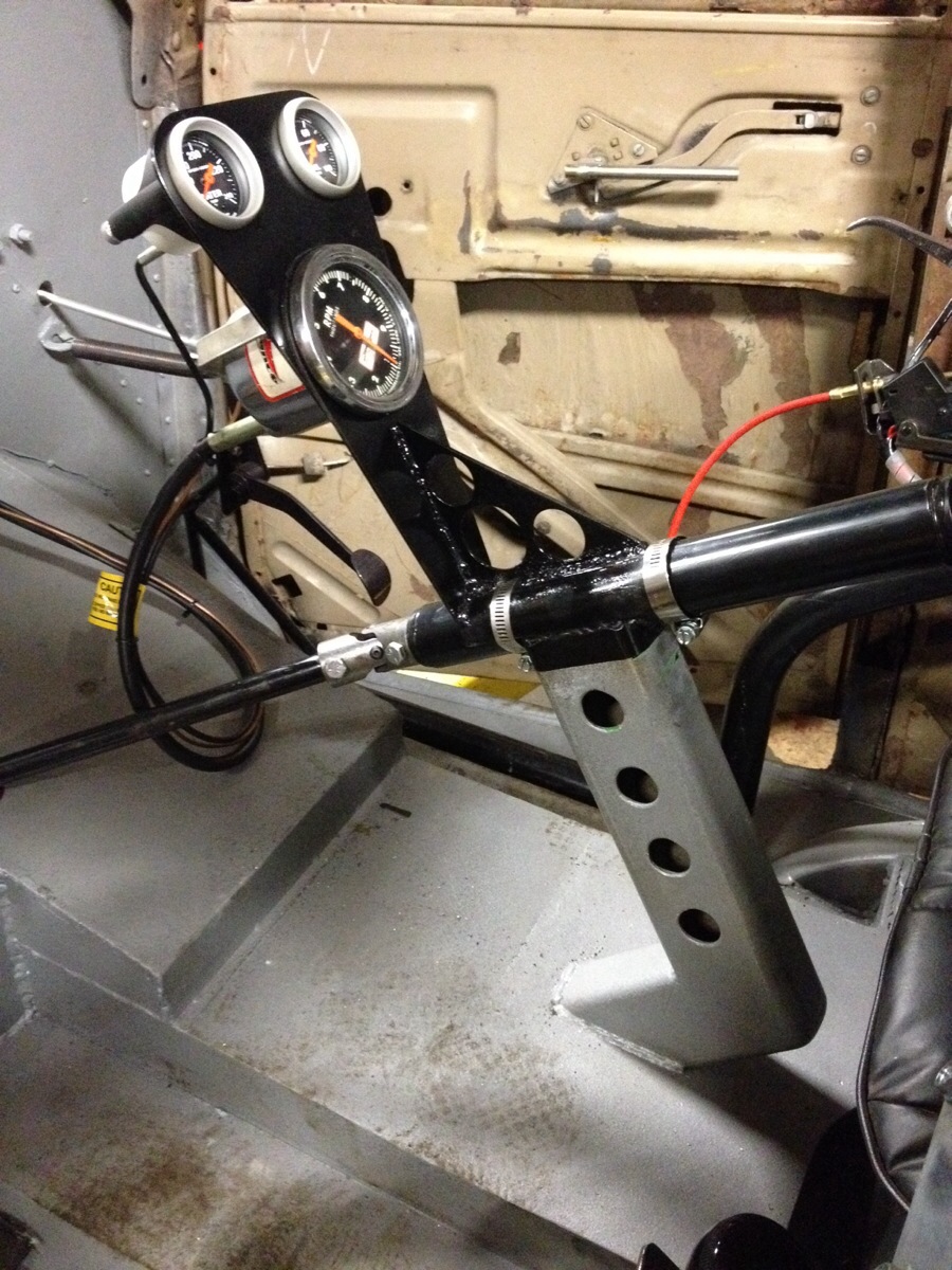

    Gauge panel mounted and cooling system finished. Also added a tow loop off the frame and a bit of moulding to hide the butchery, I'll add some similar moulding around the front and rear nerf bars
    Almost there kids
