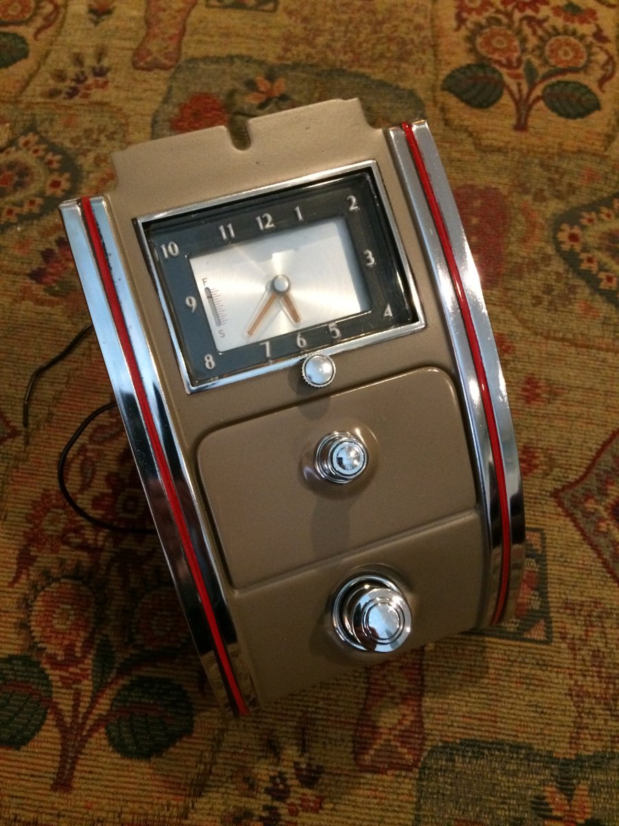

    The entire Dash got refurbished, starting with the Radio and Clock units. The original colors were boring, so I took some creative liberties. The radio was working, however, I removed the 7lb. Speaker, and will just go with a portable Blue Tooth Speaker later. The Plastic Covers on the Radio Knobs broke off, and the Knobs are Wood underneath! Satin clear coat was a no-brainer!

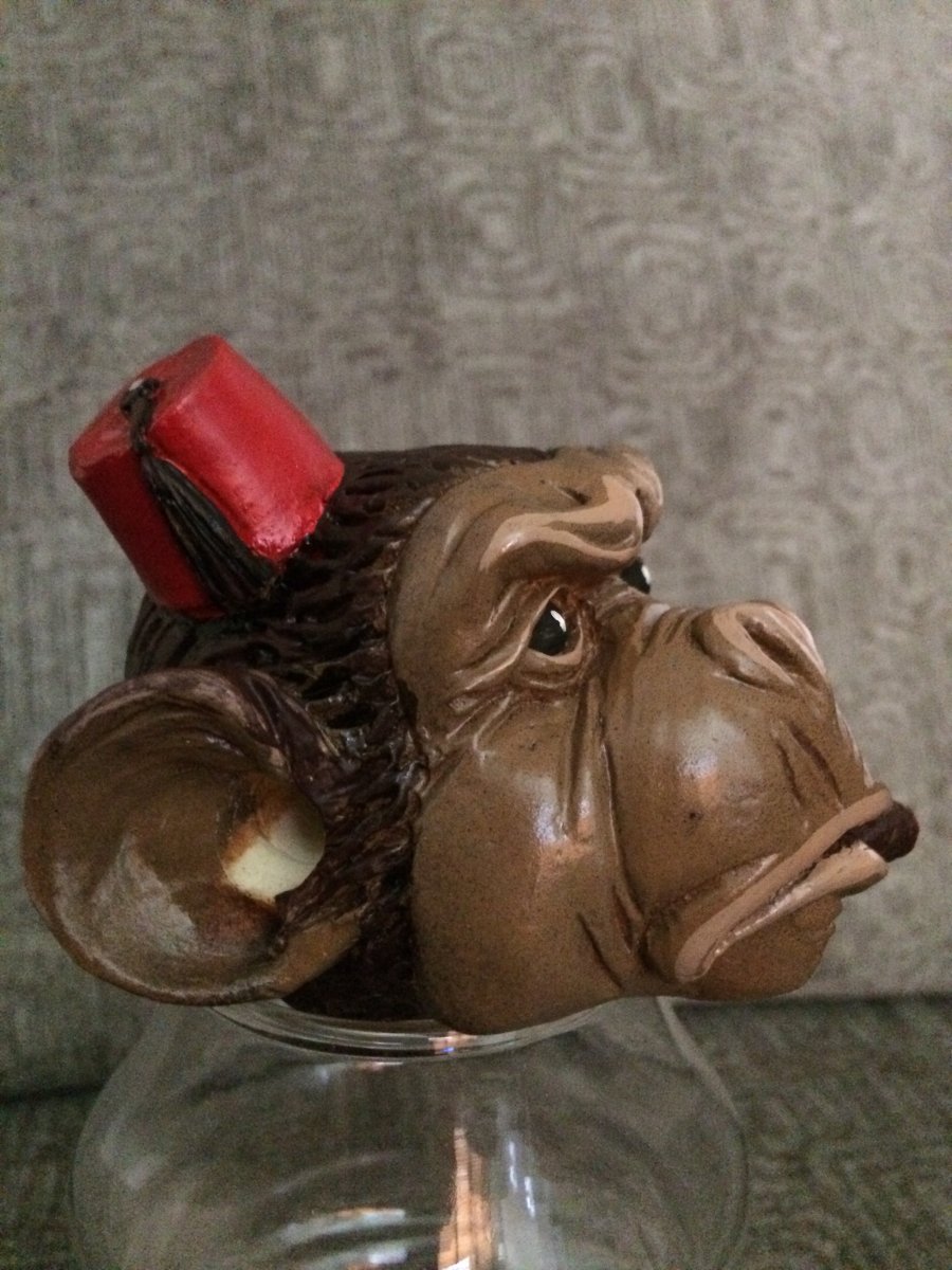

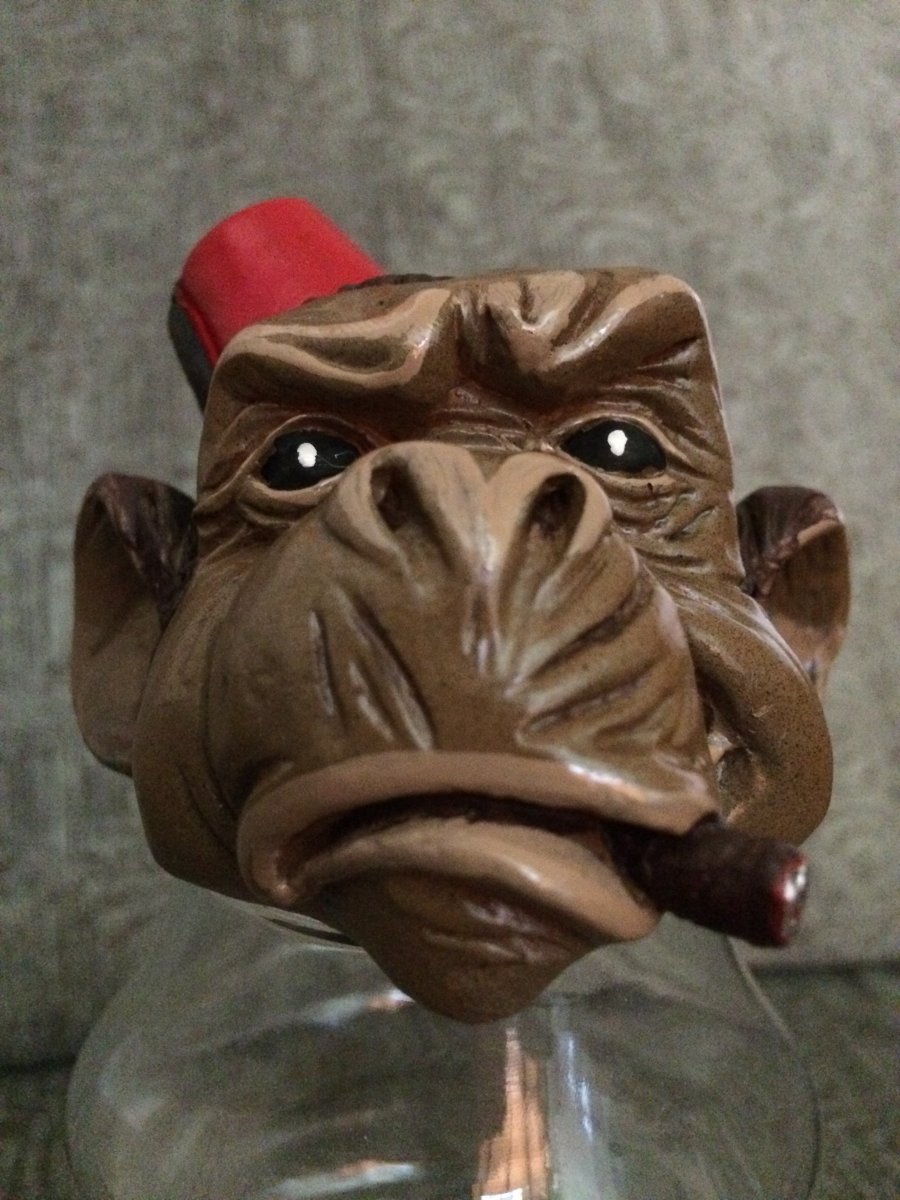

    The Column Shift Knob was missing, so... I drilled through his right ear, and popped him on.

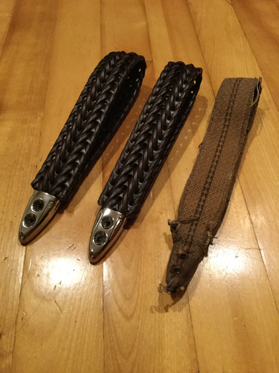

    The P***enger Straps that attach to the "B" pillar were in rough shape, so I bought a Men's Leather Belt and had a local Cobbler replace the fabric straps.

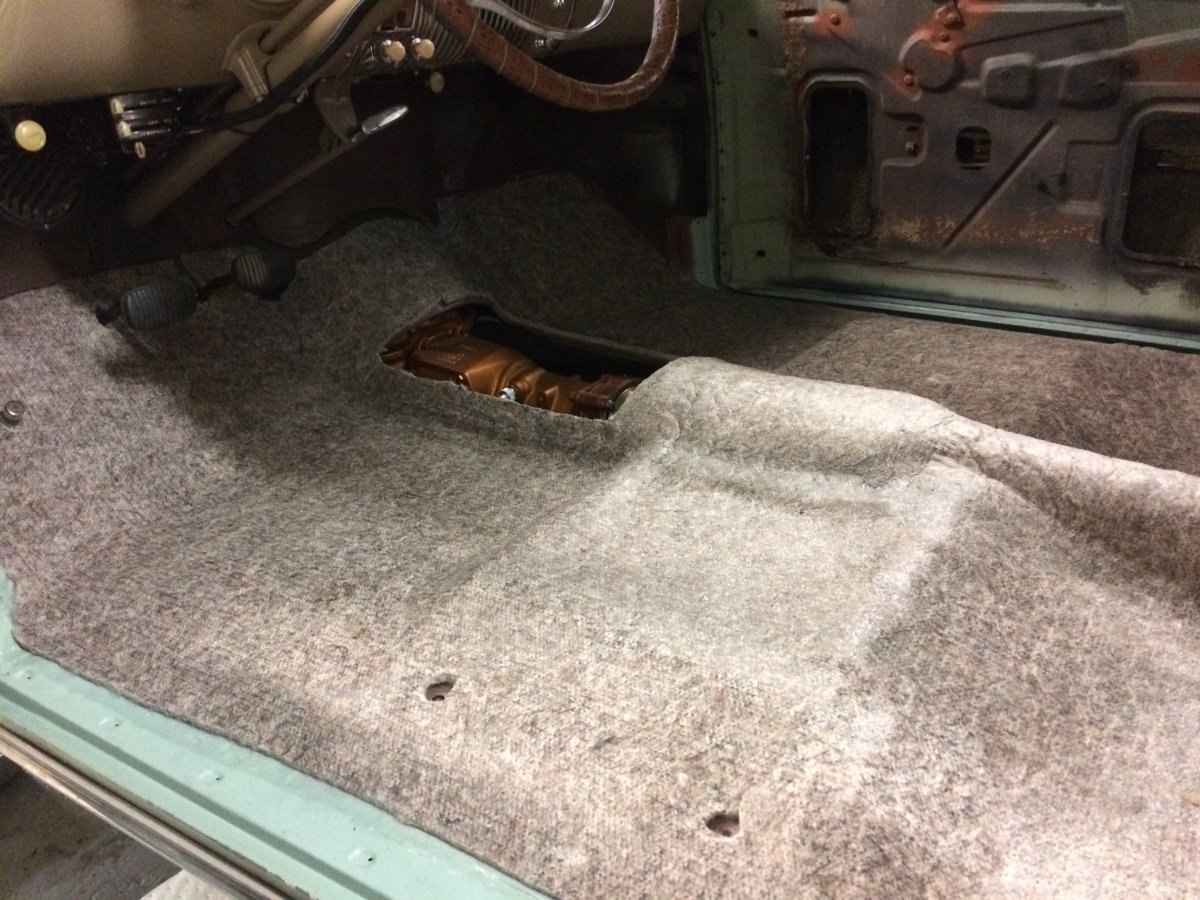

    Today I got the Carpet done.
    I didn't want to go with the usual repop route so I purchased an Area Rug, a trick I've used on several builds.
    First I cut out the center and glued it to the Jute pad over the ****** tunnel. Then I flipped the 2-remaining pieces so the binding would be along the exposed tunnel edge, and installed them. Relatively quick, with no sewing required. The Transmission Access Panel will be sand blasted, clear coated, and left exposed.

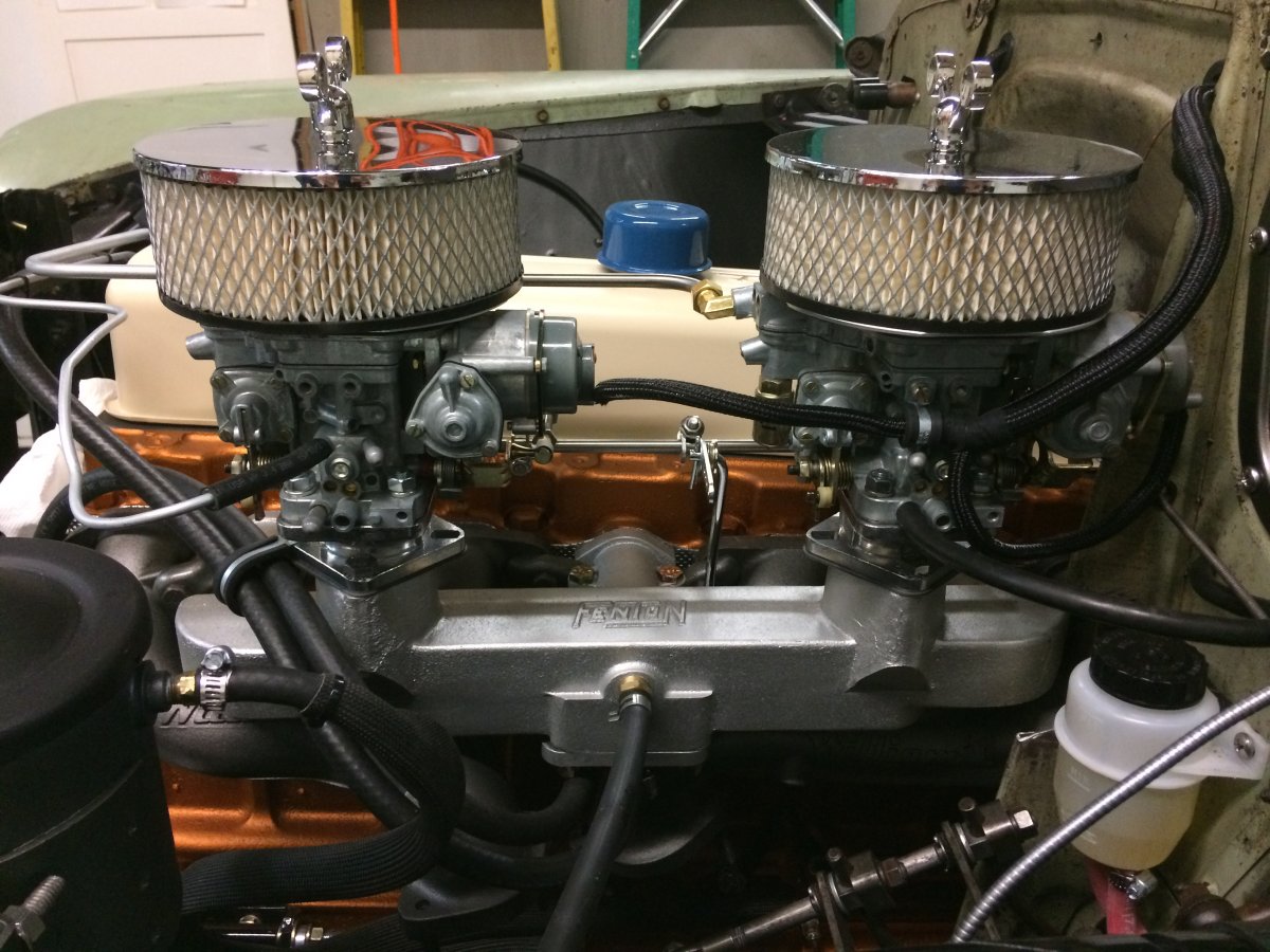

    Here are 2 more Engine detail shots, showing both sides of the engine. I still haven't finished the front of the block yet (Thermostat, Radiator), because I switched gears trying to complete the Interior, so I can test drive the car before final Dual Exhaust install. It will be much easier to make Clutch, Throttle Linkage adjustments without the tight-fitting Exhaust Pipes in the way.
    After power washing with Purple Power, I wet-sanded and clear-coated the Firewall, and sprayed the Inner Fenders with satin black hammered finish Rustoleum. Any fasteners that weren't reused were switched to grade 8, and polished stainless replace the trim fasteners. It's always tricky to get a good balance of old and new, but I like the results.

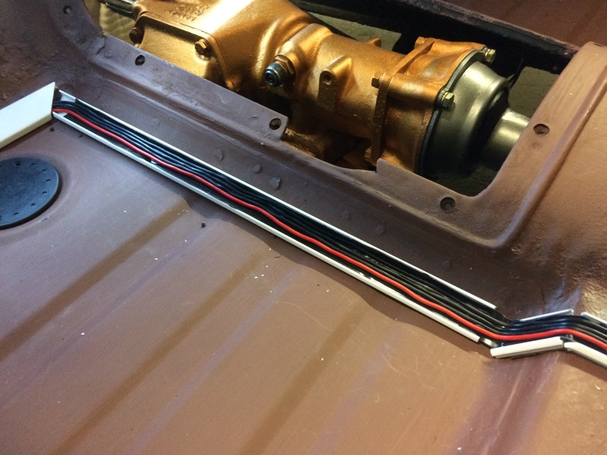

    Here's a cool trick I've been using for years:
    - All the wiring is managed in a Wire Cover you'd use in your home.
    - I lay the wires on 3M double-sided tape inside the channel, so they stay in place and don't get pinched.
    - The floor gets padded up to plane the cover with the carpet, so there's no bump.

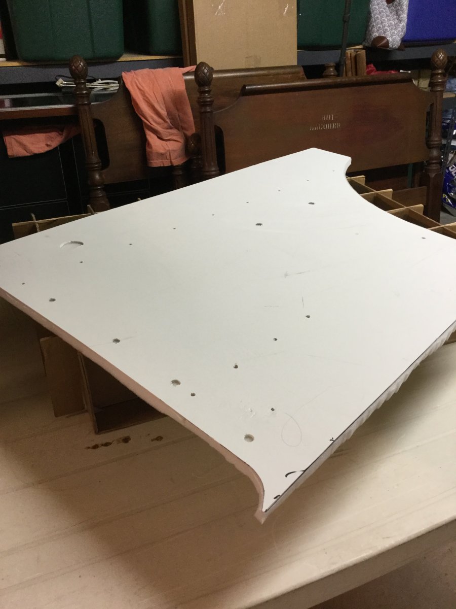

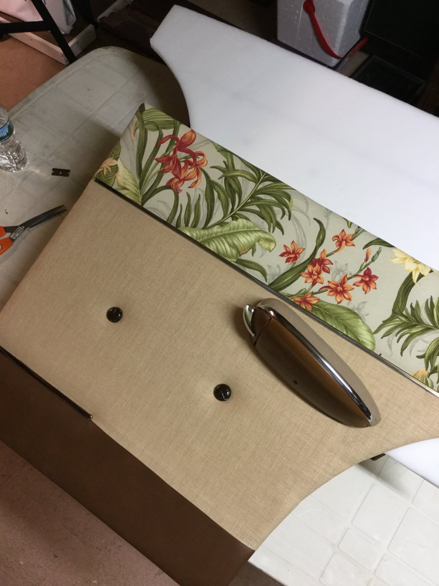

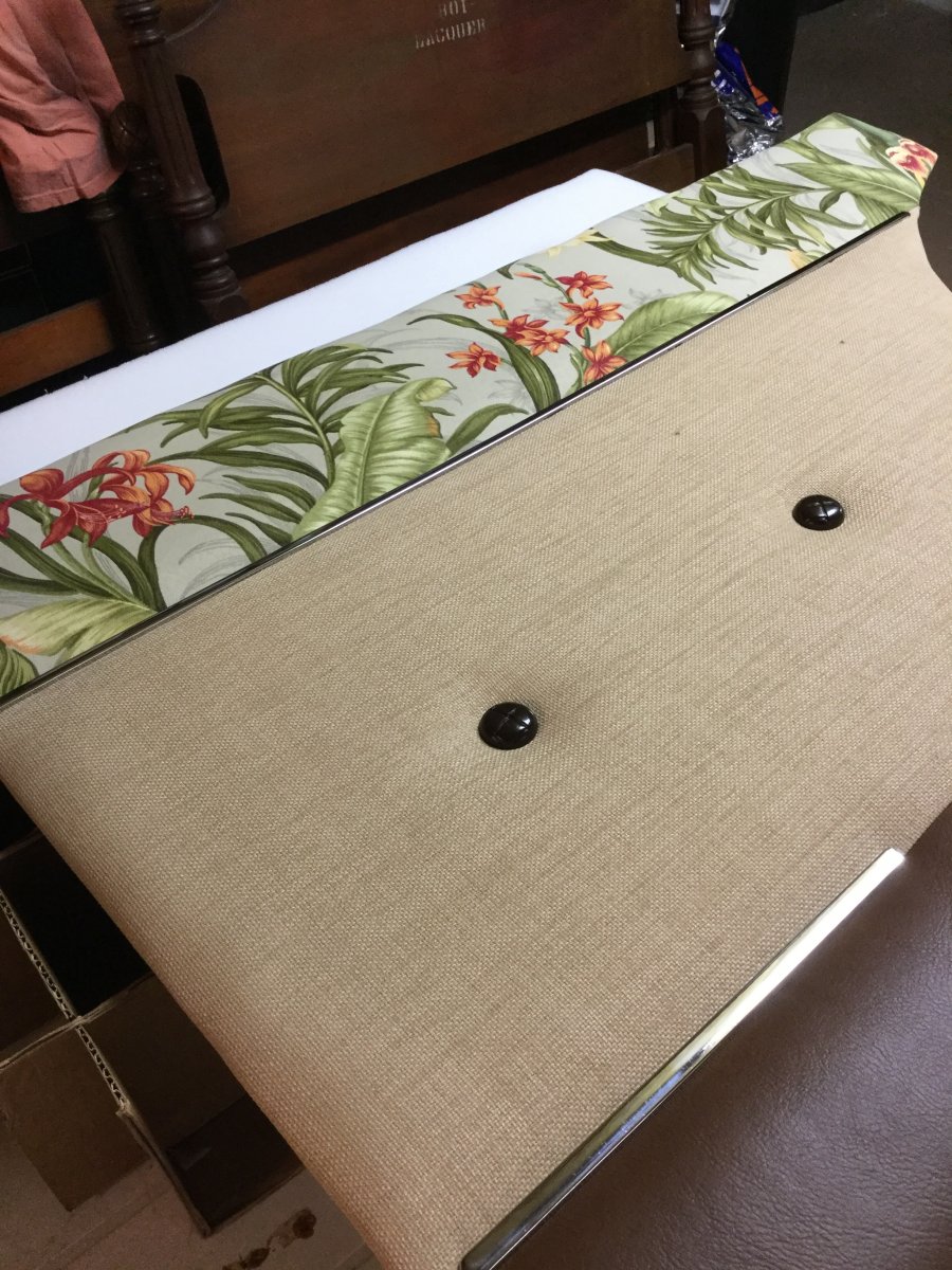

    Time to tackle the Door Panels.
    After making new panels from Sintra, I covered them with foam spray-glued in place with 3M 99.
    The 3-materials choices were s***ched together so that the seams would hide under the original stainless trim.
    Same spray adhesive holds them in place, generously applied to both surfaces, allowed to dry until tacky.
    I found some NOS Coat ****ons with metal loops, and a straightened Coat Hanger through each loop from behind holds them in place, creating a tufted look.
    The Door Panels are pre-drilled and screwed with plastic Snap Caps.
    QUICK FACT: I've been using Sintra brand PVC-type panels forever. It's waterproof (used for outdoor signage), easy to mill, can be heated/manipulated for complex shaping, and comes in a variety of thicknesses.

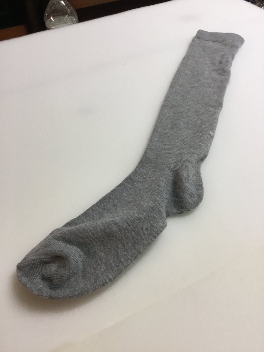

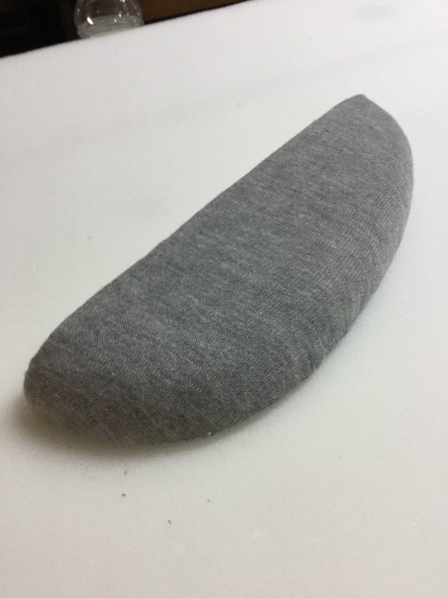

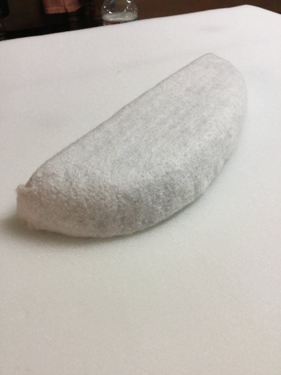

    How to Upholster a Crusty Old Arm Rest...
    1. I wrapped the Arm Rest in Cotton Batting...
    2. Then a Knee Sock from Target
    3. Finished with a Stretch Knit Fabric
    By using this layering technique, it took out almost all the deformations in the original foam Arm Rest.
    Arm Rest Original.JPG Arm Rest Step One.JPG Arm Rest Step Three.JPG Arm Rest Step Four.JPG Arm Rest Complete.JPG
