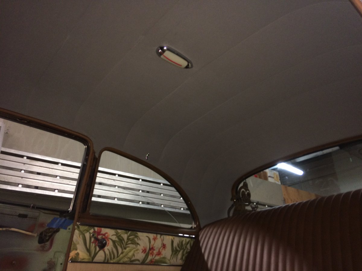

    The next time, this is the process I would use for FABRIC HEADLINER INSTALLATION.
    1. Clip the Stiched Sleeve in which the Bows install 2" short of the Bow end. This will allow pulling the Headliner without restriction.
    2. Once hung in the car, Steam the entire Headliner. This will allow you to over-stretch the fabric, and it will shrink tight when dry.
    3. Temp secure the Front and Rear with Binder Clips from an office supply store.
    4. Install over the Doors first. Once the Headliner is tucked in, it isn't coming back out.
    5. For this car the Tack Strips at the A, B, and C Pillars, and around the Rear Side Windows, was replaced and glued-in with 3M Weatherstrip Adhesive. This holds better than the original staples. Once dry for a few days, staple the Headliner in place using a home center hand staple gun with 1/4 T50 staples. No need for fancy pneumatic equipment.
    6. Now the front and rear can be permanently installed, with 3M 90 Spray Adhesive, for extra hold in case the original Barbed Teeth are broken or don't hold.
    7. Steam the entire Headliner using Distilled Water, for less chance of staining. In my case, I used a total of a 1/2 gallon of water. 3-hours the first day, and another 3-hours a few days later.

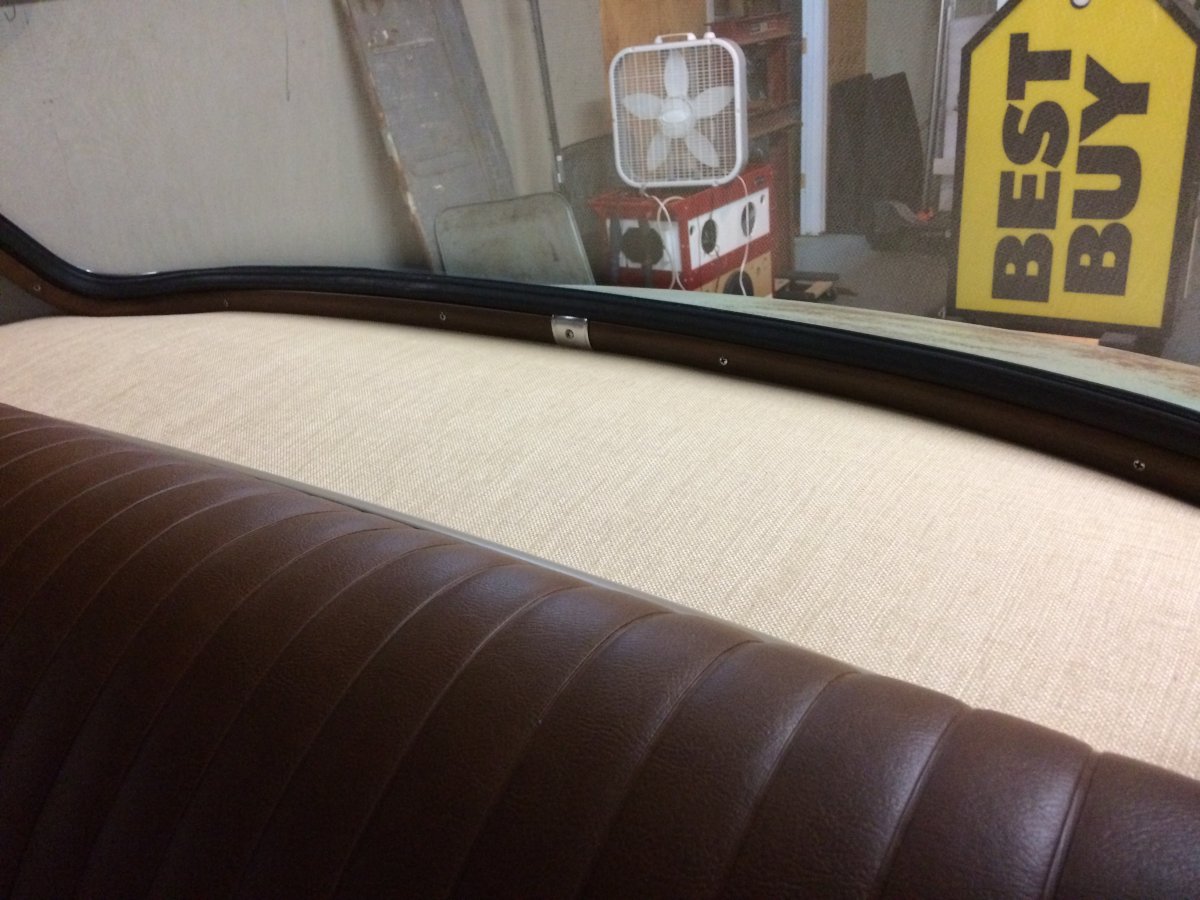

    The Package Tray was made from my other "Go-To" product; Sintra. As noted before, it's a PVC type product that is made for exterior applications, so it does not warp, it's waterproof, and shapeable.
    Here was my process, which I've been doing for years:
    - Template the shape using an old Wall Hung Paper Calendar. I like these because you can tear off the pages as needed, they're thin enough that you can scribe the shape with your fingernail, and then cut the line using scissors.
    If I screw up an area, it didn't cost me anything but time.
    - Tape down the template to your sheet of Sintra. In this case, 1/8".
    - Trace and cut to size using a utility knife. I go outside the line, and then belt-sand to the line for a smooth continuous shape.
    - 3M 90 spray the Sintra and Fabric, let them tack-up, and apply. Once it's down you can reposition if necessary, but it may tear or distort the material. This stuff holds like iron when properly used. Don't use too thin a material or the glue will bleed through. I used the same Sunbrella Fabric as the door panels because it's made for the outdoors, and will not fade or break down quickly. Chipboard, and Masonite will swell if wet, and distort in the heat.
    - I put down 3/4" thick x 3" wide medium density foam along the entire base of the rear window before installing the Package Tray, so it would stay tight against the window trim, but you can heat the Sintra first and shape it to the slight contour.

    Great info.....where do "you" purchase this "Sintra"? Is it something available at the big box stores, or do you order it online, or some local specialty supplier?
  5. FrankenRodz
    Joined: Dec 20, 2007
    Posts: 892
    FrankenRodz
    I get mine online from FoamBoard Source.
    https://www.foamboardsource.com/sintra-pvc-foam--sintra-pvc-board.html
    It comes in a variety of sizes/colors/thicknesses.
    If you only need a small amount, you could probably get some from a local Sign Shop. It's used for exterior signage.
    I generally use white or black, depending upon the fabric I'm using, so the color doesn't transfer through the material.
    Here's a shot of the back of the Interior Panel, before fabric, and after.

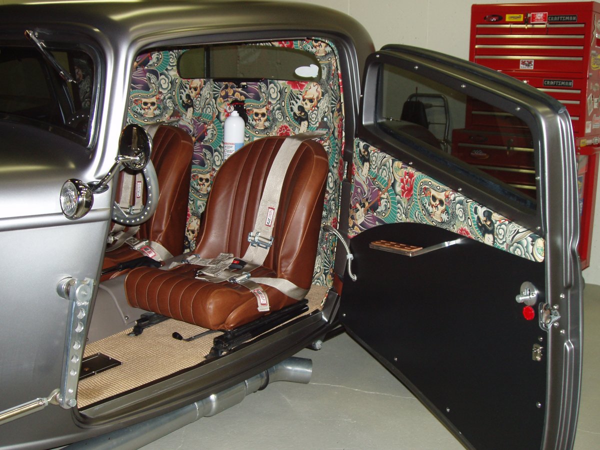

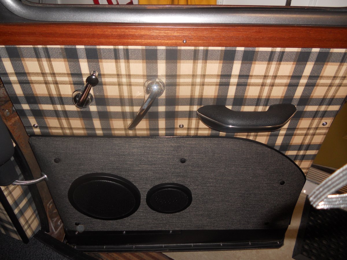

    Here are a few shots of previous Sintra useage.
    My '62 Fairlane Package Tray and Interior Panel, my '50 3100 Door Panel, which I glued 2" Rigid Insulation Foam to the Sintra, after shaping it on the belt sander, and my '32 Ford with Door Panels, BulkHead, and Headliner.
    Surfcityrocker and 50fish like this.

    2-3mm, depending upon your application. Too thin and it will not have any integrity.
    For the somewhat contoured Package Tray, like in my '49, I'd go with 2mm. For flat Door Panels I use 3mm.
    Sorry I never referenced Metric Sizing, I'm American!
    Select placement of 3M Double-Sided Automotive Body Molding Tape helps hold things in place, and I also like using face-applied Screws and #8 or #10 Plastic Snap Caps for Door Panels (as seen along the vertical door opening in the photo - light green/tan/and brown).

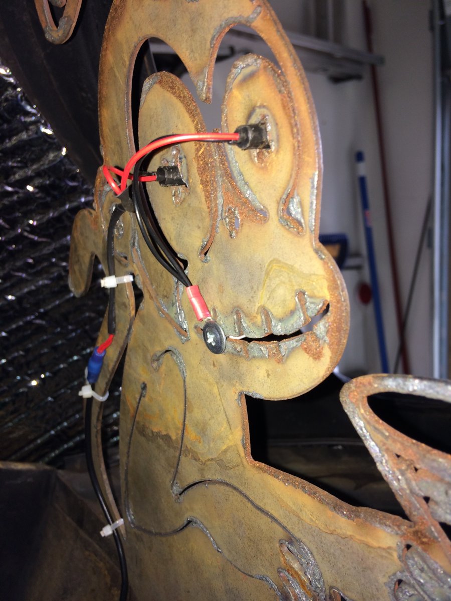

    Drunk Monkey is the Third Brake Light! His Eyes will light up once the wiring is completed.
    He came from SpeedCult, one of the best and most consistent vendors at the Daytona Turkey Run.
    I come out of there every year with a bag full of Crazy Metal! (It's always fun going through Airport Security with that stuff in my carry-on luggage!)

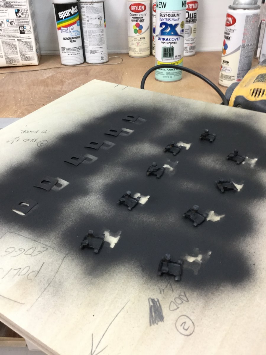

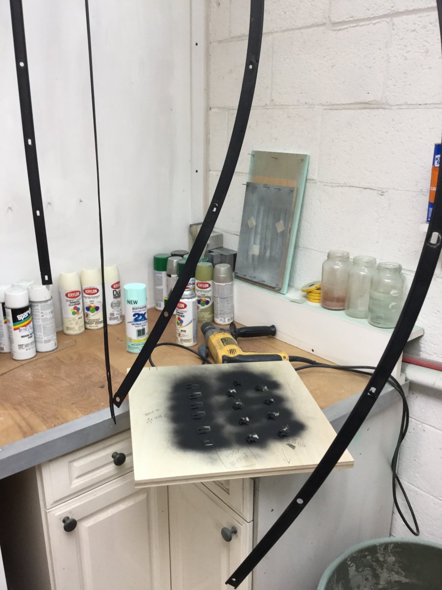

    More Trim is back on the Car.
    As earlier stated, the sheet metal under each piece of Trim was either ground to bare metal and painted with Rust Reformer, or on the thin pieces, hand sanded and Satin Cleared. I also put Clear Silicone Caulking in every Fastener Hole before reinstalling the Trim, as an added extra weatherproof precaution.
    All the clips were wire-wheeled and also shot with Rust Reformer.

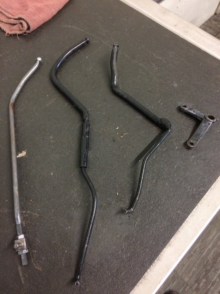

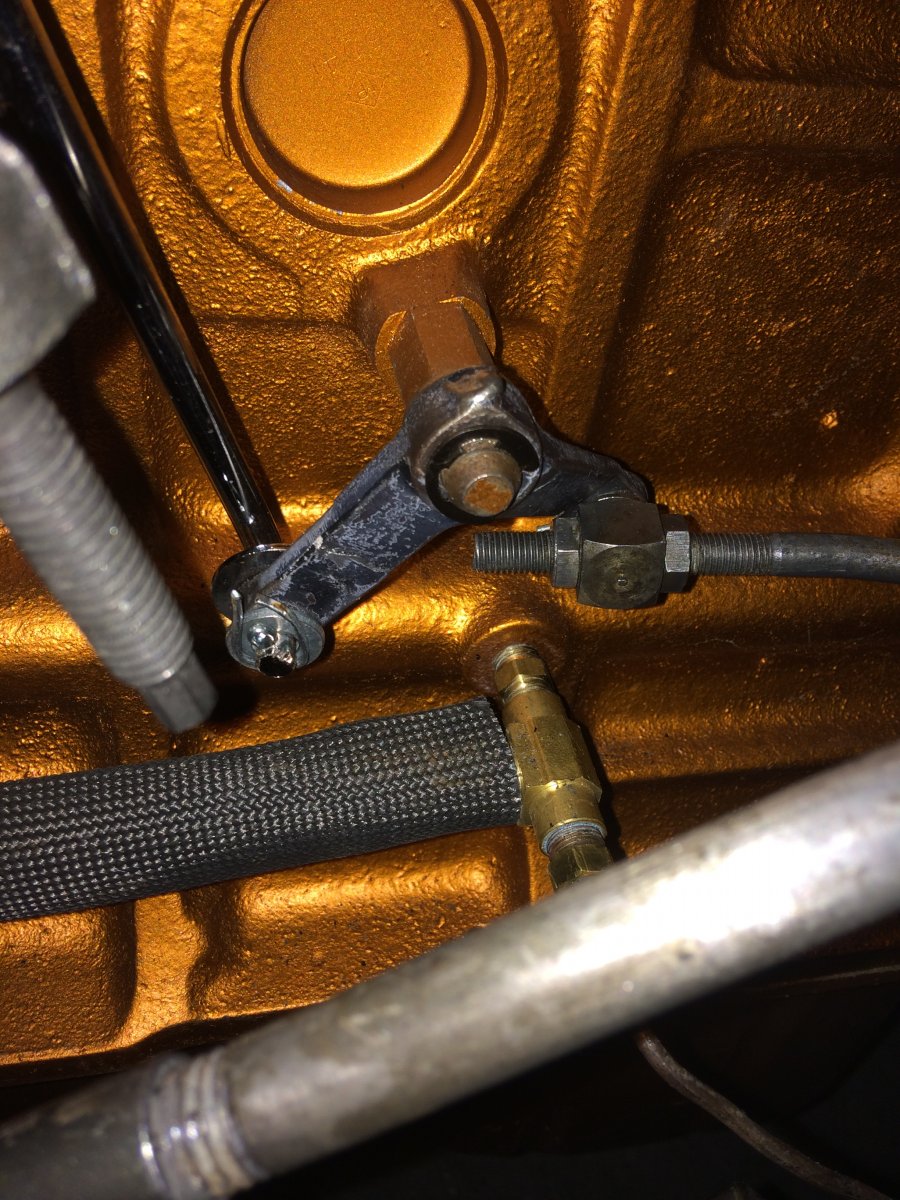

    1948 Pontiac Straight 8 Accelerator Pedal Linkage Rod!
    Who would have thought. The Engine swap was done before I got the Car, and the Accelerator Pedal was about 2" off the floor, with a hack Rod setup . The Rod pictured on the Right was the culprit, so I bought an original 1949 Rod which turned out to be 3" too long. I took the Rod off a Woody Station Wagon we have at the Shop, and it was a perfect fit! No Fab required.

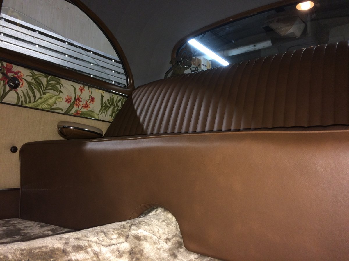

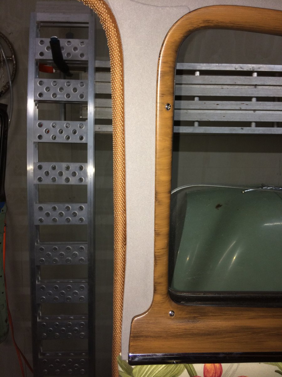

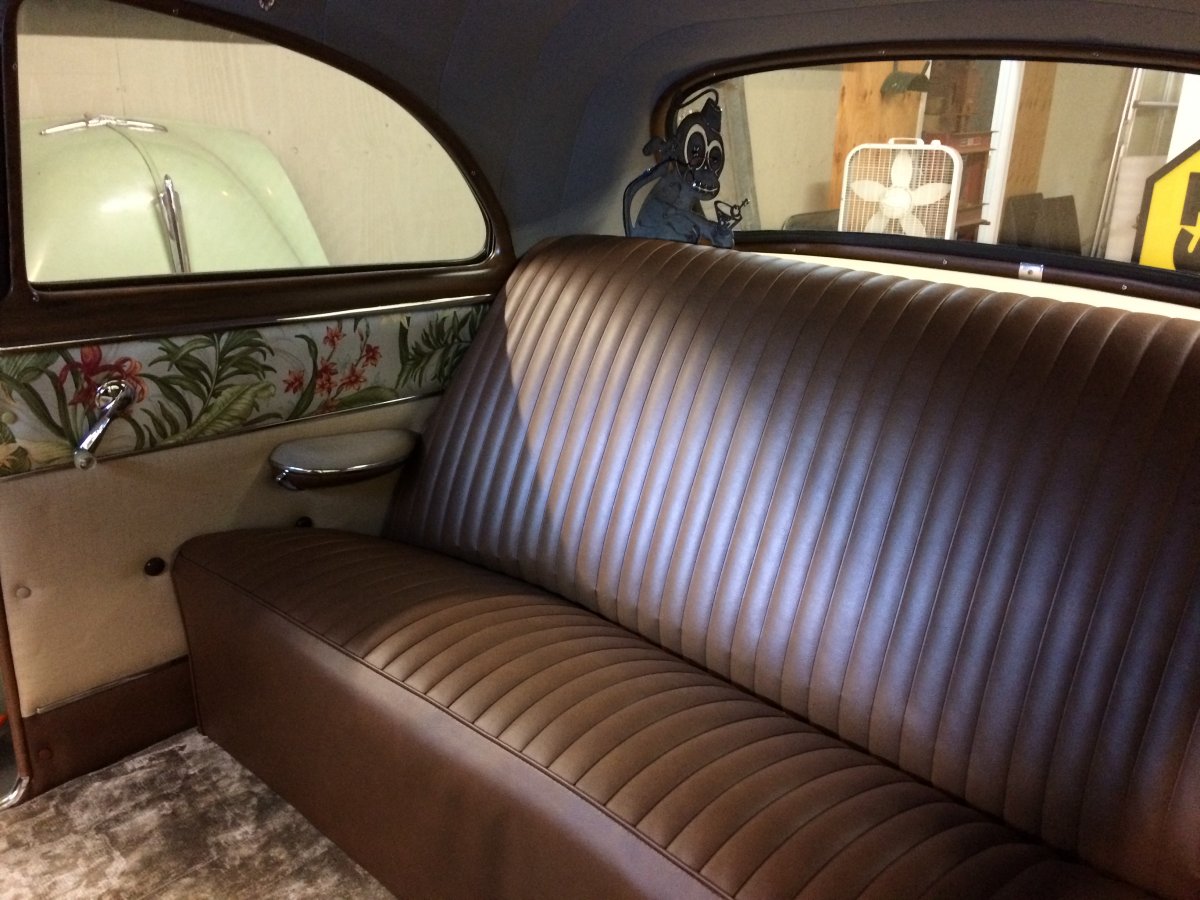

    The Interior is almost complete, as I fabbed new Upholstered Panels for the B-Pillars.
    The original cardboard panels were pretty beat, so I made new Sintra Panels, wrapped them with the extra material from the new head liner, and attached them with 3M Auto Body Molding Tape.
    I'll do the same for the A-Pillars, once I install the new Windshield.

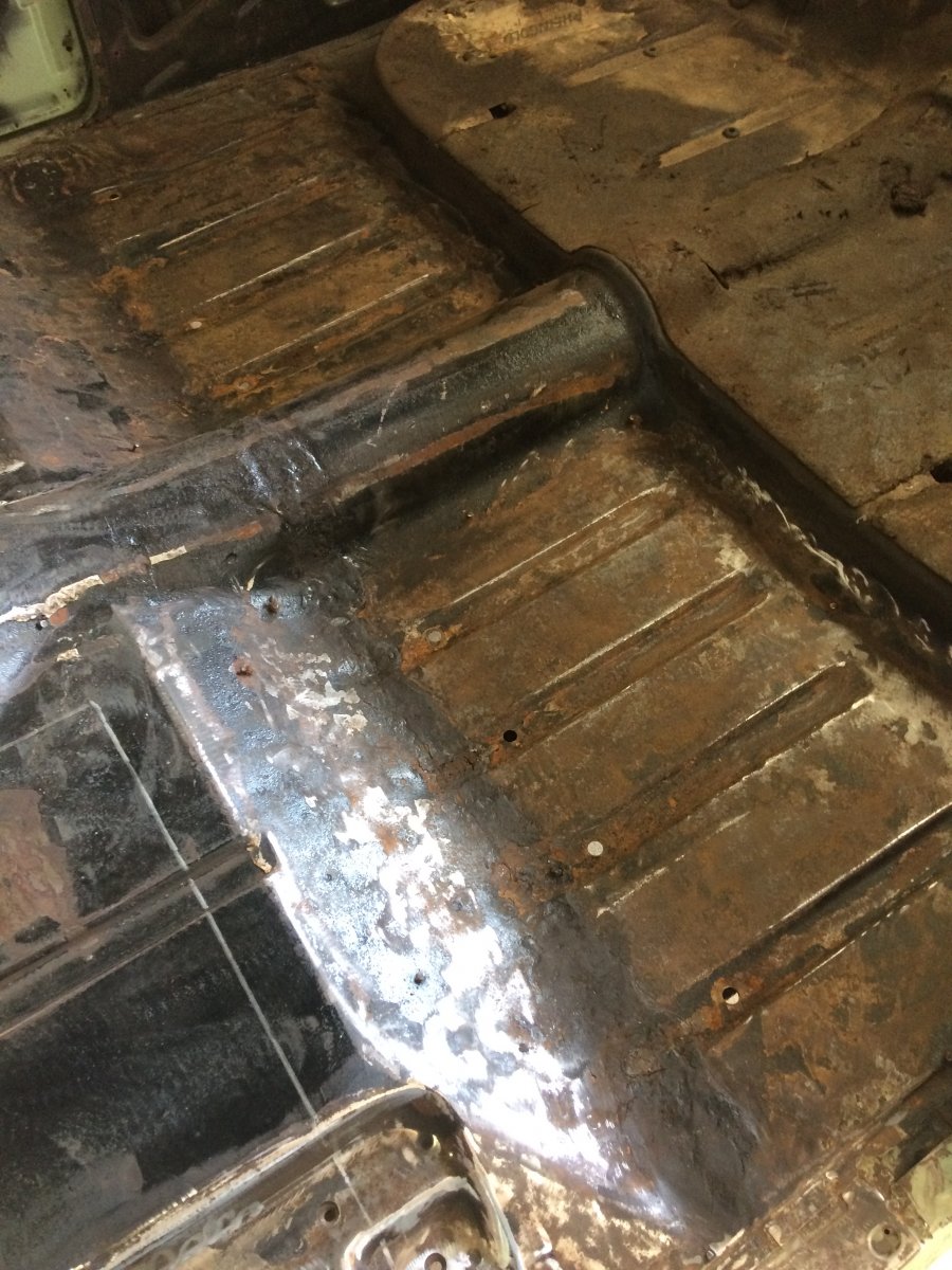

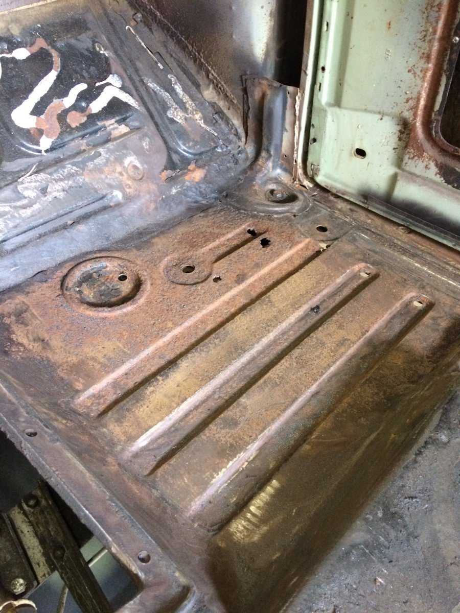

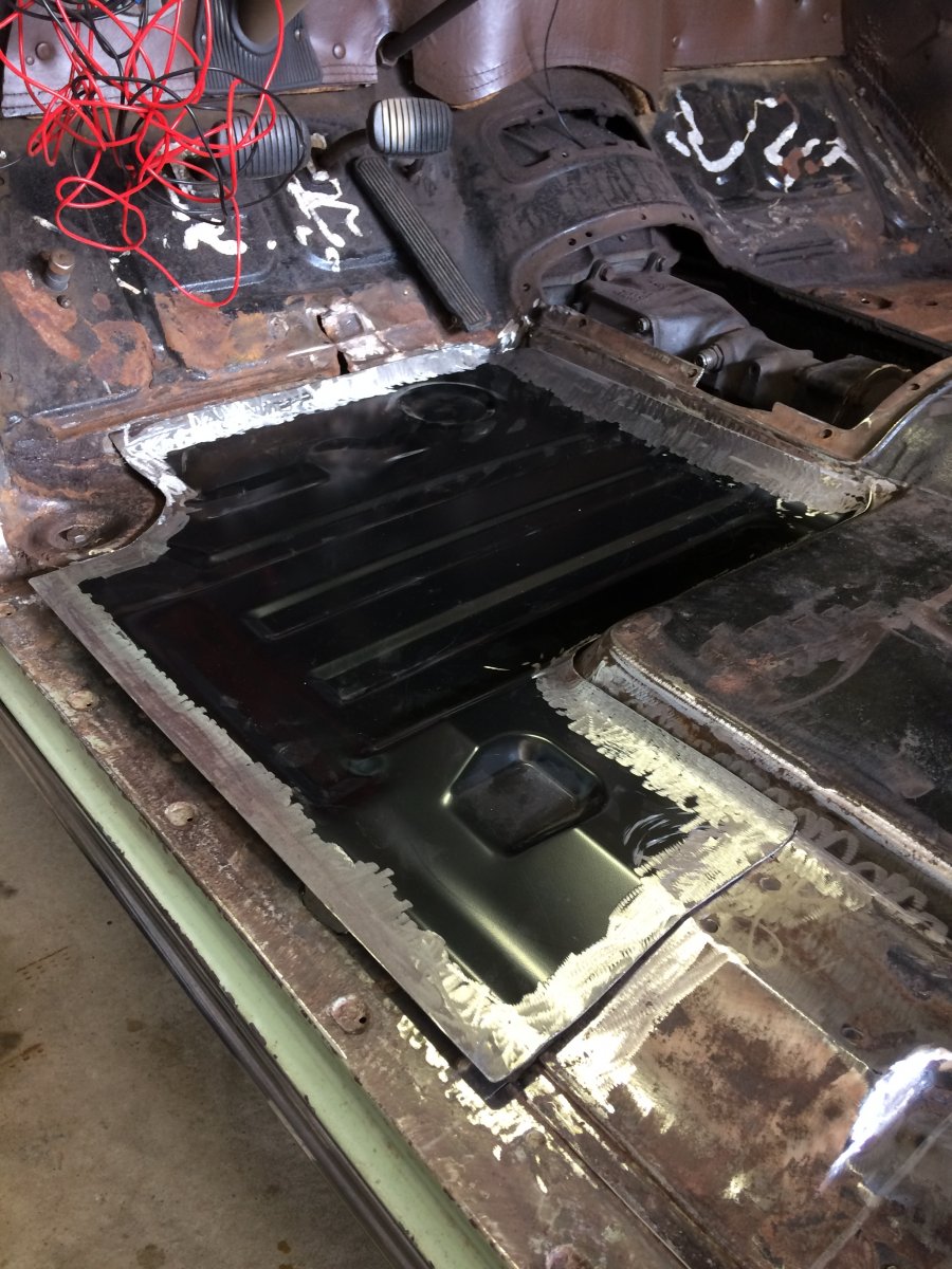

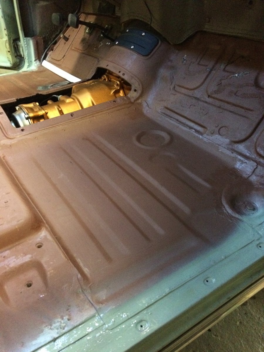

    Thanks! Yeah, I lucked-out. The Car is incredibly clean, with spotless door bottoms. The only other rust was the Battery Tray, which I replaced with a repop., and a small hole ahead of the Rear Driver Wheel where crud collected in the wheel well. I've cut that open and cleaned it out, but may just leave it like that. (Photo is Before Shot from the previous owner).

    Did you use the factory throttle linkage on the Weber carbs? I also have Tom Langdons carbs and upper linkage setup but haven't installed them yet. Just wondered if you used the stock 235 linkage and just tweaked and twisted until it worked?
  25. FrankenRodz
    Posts: 892
    FrankenRodz
    Post #74 best illustrates what I came up with for Linkage.
    It's a combination of Langdon's Upper Linkage, Mother Trucker's Linkage Rod only, basterdized cut/welded Pivot, and '48 Pontiac Accelerator Pedal Linkage Rod. (The Upper Linkage Rod had also been cut/welded by previous owner so I didn't want to waste time with it. It was the only useful part in Trucker's Kit for my application).
    Everything worked great with no modifications, except for the Pivot and Pedal Linkage Rod, which took some time to figure out.
    NOTE: Everything, including the E Brake had to clear the Dual Exhaust, which I'm hoping to complete the install this coming weekend, and will post Pics and Description. (The E Brake Rod had to be cut-down to stop short of hitting the front Exhaust Pipe).

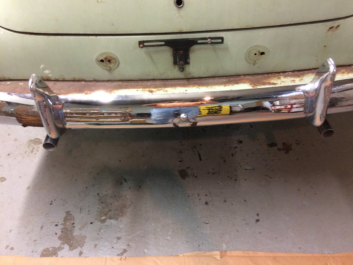

    E8E7CD17-F2B9-4957-93D2-59E56D52FCD0.jpeg E0AAF13F-29FD-47D3-9183-EADF86391BFA.jpeg Dual Exhaust is done!
    This was the Kit that comes with 3-Prebent Lengths per side (over-axle lengths were already in place when laid-out picture was taken), Gl*** Pack Mufflers, and Williams Cast Iron Headers.
    The Kit fit surprisingly well, just took some time laying it out. Definitely well worth the money.
    I had some Heat Wrap left over from another Build, so I wrapped the Pipes in the Engine Bay. Just enough to add a little extra heat protection right down to the side of the Oil Pan. This was a real tight squeeze around the Throttle Linkage and Emergency Brake. I cut-down the EBrake end to clear the front Exhaust Pipe. Still waiting on Heater Parts to come back from SandBlaster before I fire it up, so no report on how it sounds yet.

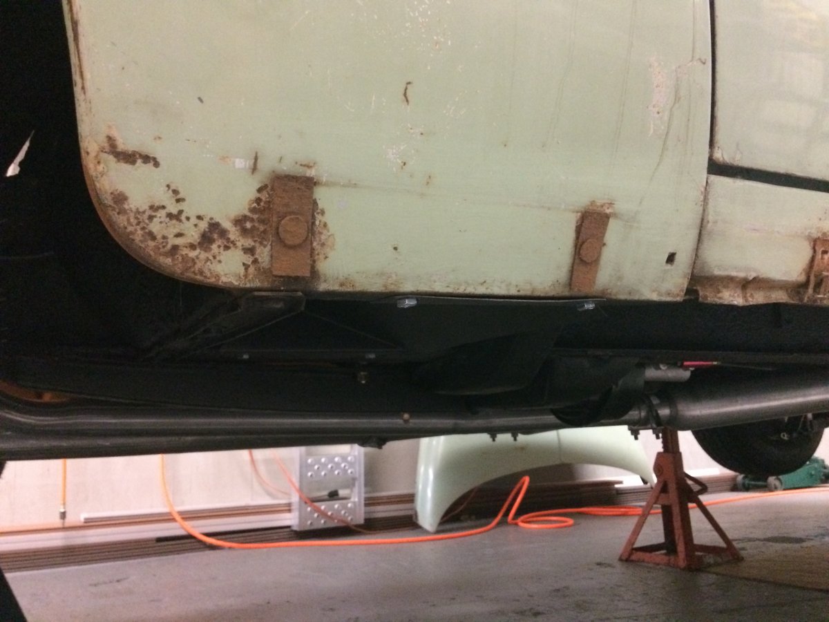

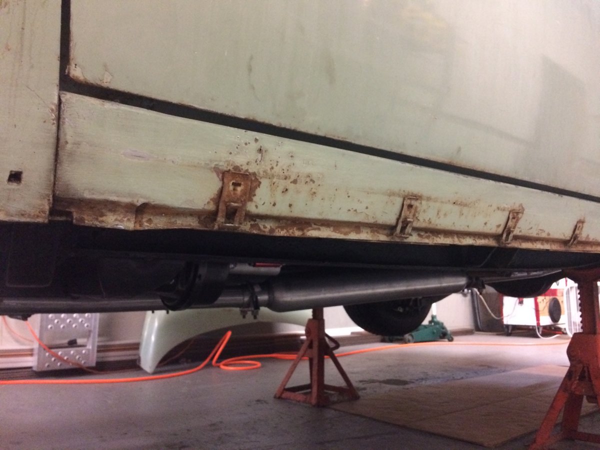

    Popped the Rocker Moldings off, and clean as a whistle! (Aside from a little surface rust).
    I wire-wheeled all the rust, and shot both entire Rockers with Rust Reformer.
    The Moldings are the only trim on the car that took a beating, so before I rework and polish them,
    please keep me in mind if you come across any NOS Moldings I can replace them with.

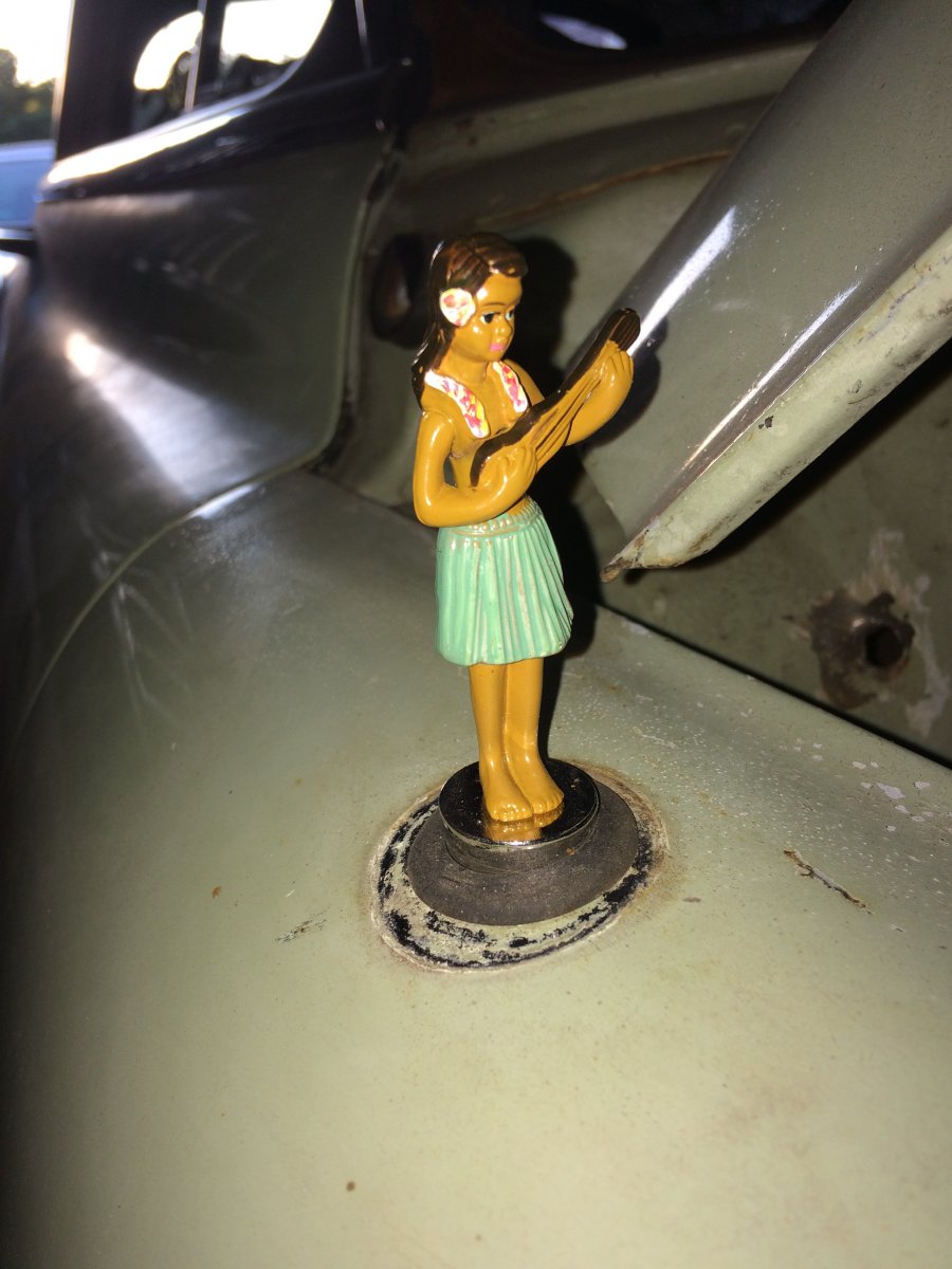

    In the meantime, here's my Antenna Replacement. I posted this on another Hamber's Post, but thought She should be added to this Timeline. A cast-metal Liquor Bottle Stopper, the ribbed rubber base fit into the Antenna Mast Fender Hole, and I slid an E-Clip between the underside of the Fender and the Rubber Stopper, so she will not pull out.
