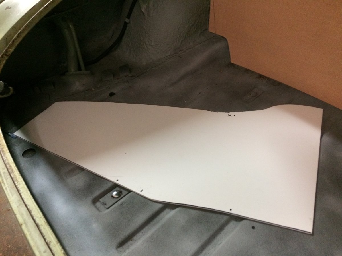

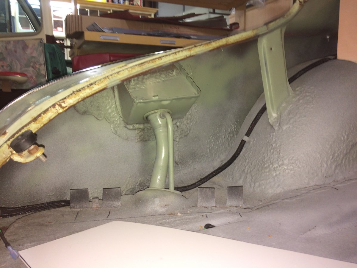

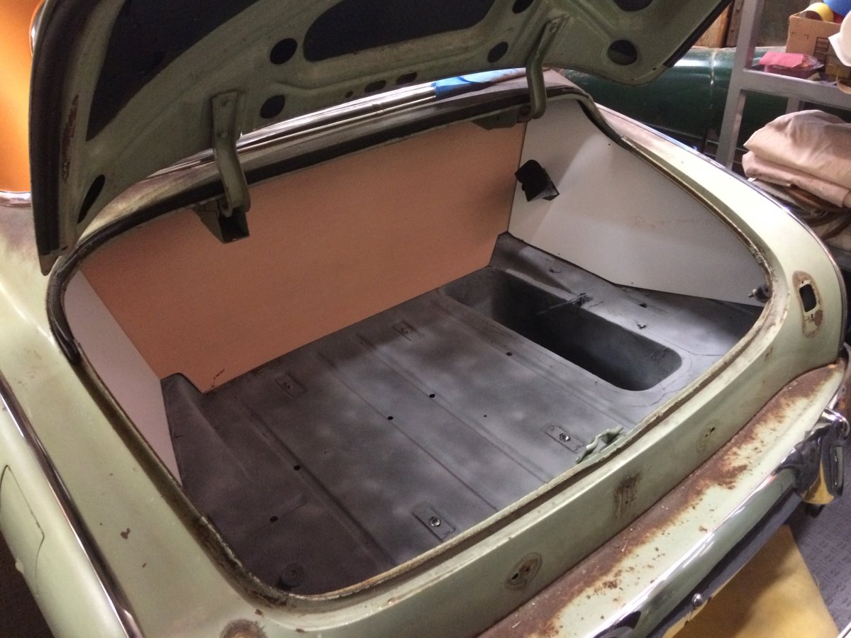

    F136447E-7C9F-4EB5-ACD2-6041599ED6DC.jpeg 7F5C61FC-8AA9-4702-AF3A-5F5ECE7F8E7D.jpeg 61EE011E-EC81-4D6E-AAC0-C115EF47C081.jpeg D16B623F-97E2-4DE4-ABD9-3E63C2055935.jpeg Trunk Progress -

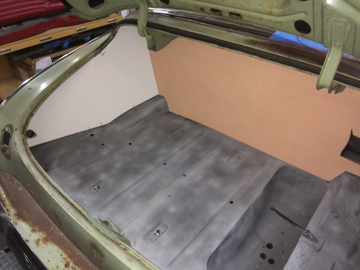

    The Trunk Panels are complete and ready for upholstery. My favorite Artist Doug Horne has generously provided some great Artwork for the main Panel, which is being printed on canvas. I’ll upholster the Side Panels today with the same basket weave fabric used in the Interior, but nothing will install until the Carpet goes in on the Floor. More Pics to come.
    Bowtie Coupe and Wayne67vert like this.

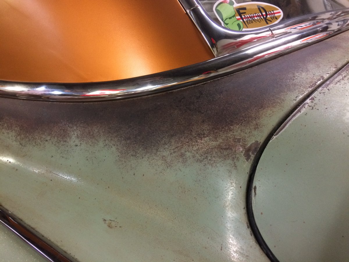

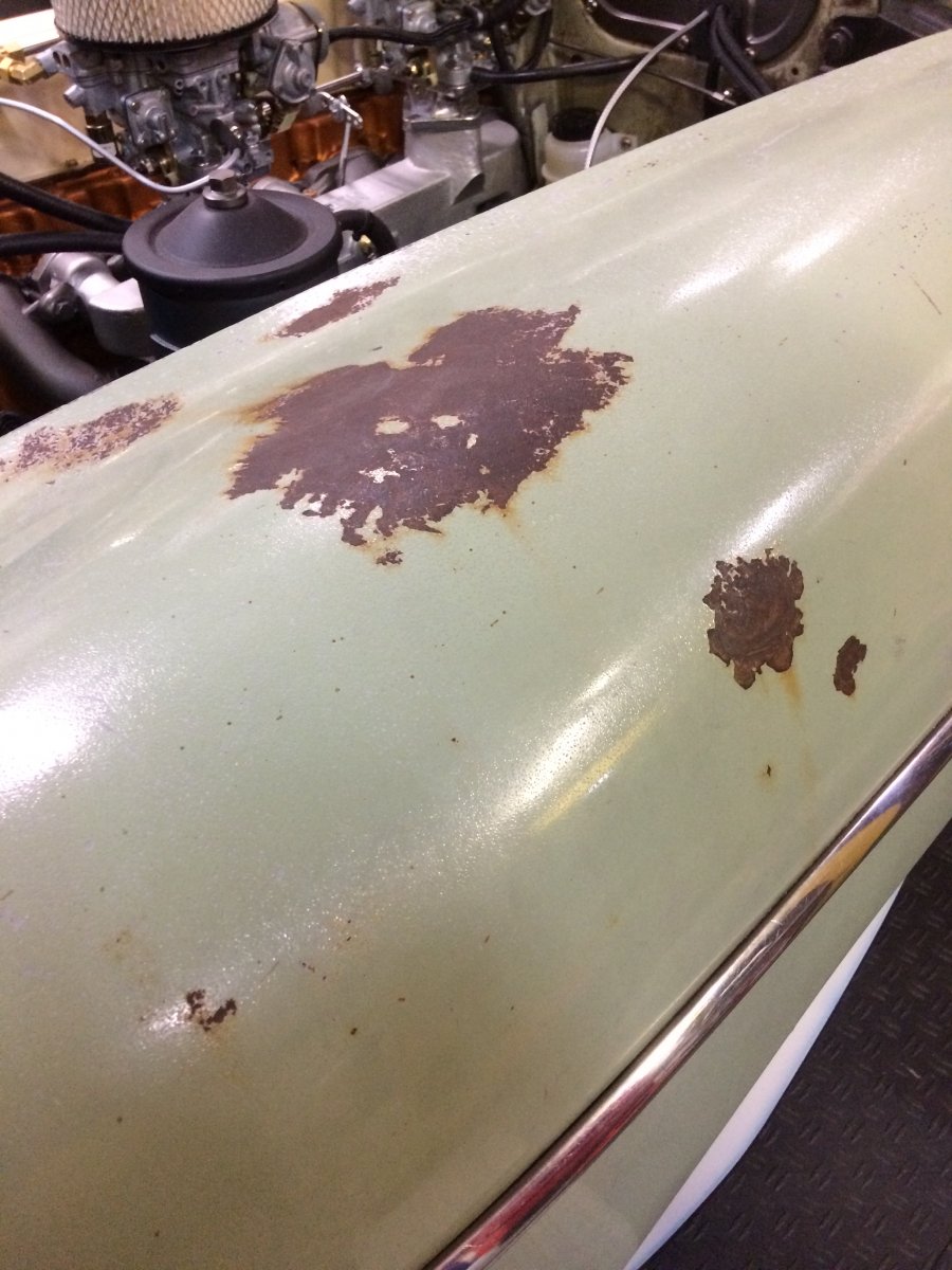

    5059AD5E-0BF9-4641-9E8E-3F34539F3970.jpeg 29E0ABF2-DDC3-4D77-962B-FC93A737A25D.jpeg 1C9E4637-AC22-44ED-A422-FBB3A530604C.jpeg B5029854-C07A-48CF-9818-0BB1EEFD676D.jpeg DA457502-89C8-49A2-BA95-6221D7DAAF0A.jpeg B5029854-C07A-48CF-9818-0BB1EEFD676D.jpeg B4AB6100-EDE5-4D06-B761-C90812153BC2.jpeg

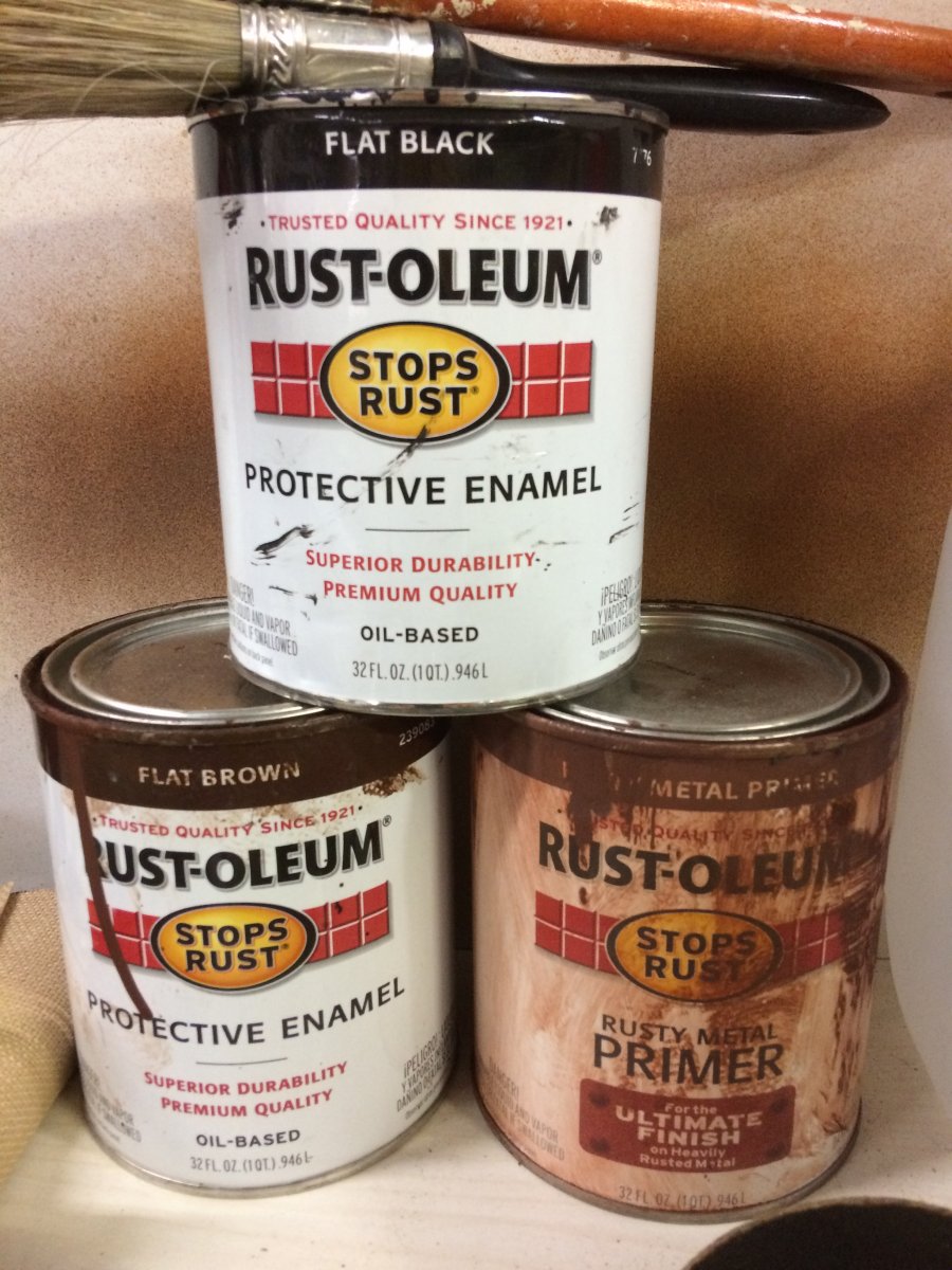

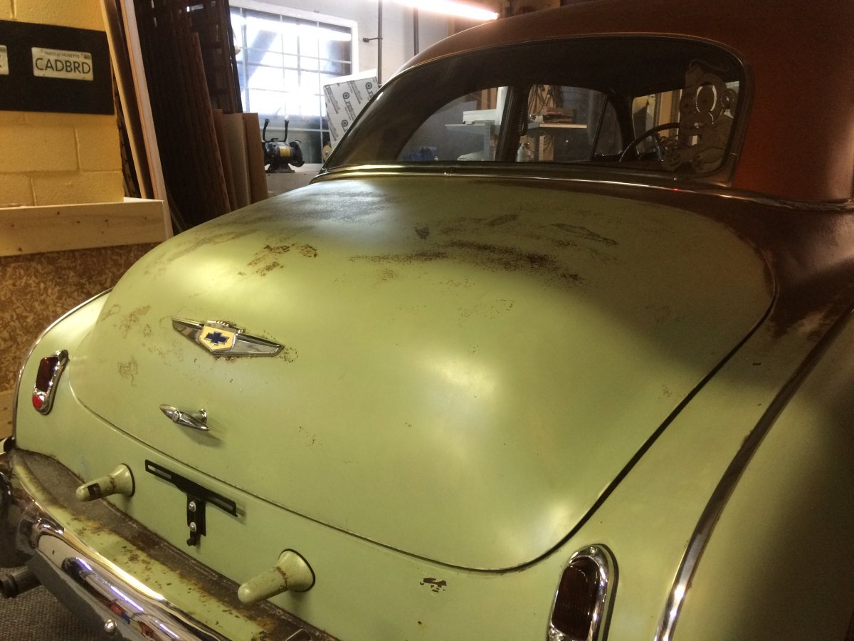

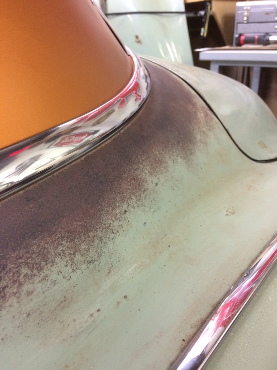

    Putting the Patina back...
    These cars rust like crazy where the water runs off the roof and collects under the Trim. I wanted to make sure it didn’t keep eating right through the sheet metal, but when sanding and rust-proofing I got a little carried away and burnt through the body paint where the moldings wouldn’t cover it. (Which didn’t work with the rest of the Patina on the car).
    I hate Fake Patina, but I think this combination of 3 paint colors comes close to matching the rest of the surface rust. (Trunk and Fender are Mother Nature). Of course the entire body will be sanded and cleared when I’m done.
    chryslerfan55 and Bowtie Coupe like this.

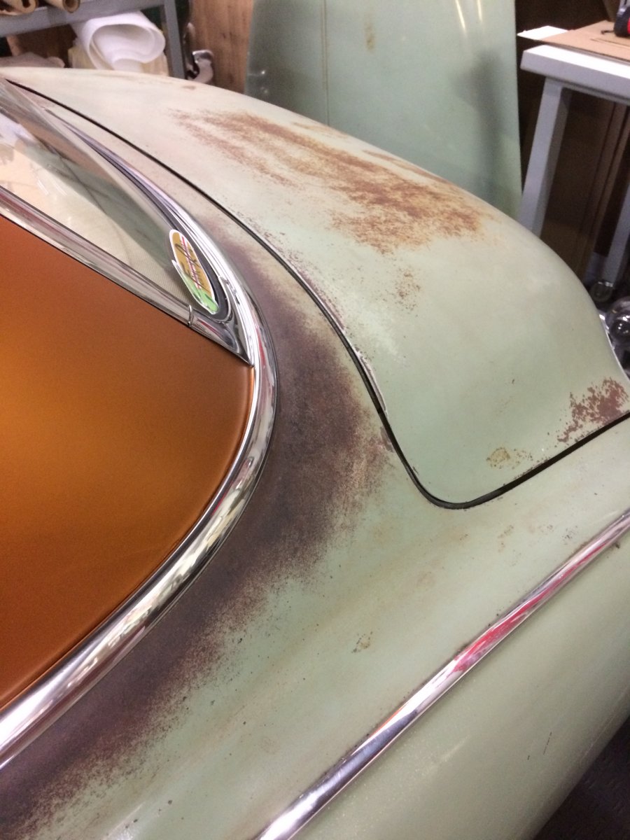

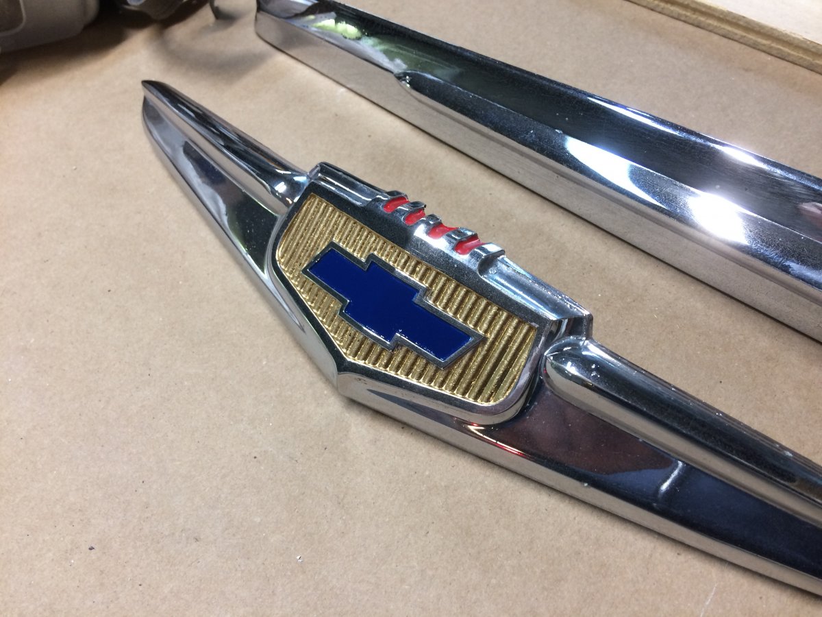

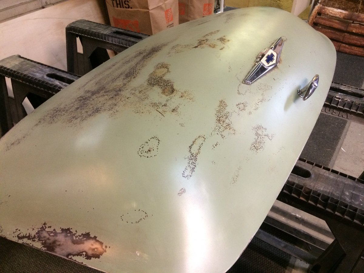

    Clear Coat completed on the Hood and Trunk Lid.
    The surface was dry-sanded with 220, and shot with 8-coats of Rattle Can Rustoleum Matte Clear.
    I didn't want to lose the 3-D patina, so special care was taken to not break the surface too much.
    The Clear Coat provides a good amount of build-up so you can run your hand or cloth over the surface without snagging.
    The Trunk Weatherstrip Channel is in great shape, so it was sanded and clear-coated also, before the new weatherstrip is installed.
    I also threw in a pic of the very little Bling on the car, the refurbished Trunk Lid Emblem.

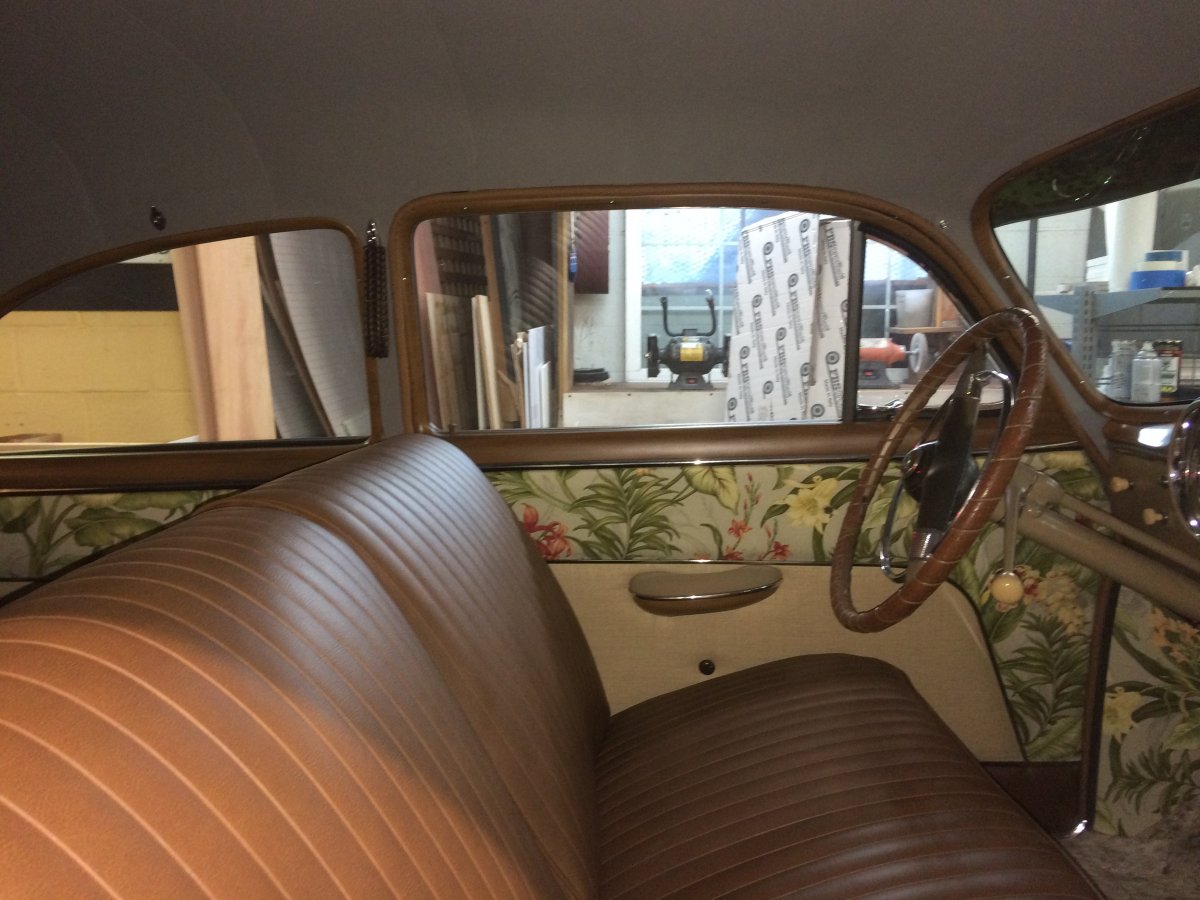

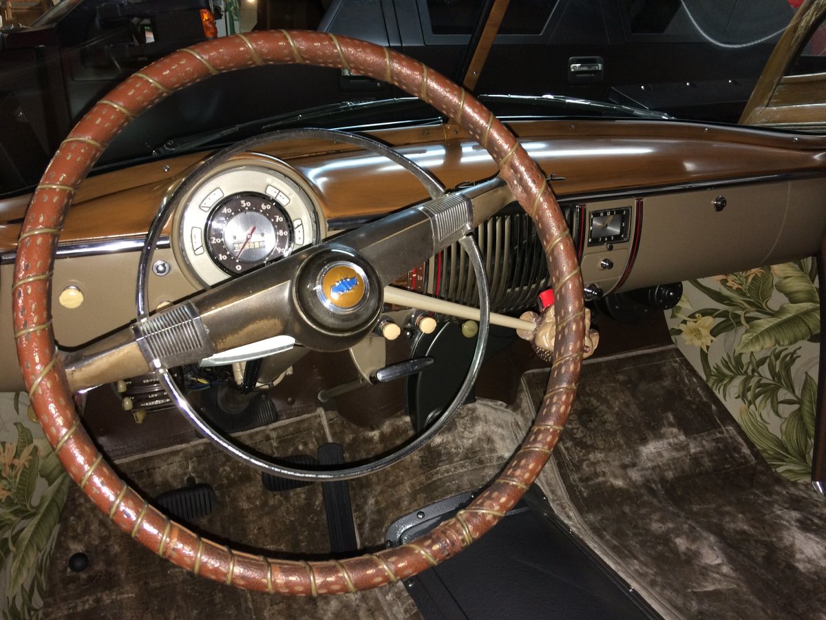

    Here's a shot of the completed Interior.

  22. FrankenRodz
    Joined: Dec 20, 2007
    Posts: 892
    FrankenRodz
    The Steering Wheel Cover was on the car when I bought it. It's the standard-issue laced-cover that's been available forever. I just did an InterWeb search and they're still being sold. Since this pic was taken, I scrubbed the cover with cleaner, and it looks brand new!

    Creativity in this build is top notch- you are the master at fake patina- yours looks so real where you had to replace after repairs-
