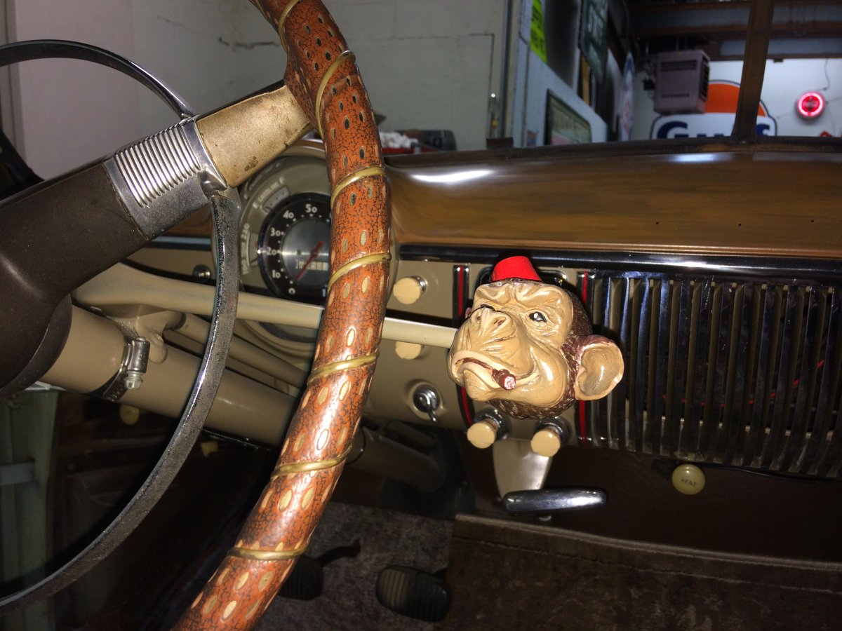

    You don't smack your hand on the shift knob when turning the steering wheel?
    I had to remove my Monkey Head because he was right against the wheel in 1st gear!

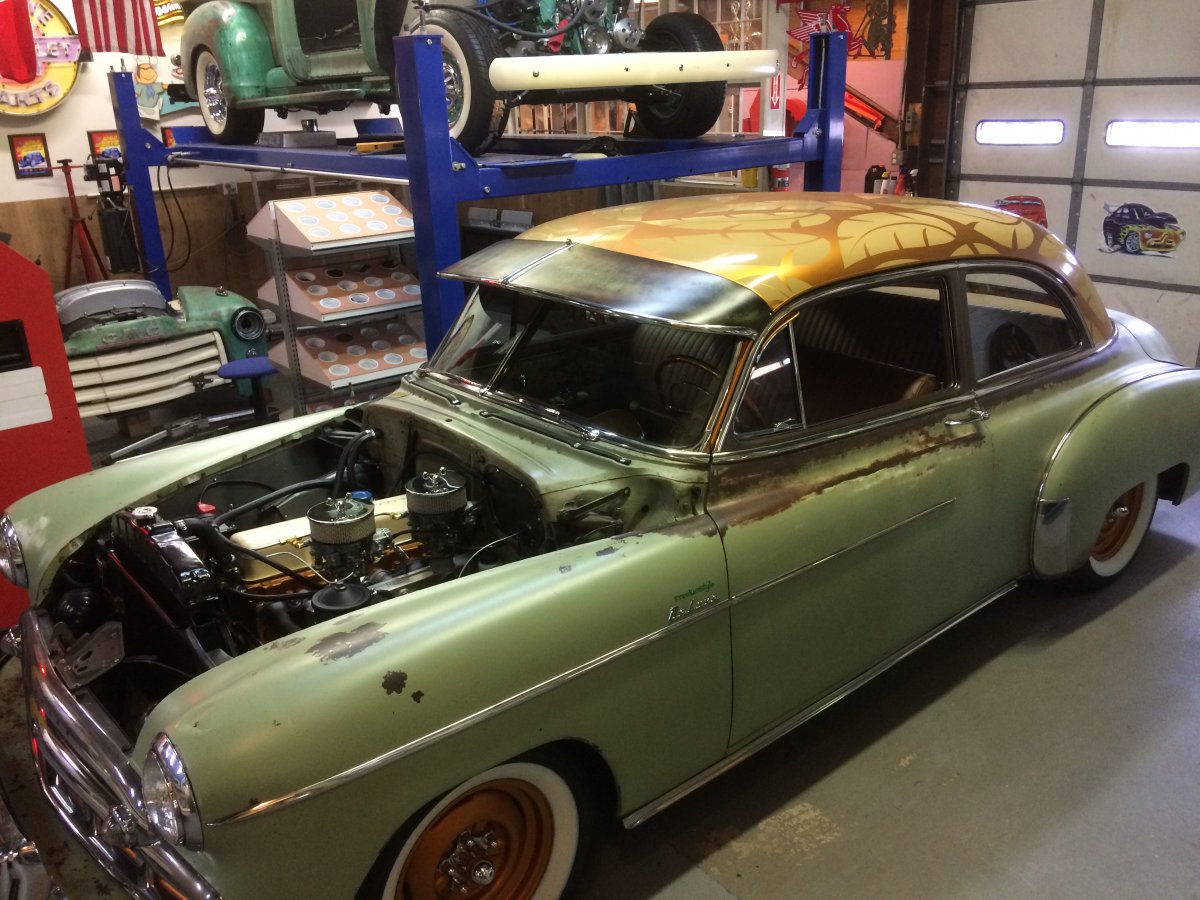

    Thanks! Can't wait either to get good Pictures. The Shop is so crammed right now, I couldn't get good overall shots for the Insurance company. Boston World of Wheels should be a good opportunity, and I'll post those Pictures.

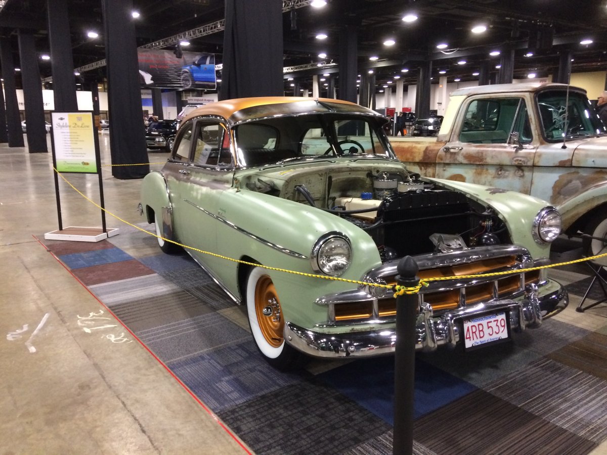

    First Place Award for Nostalgia Custom Class at the 2018 Boston World of Wheels.
    Thanks to everyone that stopped by and said Hi. The great response to this Build has been very much appreciated, and inspiring.

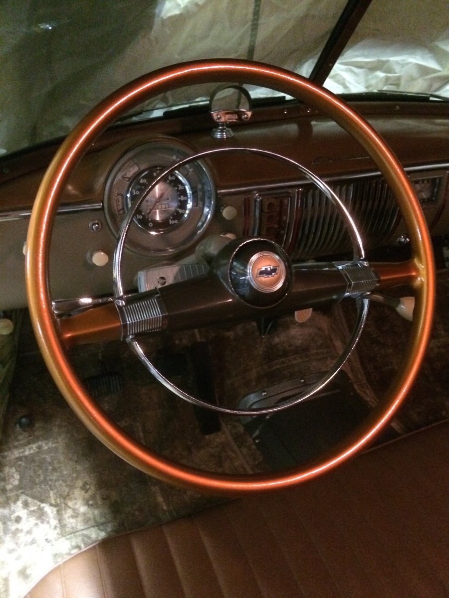

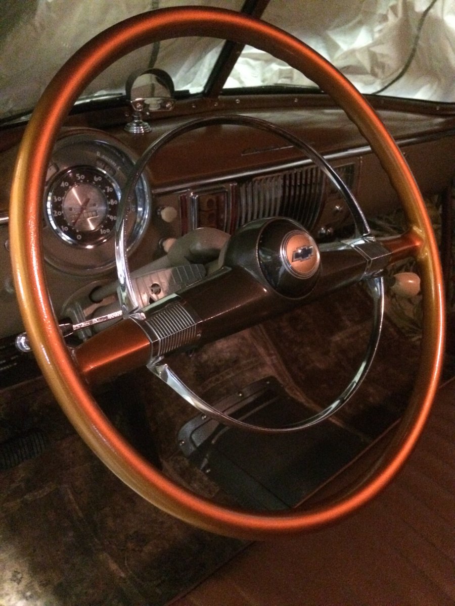

    Steering Wheel Redo -
    When I took the original steering wheel off to repaint it, I found that under the wrap were two channels cut right into the ring, likely to accommodate a steering wheel spinner. Not a tough repair for an otherwise very good condition wheel. However I scored another wheel for $57., and after a day of sanding and prep., I was able to shoot it with color and install it all in one day.
    - Metallic Bronze Rustoleum Rattle Can, with gloss clear coat, to match the center cap.
    - Orange Metallic VHT Rattle Can, with gloss clear coat, to match the outside touches.

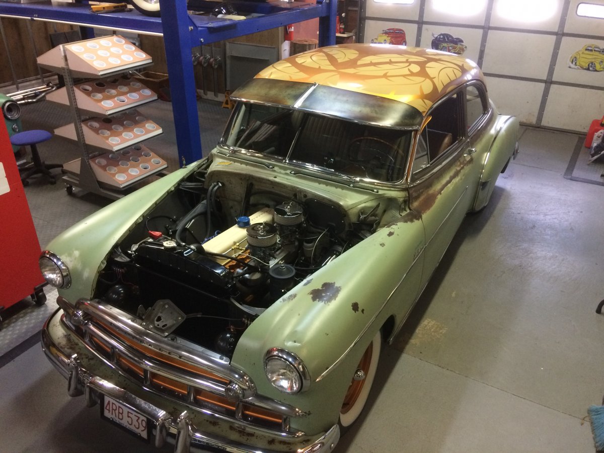

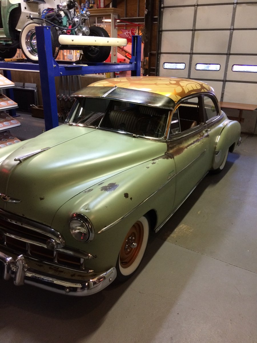

    A little Tiki Touch for the Roof.
    Now I just have to put the Hood back on and the Car is officially done!
