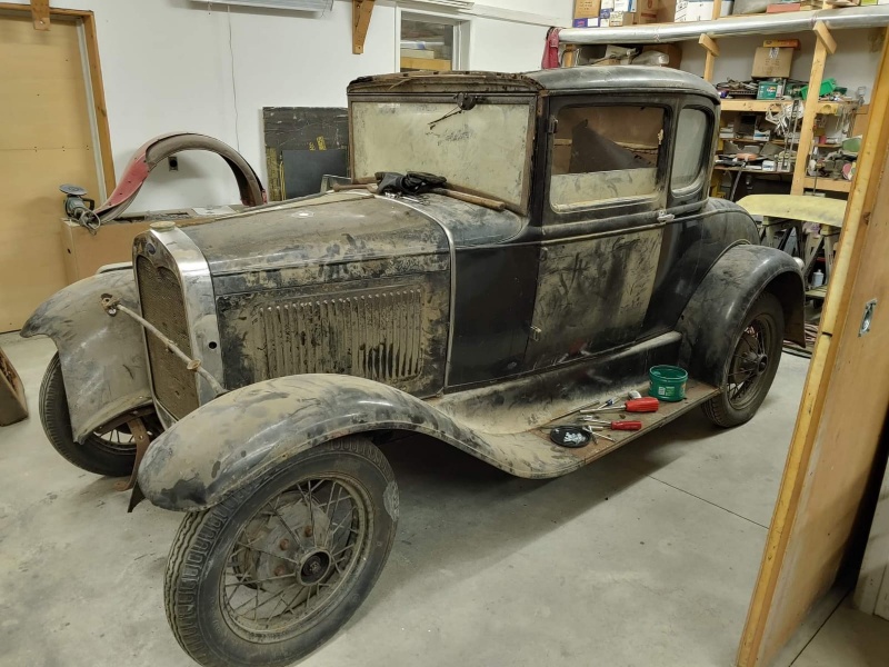

    Hello, I wanted to introduce myself and my 4-banger.
    My name is Harald, Harry is my nickname, and I'm from Braunschweig, Lower Saxony, Germany.
    Now I want to build what I consider a traditional hot rod, keeping its engine and most of its ch***is. It will have a Legacy roof,
    a front axle from the '32, and will be lowered further with the springs.
    I'm also installing a Volvo M40 transmission, but we'll keep the torque tube.
    The engine will be completely overhauled.
    I bought a '31 coupe that was roughly ***embled for shipping to Germany.
    Here's where we start, let's get started.

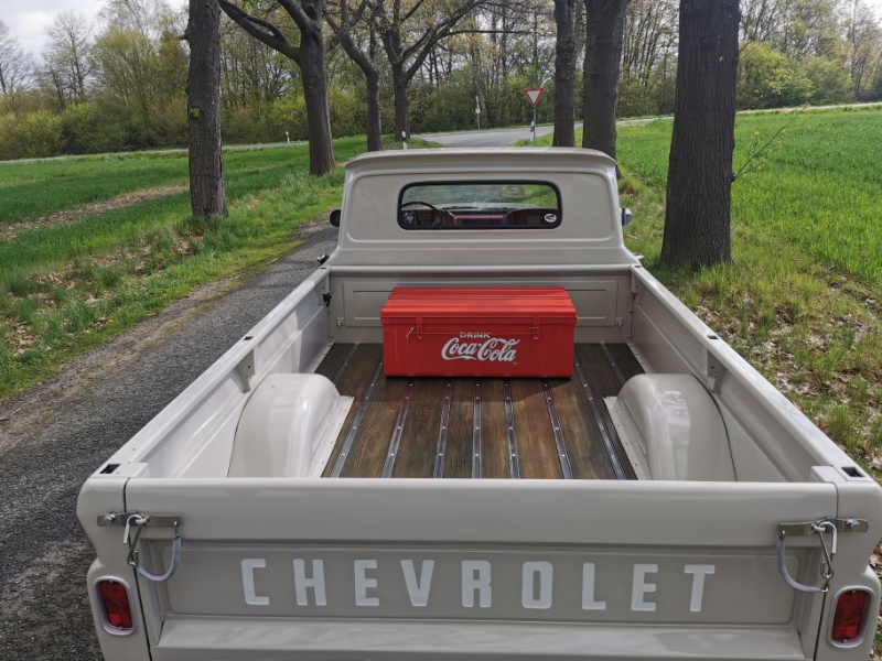

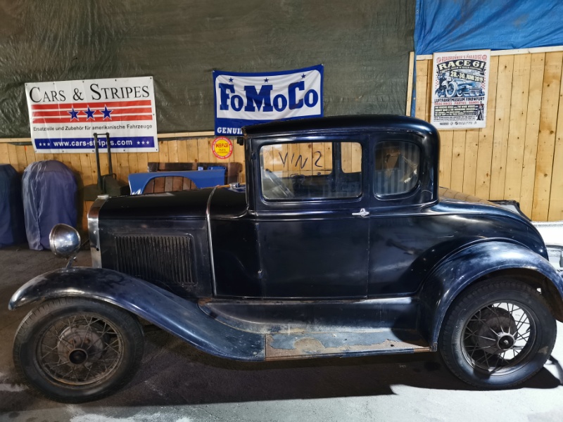

    This is what it could look like, the photo was taken by some friends racing on the beach in Rømø, Denmark. If your friend is reading this, it's a great car.
    Greetings Harald

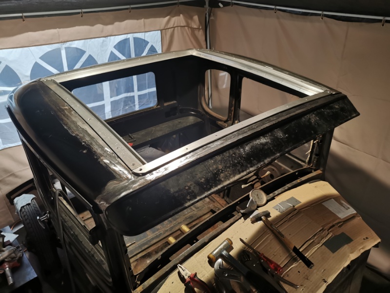

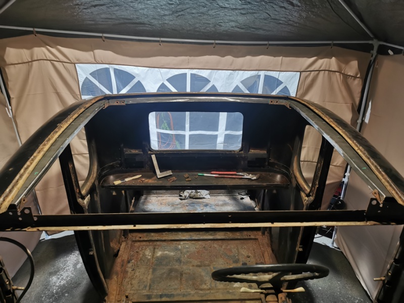

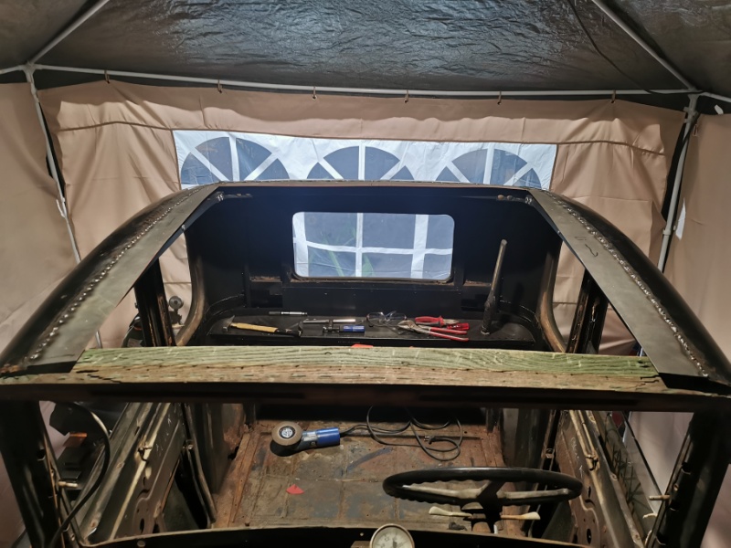

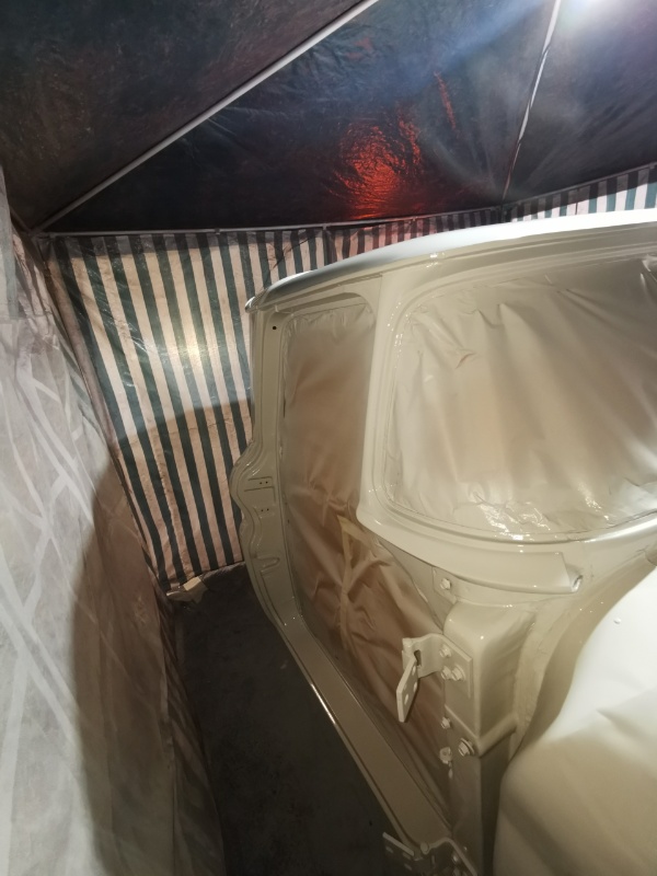

    Thank you for the nice welcome, it is my first contact with a Model A. Now the roof structure is in progress and for this I have to dismantle the upper roof frame, the front head section and the sun visor were already missing, the roof frame is being rebuilt in box tube, sheet metal strips have to be welded all around the roof cutout, off we go
    Paint was also added again
    Greetings Harald

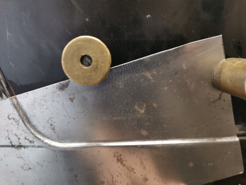

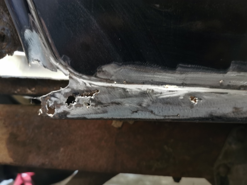

    There was still a hole in the quarter panel, I made a patch, I don't have all the fancy machines, so I hammered the outline onto a piece of steel beam. Greetings Harald

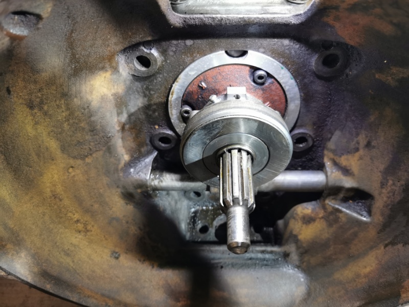

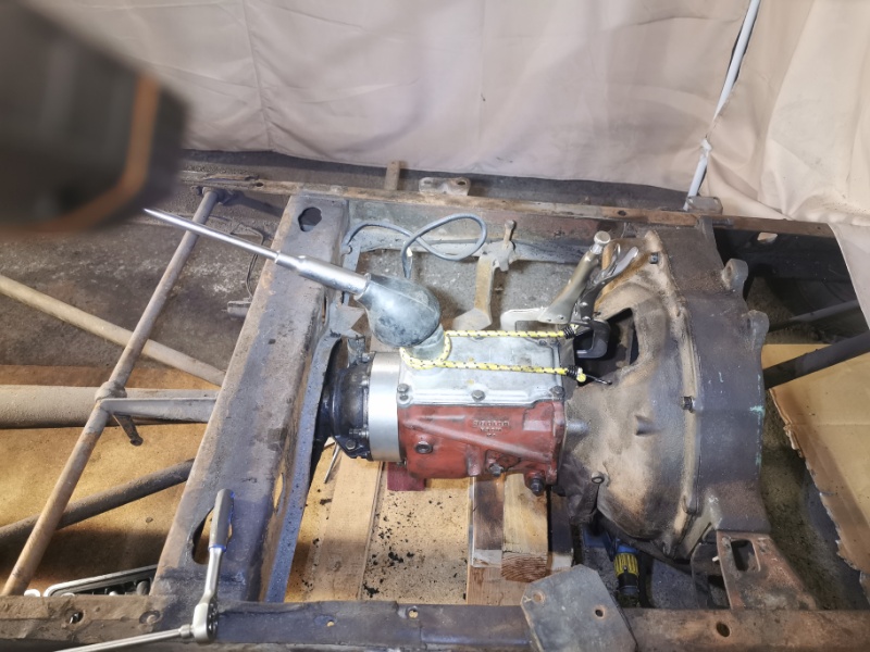

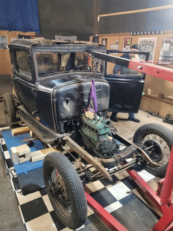

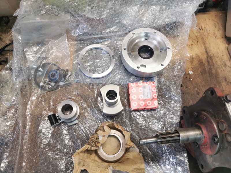

    We removed the body from the frame, now the Model A gearbox could be removed and the Volvo M40 gearbox with truck bell housing could be installed, it fit surprisingly well, all the screws went into their place, the conversion kit contains everything you need for operation.
    The conversion kit is available here in Germany, a stroke of luck.
    Now put everything together, shorten the output shaft, insert the bearing and press in the adapter universal joint and put everything together, drill a hole and cut a thread in the shaft and the original screw from the Model A is in its place.

    Nice work, what era is the Volvo gearbox? 3/4 spd? Did these have O/Drive?
  19. Deutscher
    Joined: Nov 12, 2024
    Posts: 343
    Deutscher
    from Germany
    Hi Baumi, are you still driving your 30?
    A Model A with a G28T is a great car, my engine is currently at the repair shop and is having bearings installed.
    From the 1961 model year, the new M 40 gearbox was installed together with the B18 engine in the PV (Buckel) and P120 (Amazon) models.
    The M41 has a Laycoc overdrive, but the torque tube has to be m***ively rebuilt for this, or switched to an open drive.
    The M40 is a fully synchronized 4-speed gearbox.
    The last gear is the same - 1/1, but the gear ratios in the other gears are more evenly distributed in the M40.
    Model A:
    1. 3.12:1
    2. 1.85:1
    3. 1:1
    M40:
    1. 3.13:1
    2. 1.99:1
    3. 1.359:1 or 1.362:1,
    4. 1:1
    Greetings Harald
