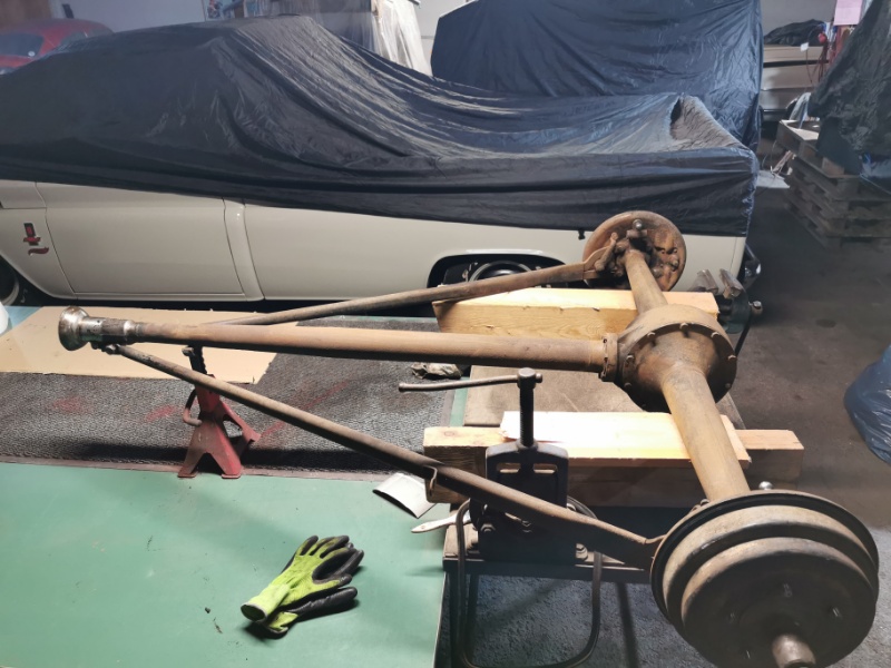

    Done, the spring is out.
    I had to tweak my spring tensioner a little so that I could turn the nuts,
    the shackles are badly worn,
    that will also be replaced.

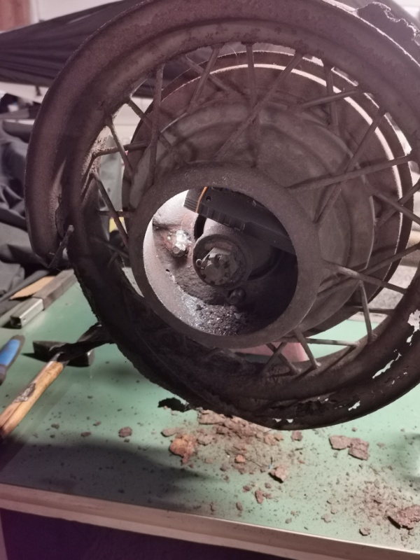

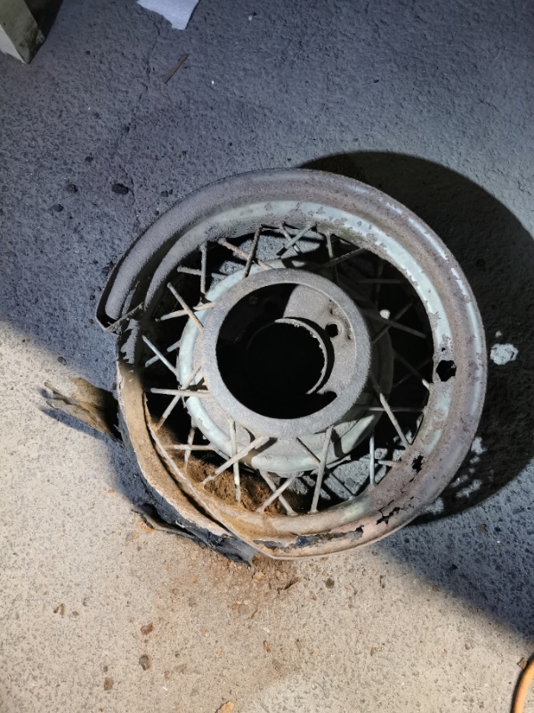

    The 32 axle still needs to be dis***embled and I've started to pull the rim off,
    I think the rim is lost, LOL
    Someone tried to open the wheel nut with a torch, I milled it off and got it off,
    the brake drum is absolutely solid,
    I hope that I can save the spindles and perches, the drums may be lost,
    so I'll probably build the 31 brake,
    I probably won't find a 32 brake in Germany.

    So press some fresh studs in the drum. The 12” brakes from the 32 will be much better than the A’s.

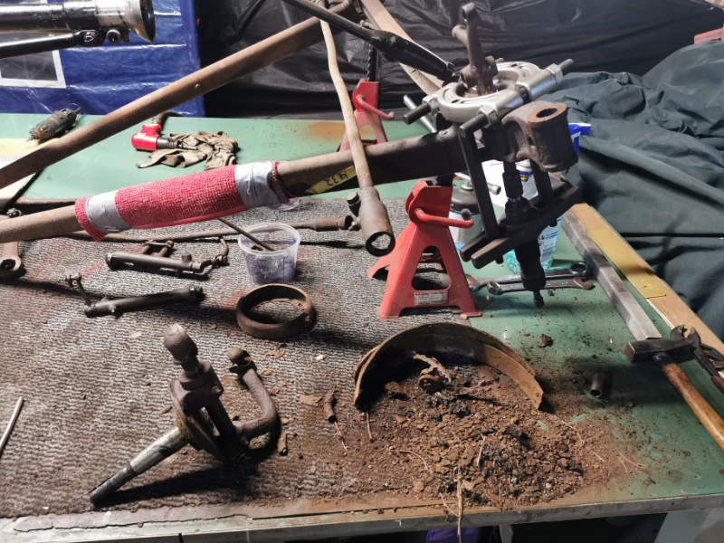

    What a struggle, but the brake drums are now free of their rusted-in shackles.
    The good thing is that I was able to save the spindles.
    Unfortunately, the drums cannot be saved; they are too rusted to be machining the Surface.
    The spring perches are not looking good either.
    The thread on one of them has already gone and I need a replacement.
    The two front brake actuating units are in good condition.
    I have all the important parts to install a 32 axle in the Model A and keep the rod brake.
    Greetings Harald

    Welcome and great looking car! If you stay with the A brakes get the cast iron drums, will stop you much better than the old steel ones.

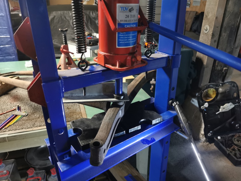

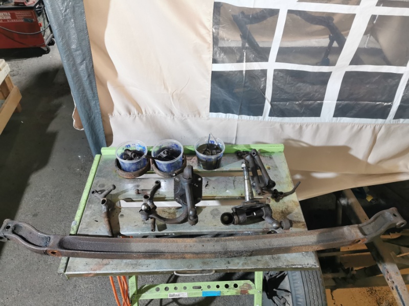

    The 32' axle has been dis***embled, the spindles are good for further use,
    I pressed the perches out, with heat and a 20t press, it made a good bang, unfortunately the threads have rusted away,
    but otherwise it is amazing that every screw could be turned and left its place, I think the axle has been lying outside for a very long time and there is still so much usable, great.
    Greetings Harald

    Joined: Sep 27, 2002
    Posts: 23,465
    alchemy
    You could sandblast the perches, TIG weld the threads, then cut fresh ones in a lathe.

  12. Deutscher
    Joined: Nov 12, 2024
    Posts: 467
    Deutscher
    from Germany
    That's a good idea and worth a try.
    I'll have to find someone who has the skills to do it,
    thanks for the tip.
    Regards Harald
    catdad49, winduptoy and Okie Pete like this.

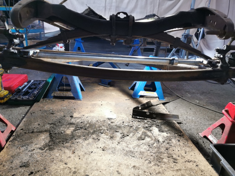

    Now the frame is stripped and the 31 front axle and brake removed, while the backplate and everything around it is in a clean condition, the drums look like a vinyl record, let's see if they can still be turned out.
    Putting new cast drums on the old hub means a lot of work, milling off the crushed old bolts and pressing them out and and and....
    Just read that the steel drums must not be turned out, if that is true, they will probably be new drums.
    Greetings Harald
