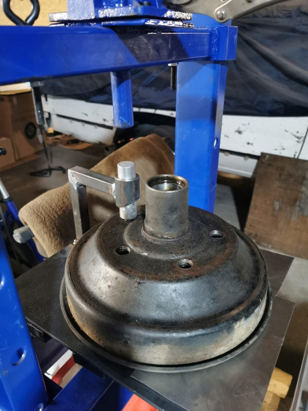

    The brake drums were separated from the hub, I opened the bolts from the press with a hole cutter.
    Then the bolts came out very easily.
    I dis***embled and cleaned the front backing plates, and welded up and straightened the worn areas on the roller tracks.
    Greetings Harald

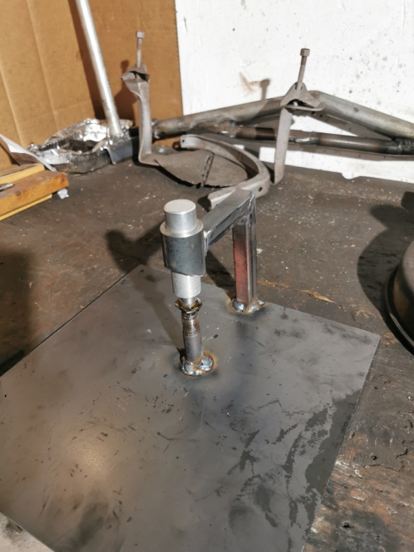

    My parts are still in the container, the engine isn't finished either—should I be upset? No. We're doing some minor work, like making a jig for pressing the wheel bolts.

    the brake drums were re-pressed with the hubs and new wheel bolts,
    and I still need to have the brake drums turned out. The spindles got new bushings and are in a workshop where they're being reamed to fit. The 31' shackles are getting bushings to fit the 32' spring perches. Things are slowly getting back on track. Unfortunately, the engine isn't finished yet, but progress is slowly being made there, too.

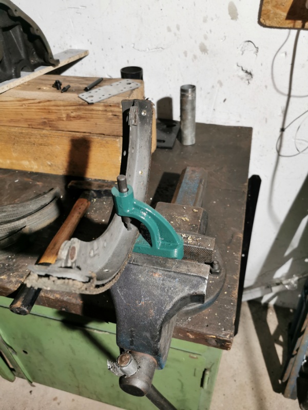

    The Brake Shoes were adapted to the brake drums.
    Greetings Harald

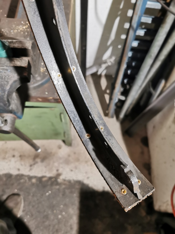

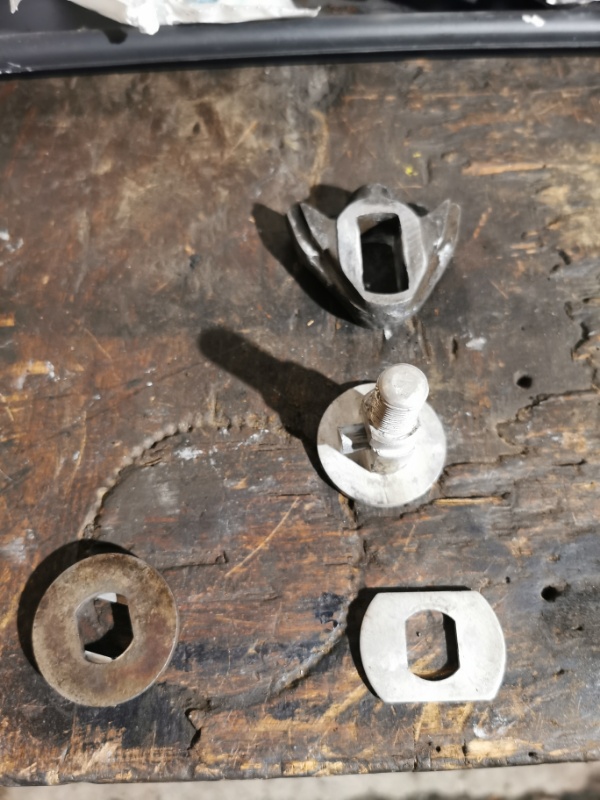

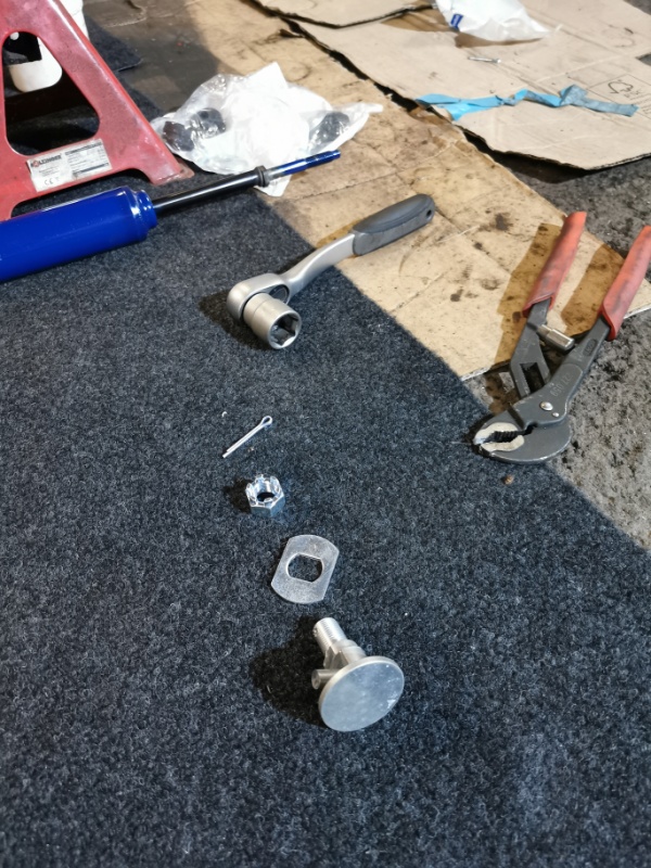

    I installed the brake shoes;
    I got a floater kit from Snyder's for that.
    Unfortunately, the brake wedge was jamming because the rollers were being pinched by the brake shoe, which was annoying. The rear washer is too thin, so I used the original washer and that solved the problem.
    It works as it should.
    On the right side, I couldn't get the brake drum over the brake shoes, so I reworked the pads. Then I swapped the adjuster for one from the 32'. That was even worse, but it seemed to have cleared the thread a bit. After that, I was able to turn the one from the 31' back further, and the drum now runs freely.
    The old man is a bit reluctant, but we'll work it out.
    Regards, Harald

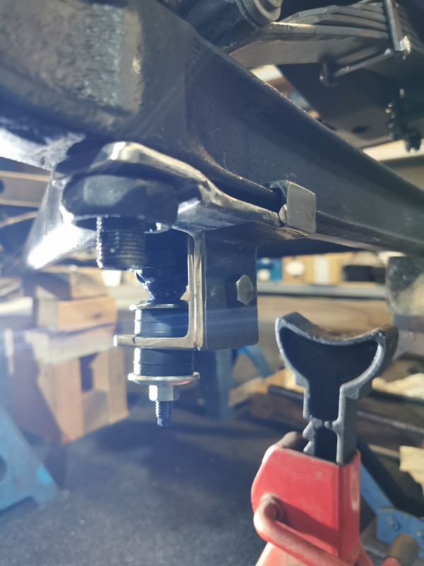

    In order to ***emble the axle, I still need the shock absorber mount, which should also fill the 1/4 inch gap between the wishbone and the axle, this is what I have now.
