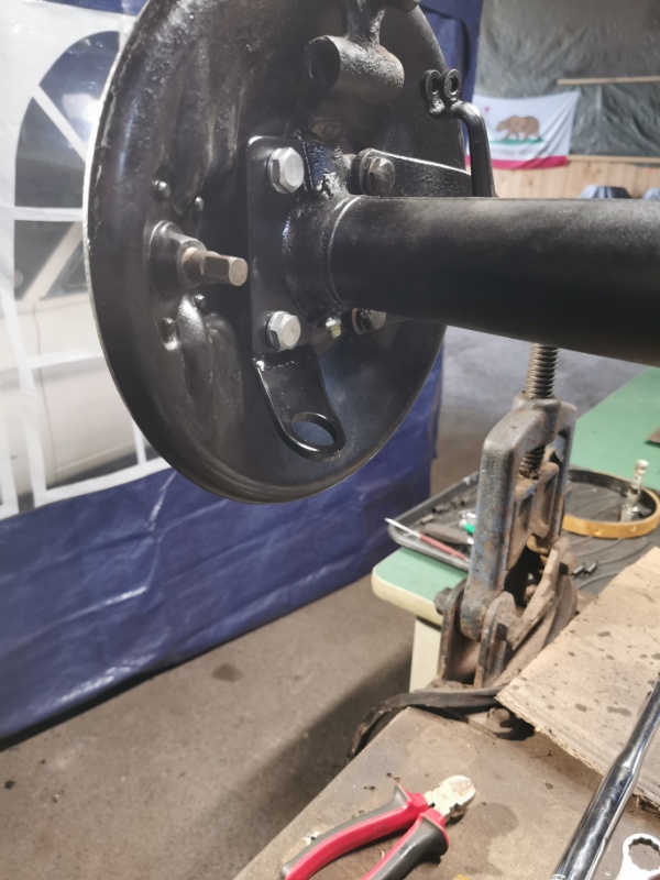

    I removed the left rear brake and cleaned it of old oil/grease,
    then put the Speedy Sleeve on the axle journal, removed the collar so the sleeve would fit further and checked the bearing's running pattern, it looks good and will definitely work.
    Greetings Harald

    I welded on the recessed tracks for the brake pad rollers and reworked them to the correct size
    Drilled out the old brake pads and riveted on the new ones, and that was it.
    Greetings Harald

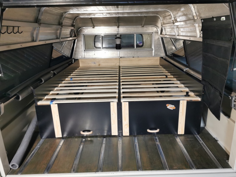

    Before we drove to the motor festival on Rømø in Denmark, I had to modify the bed on the pickup truck, both to make it more comfortable and to give us more storage space. Now that we're back from this fantastic event,.....

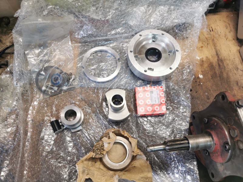

    That's right, the bellhousing is from the AA, the wishbone from the A. I still need to build brackets to install the emergency brake and the pedals.
    To adapt the transmission, an adapter was installed on the transmission output that is connected to the torque tube.
    This is described earlier in my thread.

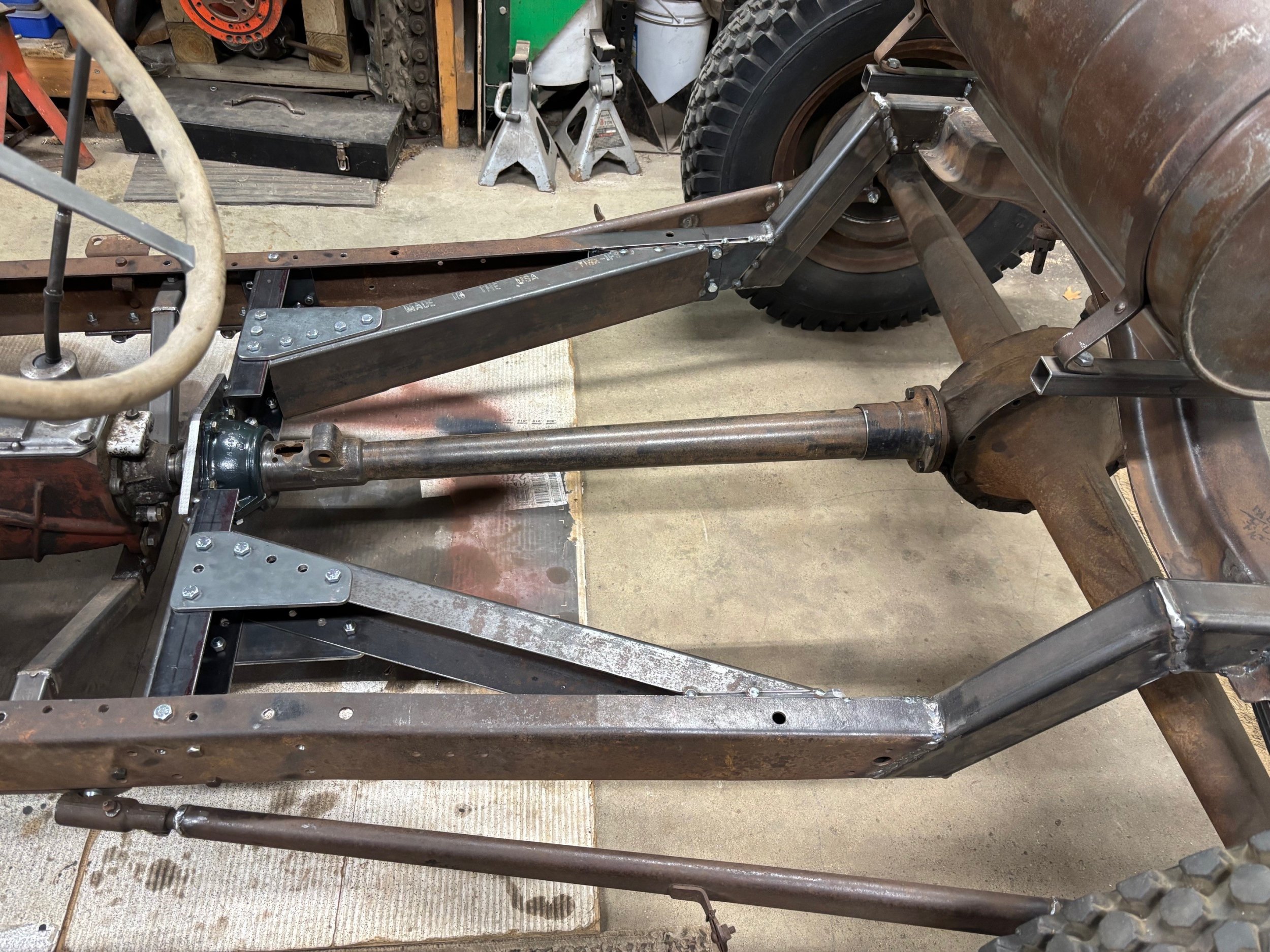

    That's a great looking kit. I went with torque tube on this beater and had me scratching my head on how to make some of the parts a frame 1.jpg volvo 1.jpg

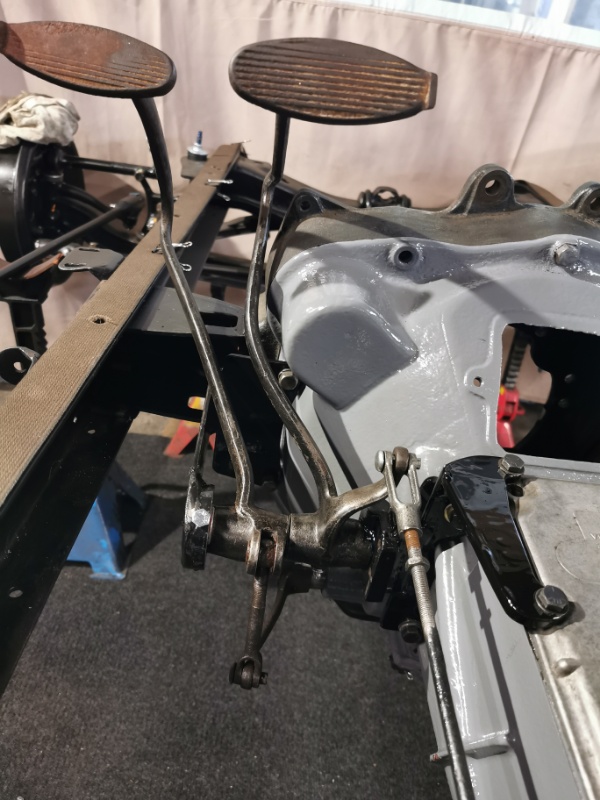

    The rear end is finished, and I moved on to the pedals.
    I got the support at the Airfield Club Race as promised, along with a usable new brake rod. One was about an inch too short, so I couldn't get it to connect to the brake levers—what a surprise.
    Welding the individual parts for the pedal spindle together wasn't difficult, since the support determines the height and depth.
    I did have to bend it a little, as it was a bit warped due to welding. The pedals also got new bushings and grease ******s, and now I just need to adjust the brakes. So far, the frame and the axles are finished. I think I'll be able to put the housing on soon. Best, Harald.
