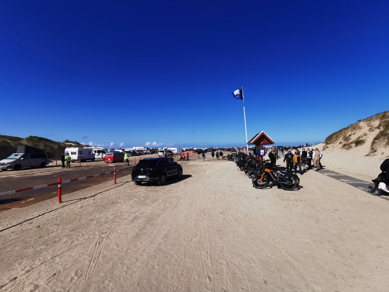

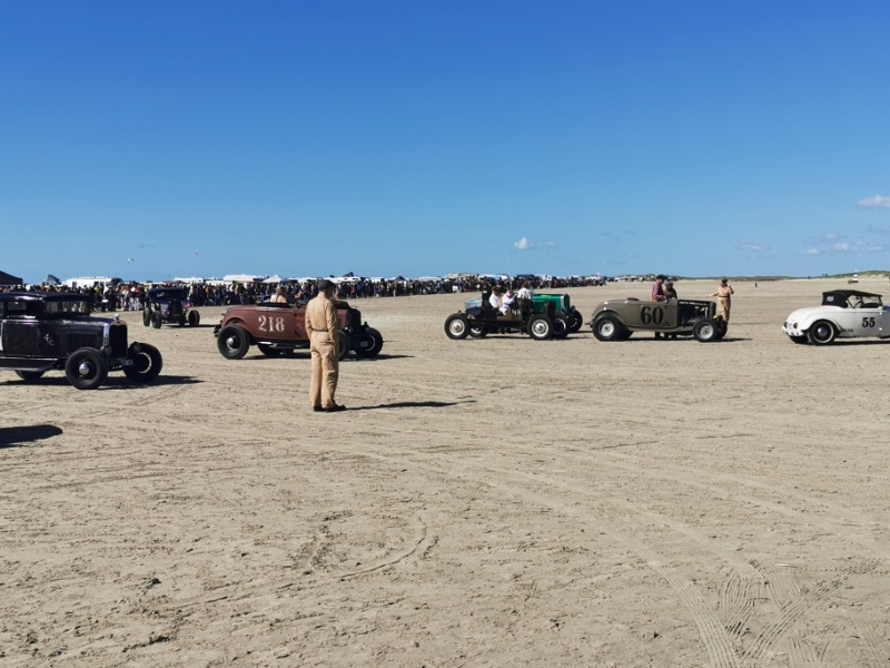

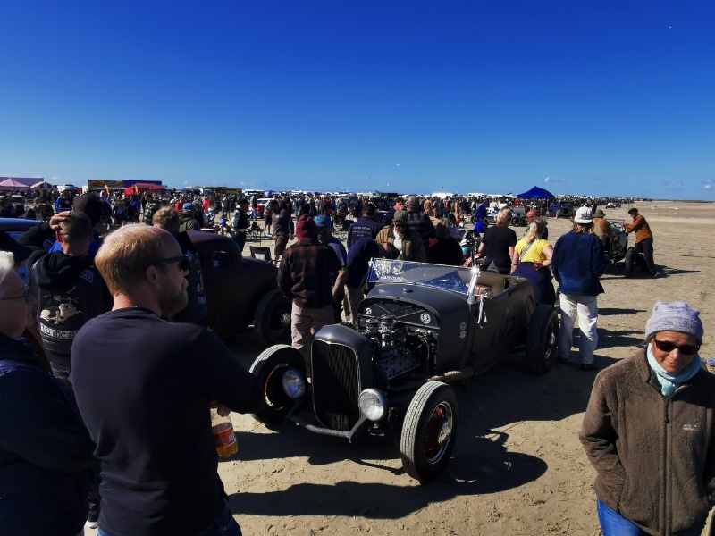

    The event on the island of Rømø is truly a major event.
    Hot rodders come from all over Europe, with an estimated 45,000 visitors over the weekend, although the race only takes place on Saturday.
    It's very well organized.
    One half of the beach is full of campers and caravans. It's amazing.
    It's good that the Danes are so relaxed about it; that would be unthinkable here in Germany.
    I'm happy that something like this exists nearby.
    Here are some pictures:
    The aerial photograph shows the race track on the left, the open field, and the campers on the right of the access road.
    Regards Harald
