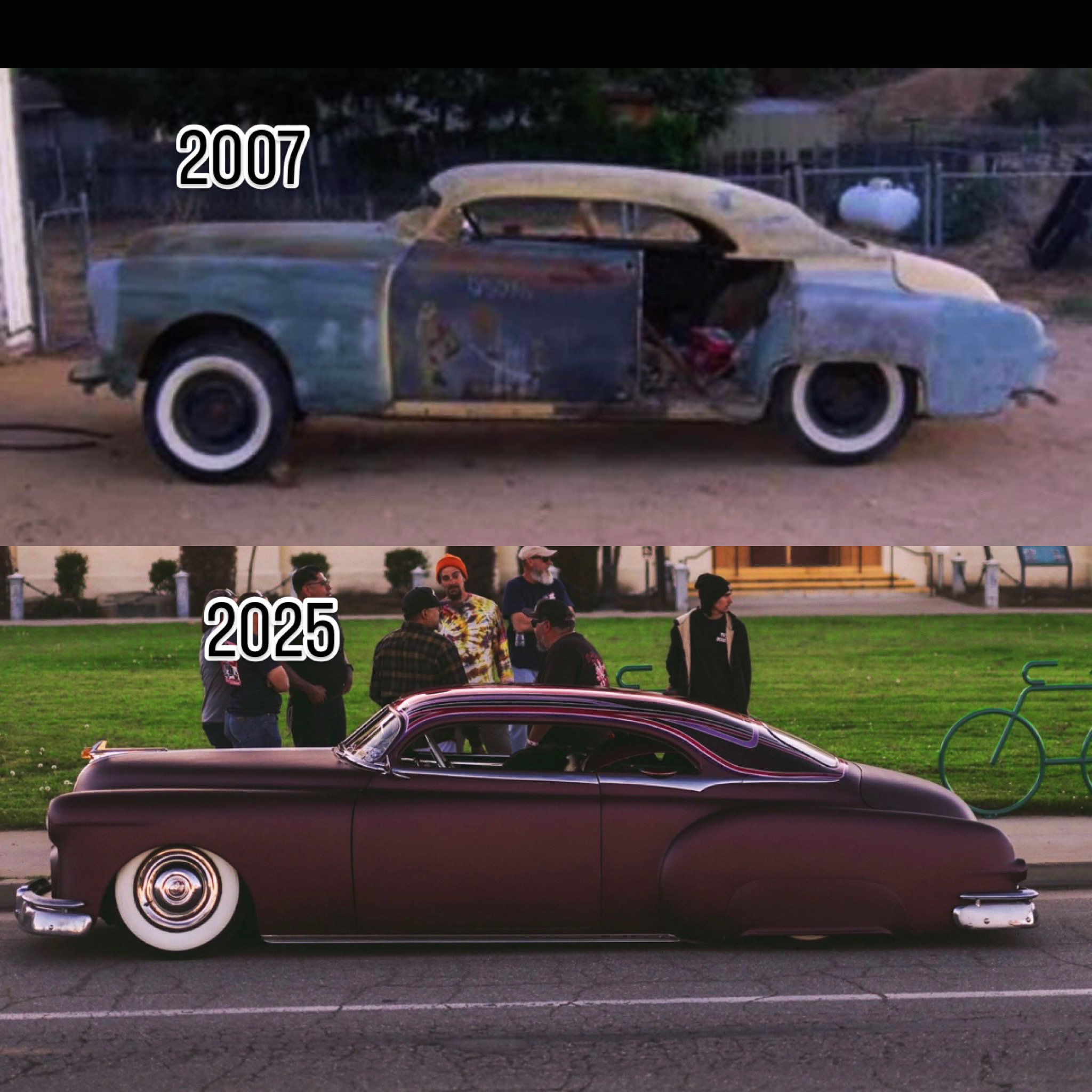

    doors cut and just about ready to be welded in....
    got a nice fit on this side....

    slowly hacking away at it ...not alot to report but i got a beautiful fit on this side and have it all tacked in....wont be long now and i can move on to the next part of the project.

    Looks totally different than when u first got it !!
    Nice Lines , smooth

    not a whole lot of work done latly ...but i did get the p***eger side welded in and ground almost all the way down....still got to do a little grinding on the bottom.
    pics
    photoshop lowered....this is the project i will tackle next.......and the look im going for....

    Awesome! getting rid of the ugly hump in the roof made a huge difference. Love the color and the paint on the roof

    Looks great! Oh hey, I’m in that pic!

    Great to see such a result after a 17 year thread!
