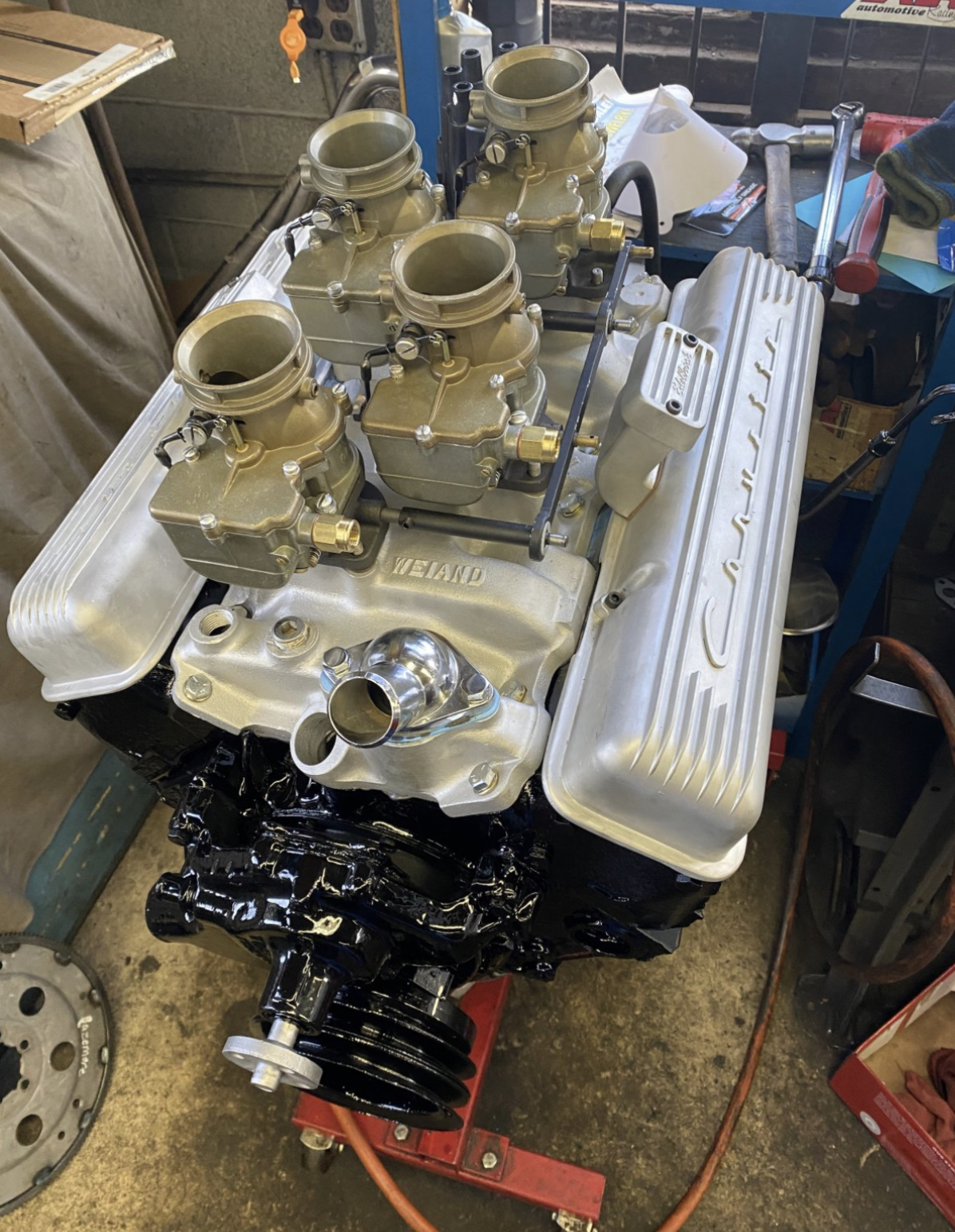

    Deuces and straycat60 like this.
  29. straycat60
    Joined: Sep 25, 2008
    Posts: 133
    straycat60
    Is a great looking setup. What carbs are those? Also where did you get your linkage? I got mine from Charlie price at vintage speed.
    hrm2k likes this.
  30. hrm2k
    Joined: Oct 2, 2007
    Posts: 5,550
    hrm2k
    the carbs are Stromberg 97’s. The linkage was on the unit when I got it from Mark Moriarity. I think he said he made the black part of the linkage quite a while ago
