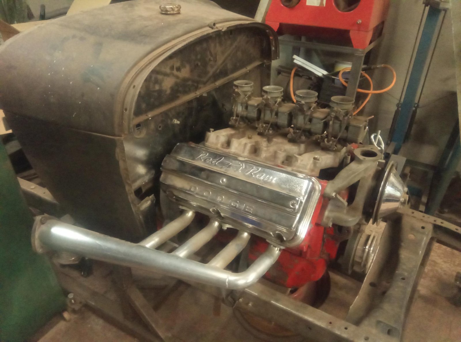

    I have a question about this topic. I’m planning to run weiand 4x2 intake with 97s on my 270 Red Ram hemi. There has been articles about this set up and they recommend to run 2 middle carbs as primary and 2 end ones as progressive. That makes me wonder about fuel distribution, for sure cylinders 1,2,7 and 8 will not have as good fill as middle ones, but with modified better sealing ****erflies in end carbs that might not be big problem. But they also recommend to leave accelerator pumps unhooked in end carbs. That makes me wonder, doesn’t end cylinders run way too lean when you floor the pedal, and they have full air flow but not any fuel cause vacuum is zero. Middle carbs can’t feed them in this situation, can they?
    Do you guys have any experience with this set up? I think it would be better to run all carbs as primary, or at least keep pumps hooked in every carb. What are you thinking? Should I just do as recommended and leave the thinking to wiser men?
    And make clear, I’m not after smooth and low idle or max performance with this set up. It can be little rough, cause it will be a hot rod not grocery getter, and the looks are better than with single 4 barrel intake IMG_20230203_214245_8.jpg .
    Deuces and don colaps like this.
  13. vtwhead
    Joined: Oct 20, 2008
    Posts: 5,316
    vtwhead
    I would send Uncle Max an email at info@97-express.com and see what he would recommend. I would think that running non progressive would be much easier overall.
    big duece likes this.

  15. Lättähattu
    Joined: Oct 29, 2009
    Posts: 144
    Lättähattu
    from Finland
    Thanks for the comments! I will ask Max his opinion, but it seems that you are thinking like me: all carbs in sync and find right sizes jets and powervalves.
