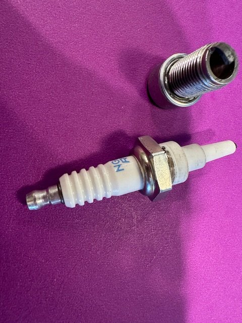

    to read plugs,... if you know how... you look for the fire ring.... the ol.. you want a milk shake color is wrong.... you have to look inside the plug to see if it's lean or fat
    as you can see from this plug, it's way too fat...
  8. ALLDONE
    Joined: May 16, 2023
    Posts: 4,041
    ALLDONE
    next, look at the strap.... needs more timing...
