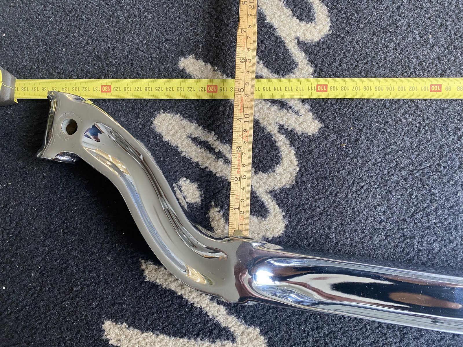

    Is my axle at 5” dropp ? Se picture.

    That axle is about 3.5 or 4” total drop.

    That was my guess to around 4”.

    The amount of drop is the difference between a stock axle (which has some drop) and the dropped axle, not as you show.
