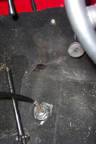

    this is where the old shifter was and where the new one is, also turned the shifter housing around 180 degrees

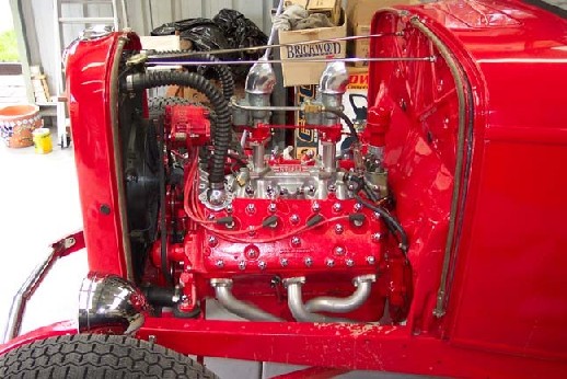

    What a bunch of numbnuts. This has no business on page three without a single reply. That looks great, man. Didn't even have to split the front wishbone to clear the late model trans. - but that's illegal down there anyway, right? Again, nice work - and hey check it out, it looks to be finished with paint and everything! ROAD grime. What motor is in front of that?

    My typing is getting better, so to answer some Q's Flathead 8ba engine, will put photo up. how do you guys shift with the right [​IMG] [​IMG]

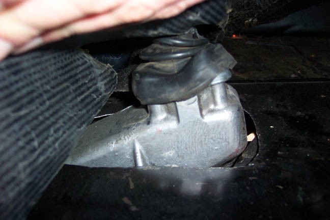

    anyway these below show the box with the shifter in its original position, so picture the shifter housing turned around 180 degrees, so now it sits closer to the firewall and away from the seat. I will also post of pic on the little shifter mechnaism that is inside the housing that needed to be redrilled and heated and bent to suit.
    All in all this was bout a 10 hour job to get it right, but worth it as it makes the car look more original, but with and OD

    heres the shifter selector on the shaft, also the shifter housing had to have a 1/2" plate made to raise it so it wouldnt interfer with the rear locator of the shaft that you can see.

    If you look at the two above photos you can see that the front of the shifter housing is very shallow, that is why a plate had to be made.
    The photo of the selector, is just as it has been drilled and turned around to face the new mounting position ,before is was heated and bent to suit.
    Hope this makes sense???
