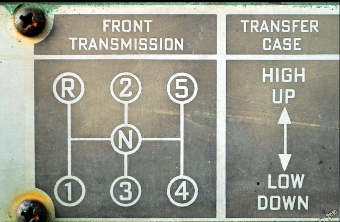

  27. Yeah...just as aggravating as military duece-and-a-half:
    SS327, Boneyard51 and indyjps like this.
  28. SS327
    Joined: Sep 11, 2017
    Posts: 3,617
    SS327
    Got to agree with that! My deuce and a half drove me nuts.
