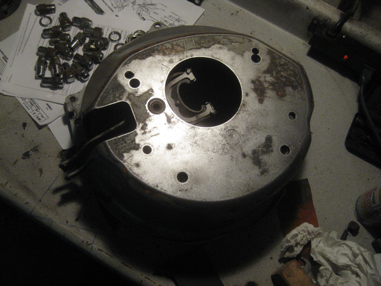

    Used the '60-'62 Chevy hydraulic bellhousing in two of my SBC hot rod builds with the T5. First one had Ansen hanging pedals and my current one used '40 Ford pedals I added an arm and master cylinder bracket to.
    Old pics, the shifter as well as a bunch of other **** is now different but it's bled and working.

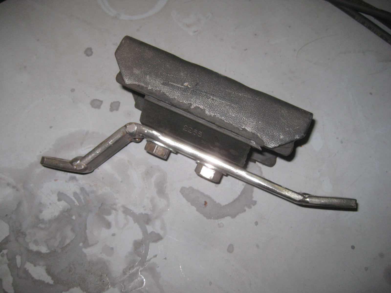

    In my '56 Chevy I used a later Camaro WC unit with the Phord pattern, the input bearing retainer matched a steel ****tershield hole so I just put new holes and welded screw plates into the inside for the Ford mounting pattern.
    I welded on a side plate so I could use the stock tri-five clutch stuff. Didn't want to overly complicate that portion.
    The F-body transmissions are mounted a bit rotated in the mullet-mobiles and I put it back to being straight at the bellhousing mount so I had to make an angled thingamajig for ****** insulator. It seems to be working fine. If I had put an S-10 tailshaft on the ****** it would have been straight and a non-issue.
