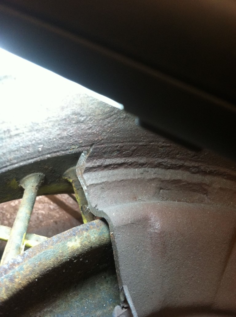

    Without a spacer the drum will interfere with the wheel center regardless of the bolt pattern.

    Lay one of your rear drums on the back side of one of your wire wheels. They won't fit.

    NO way to use the Ford wire wheel WITHOUT a spacer in your application. The bolting surface on the Ford wire wheels are recessed 1 1/8" in the hub of the wheel.

    If you look at how close a wire wheel actually fits over '40 style drum; it's pretty plain to see why the wheel won't fit on a modern flat face 10 or 11 inch drum without a thick spacer. Picture has a cut away '40 drum matched up to a '35 wire wheel.

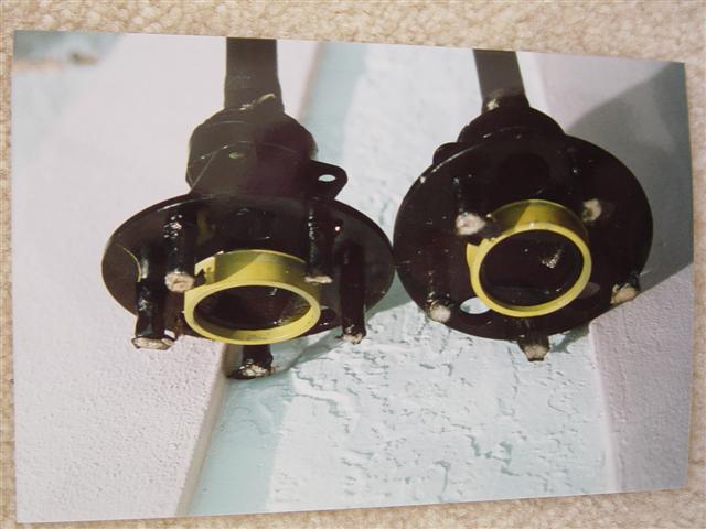

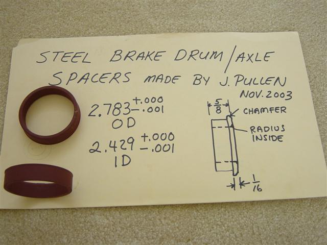

    I am not sure about the spacers needed but, perhaps these may prove helpful for making brake drum "hub centric".
