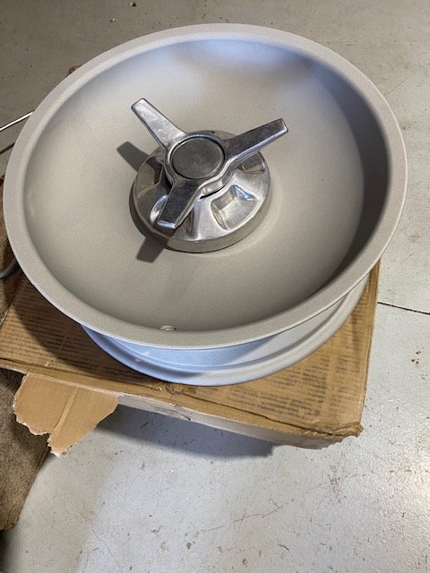

    I bought a couple sets of the 18" solids with the 5 on 5 1/2" bolt pattern. Really a good deal. I think all they had left were 5 on 5. 5FB1F34C-5B5A-401D-9BB7-FECB43EC8C25.jpeg
    panhead_pete likes this.

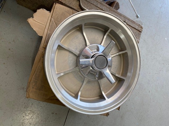

    @ssaza25 Those are the ones I bought too but mine are still in the US. Could you be so kind to flip that wheel over and post a pic of the inside, just interested to see if they could be redrilled for another pattern.

    here you go-they look like the other type of wheels they were selling.- 9F13E097-F079-4C74-9AB9-CC5F82538F56.jpeg 31CBD043-3391-47CE-9309-9F6739D2CC40.jpeg

    Thanks @ssaza25 doesnt look too promising to drill another set of holes.
